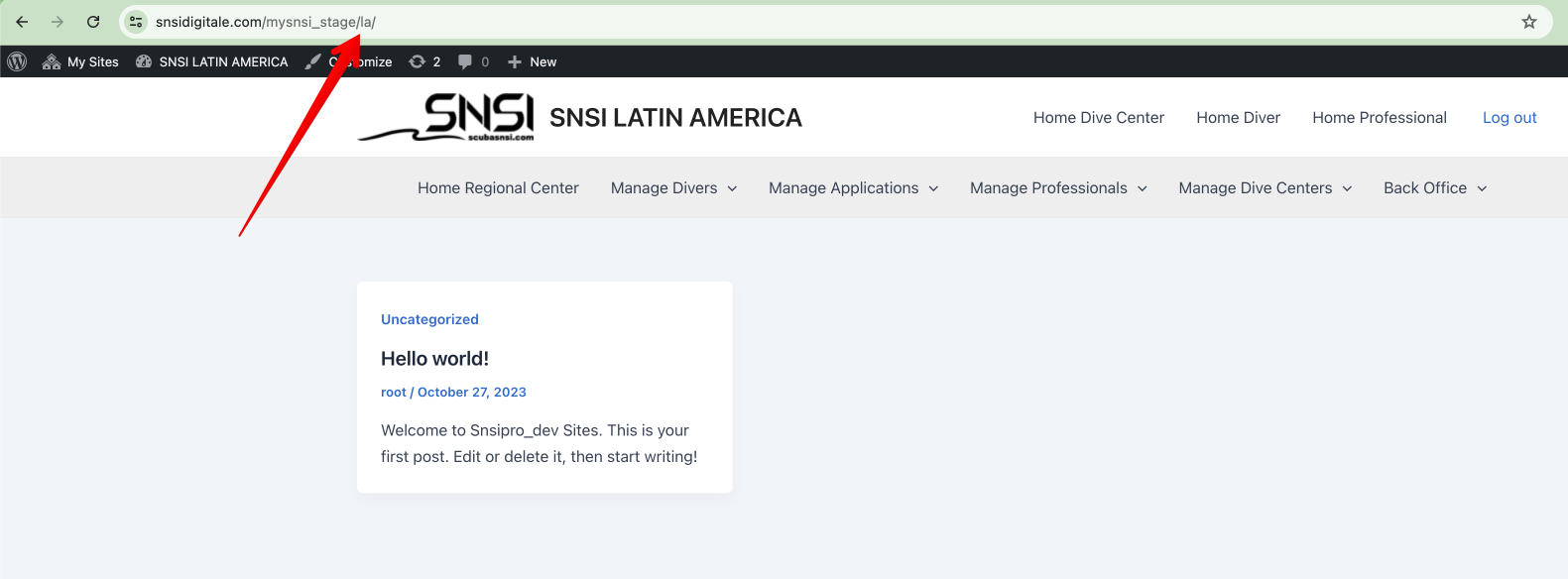

I edit the site in the network area and add the last slash (/) to the site and home URLs then the subsite hidden link is working properly. Can you please confirm it works on your end?
Translation Management ‹ SNSI LATIN AMERICA — WordPress 2024-07-05 10-05-11.jpg
Edit Site: SNSI LATIN AMERICA ‹ Network Admin: Snsipro_dev Sites — WordPress 2024-07-05 10-02-08.png

I see the error once when I visit the admin area of the subsite /la/. There is an error in the debug log:
[03-Jul-2024 11:21:21 UTC] PHP Parse error:  syntax error, unexpected token "<" in /web/htdocs/www.snsidigitale.com/home/mysnsi_stage/wp-content/plugins/sitepress-multilingual-cms/classes/upgrade/commands/AddTranslationManagerCapToAdmin.php on line 10
I review that file and see there is an HTML <br> tag in the file which isn't correct so I try to re-install the plugin WPML. For now, there is another error in the log:
