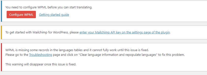

I installed WPML today on our clients website, and ran into this error before trying to configure the plugin on startup. I don't think its a false positive since no languages show up on setup screen. image 1
"WPML is missing some records in the languages tables and it cannot fully work until this issue is fixed.Please go to the Troubleshooting page and click on "Clear language information and repopulate languages" to fix this problem."
I've tried everything suggested. Rest, Delete, Reinstall, Check with default theme... I've also increased memory limit from 40 to 256MB. But nothing is working.

I have checked and it seems there are some restrictions for your DB user, that is added to the WP config, that is why WPML can not create or reset tables, so the issue is stuck there.
I advise checking with hosting to make sure your DB user has all the needed privileges, then you can run WPML Reset from troubleshooting or manually delete all wp_icl tables, and enable and configure WPML.

you should tell them that you have a plugin that is trying to remove its table / reset them as part of the reset function and is not able to due to DB user privileges. The same thing happens if you try to delete tables manually from your PHPmyadmin, so not related to WPML itself.
After that you can continue to delete them manually or reset WPML.

Thanks, Hosting made the privileges change and it all worked like a charm!
