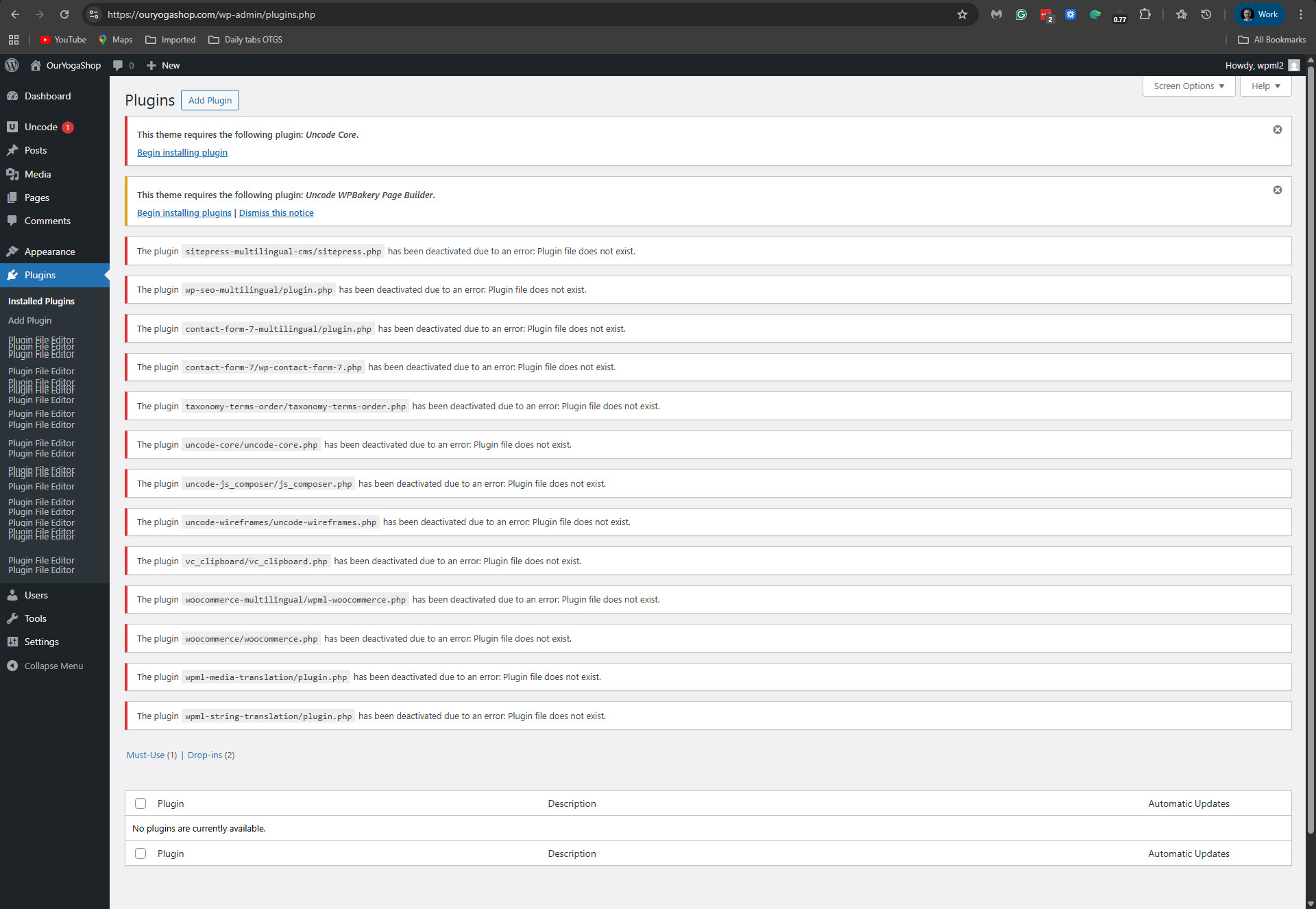

I accessed your site and found it without any plugins installed. Please see the attached screenshot. It seems you deleted the entire contents of the /wp-content/plugins/ folder. Naturaly in this situation, I cannot investigate the performance issue. Please restore your site to its normal state and let me know when it is done.
Thanks,
Itamar.
February 8, 2026 at 6:05 pm #17803299
fredrikS-7
It was just renamed to plugins-hold.
I renamed it back to just plugins.
Now you can see everything again.
February 8, 2026 at 6:06 pm #17803302
fredrikS-7
It was because the site was loading so slow and I had to go for a while. Still had to give you credentials so you could work. Just missed to rename it. - Sorry.

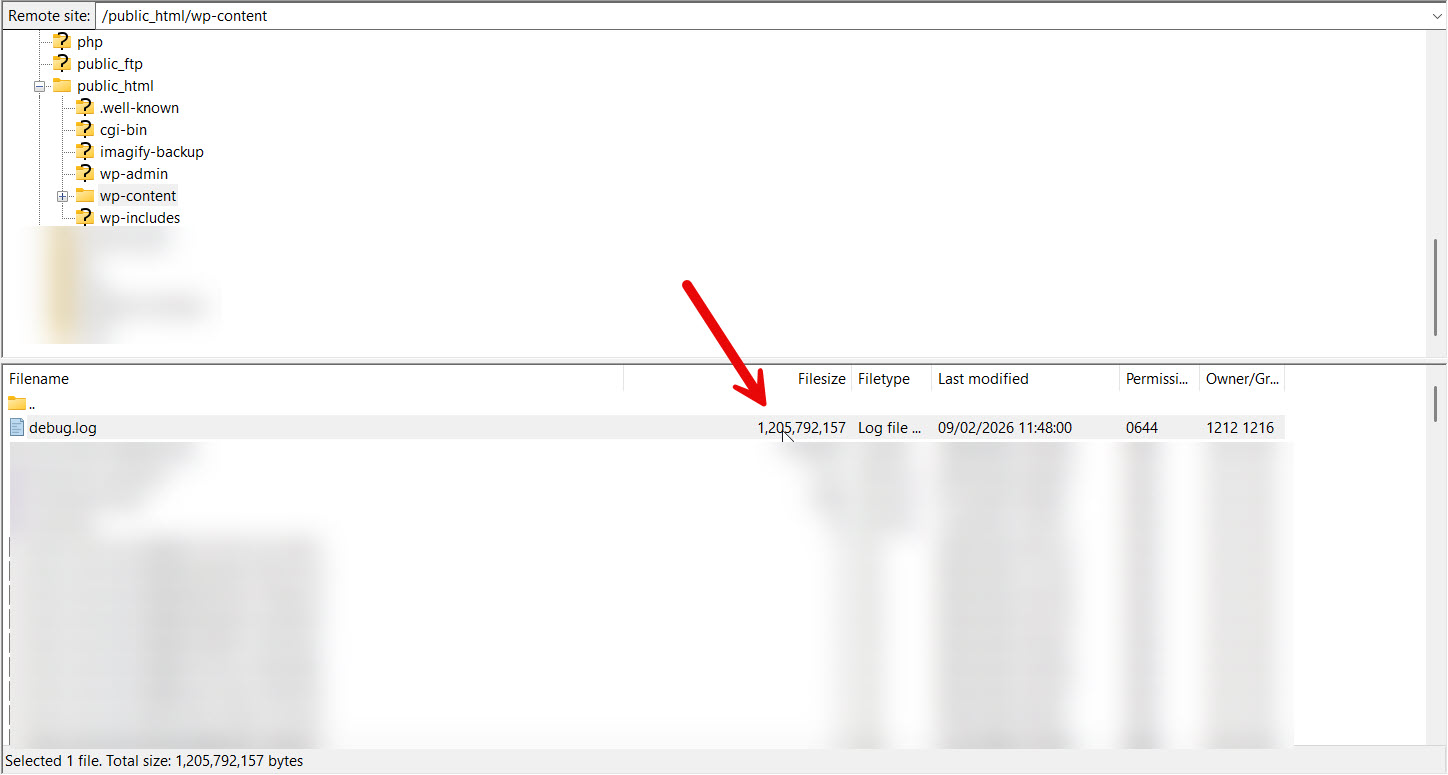

When I accessed your site now, I noticed that WPML and its add-ons are inactive. Nevertheless the site still loads slow. The frontend and backend loaded in around 20 seconds. I believe there is another cause of the performance problem on your site, besides WPML. I assume that when WPML is active, the site loads even more slowly. But this would be the case when activating any other plugin. I connected to your site with FTP to check the debug.log file in the /wp-content/ folder. And I discovered it is huge. Its size is 1.14 gigabyte and my code editor can't open it. Please see the attached screenshot. I assume that the errors in the debug.log file could tell us a lot about the performance issue. Therefore, please approve the following.
A. Allow me to delete the debug.log, so WordPress will create a new file which I can work with.
B. Allow me to deactivate plugins and switch the theme to a default WordPress theme.
Do you allow me to proceed with this?
Itamar.
February 11, 2026 at 8:49 am #17811750
fredrikS-7
Yes please, just go ahead.
