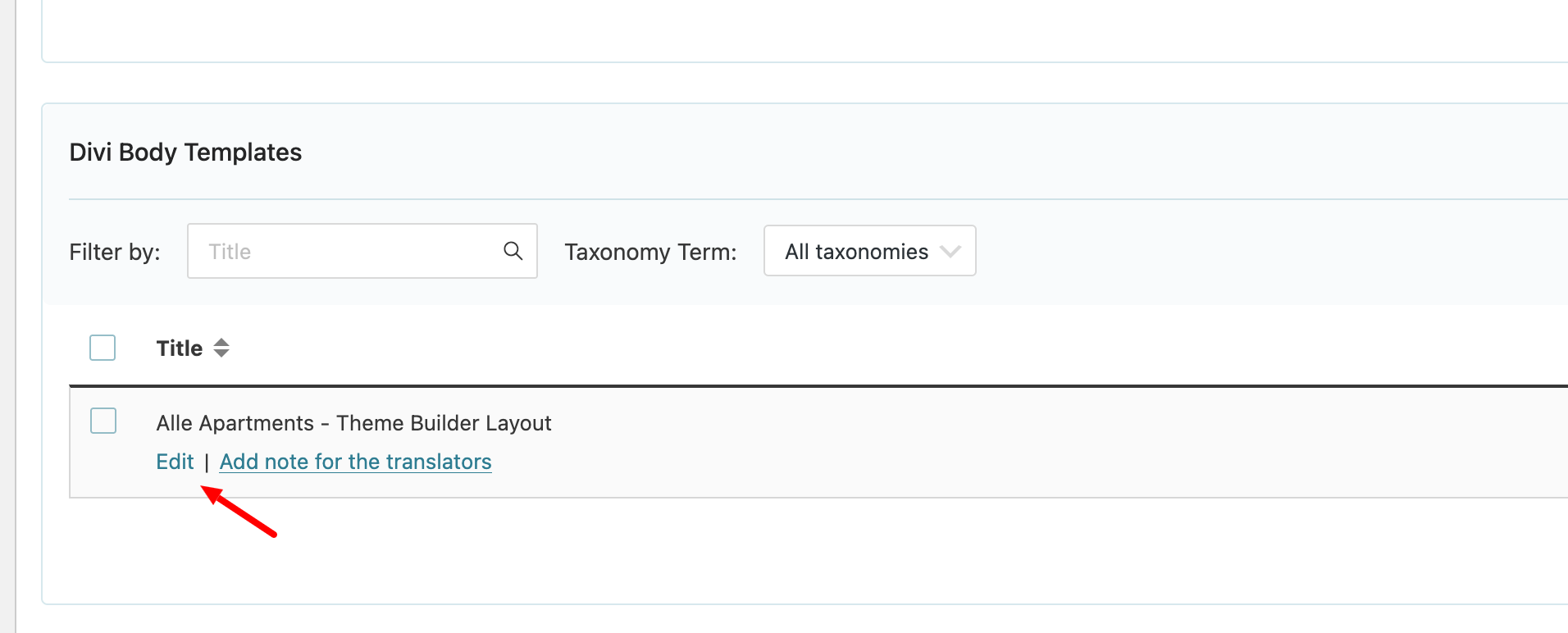

April 10, 2026 at 2:07 pm #17962341
Andrey
WPML Supporter since 06/2013
Thank you for sharing the details.
You can access it via WPML → Translation Dashboard and try to initiate the translation from there.
I’ve attached screenshots for your reference.
Edit-Body-Template-“Alle-Apartments-–-Theme-Builder-Layout”-‹-Mikes-Apartments-München-—-WordPress.png
April 13, 2026 at 3:08 pm #17966602
luisS-25
Thank you your description worked for me.
