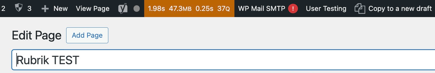

For the test, I activated all plugins except WPML.
With WPML Multilingual CMS disabled:
Page loading time is 1.98 sec, size is 47.3 MB, 37 queries.

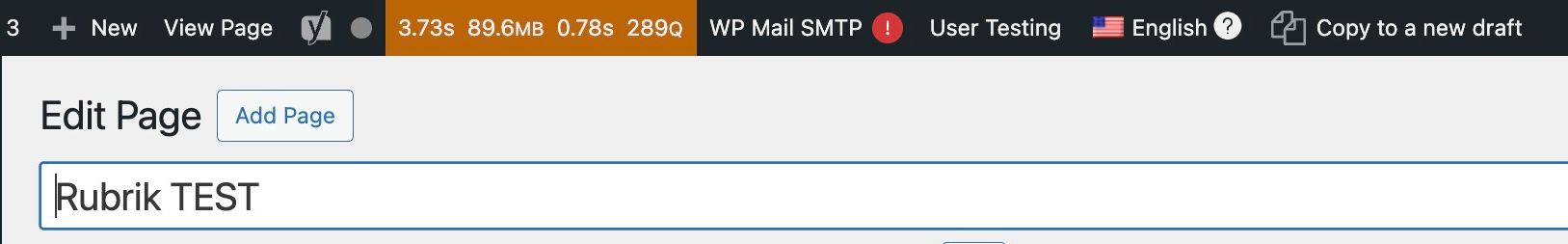

After enabling only the WPML Multilingual CMS plugin, I firstly received the error - "The application did not respond in time". Secondly, a significant increase in time, size and number of queries:
Page loading time is 3.73 sec, size is 89.6 MB, 289 queries.
Thus, after activating the plugin:
Loading time increased by approximately 88.38%.
Size increased by approximately 89.43%.
Number of queries increased by approximately 681.08%.
I would like to draw your attention to the fact that this page has no translations.
