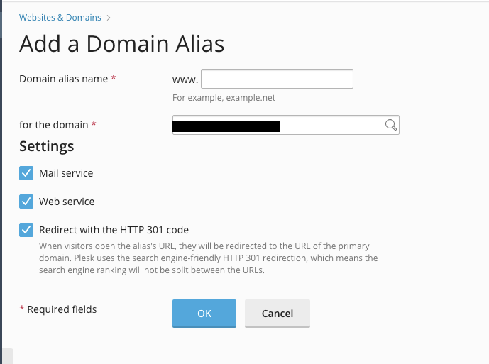

Sorry, as usual I pressed send to quick...and then started reading in more detail what you had written. One thing to note is that the provider is making use of PLESK. On Plesk there is an option Add domain Alias, which comes pretty close to what you describe. Is this what needs to be done? But then only the web service forward.
I haven't tried this yet, because I am concerned about the search engine issues.

February 13, 2024 at 7:31 pm #15299322
Bobby
WPML Supporter since 04/2015
I don't believe it should, but please do update me with their feedback as that will give us more insight, and we can proceed from there.
February 14, 2024 at 11:09 am #15301582
christineF-11
Can you check my other message time 7.30 PM, please? I’m curious if the solution is in that message or if not why not.
February 14, 2024 at 9:45 pm #15304462
Bobby
Ah, looks like I send my reply right around the same time and missed that information.
Yes, a parked domain would also be a Domain Alias, that should work. Please try and let me know your results.
February 18, 2024 at 3:04 pm #15315057
christineF-11
Hi, I was travelling for a few days and could not reply.
I had contacted the provider last week. During the call they have removed the FRAME FORWARD.
Then based on the information from namecheap where is stated:
4. In the Domain text box, enter the domain name to add as an alias and ensure that the "Share document root (/home/username/public_html) with “domain.tld”." option is selected.
They have pointed the domain magiclovecompany.com to the same folder as the original language domain.
However as you can probably can see when you type in the URL the domain is still redirecting.
I'm waiting now for the provider to see if they know what to do next. If you have any suggestion, please let me know.

February 23, 2024 at 1:26 pm #15337954
christineF-11
Hi Bobby,
It is solved now.
I have followed exactly what is in the youtube video: hidden link
I did not make any changes to the DNS settings. Only have the root folder to be the same as for the original language.
In WPMP I setup the second language in a different domain, as is also shown in the video.
I created a translated home page.
Next I cleared all my browser cache and webserver cache.
And then it worked.
So for others who are not making use of namecheap, but have another provider, the statement that you need to have a parked domain (alias) means that both domains need to point to the same wordpress installation.
