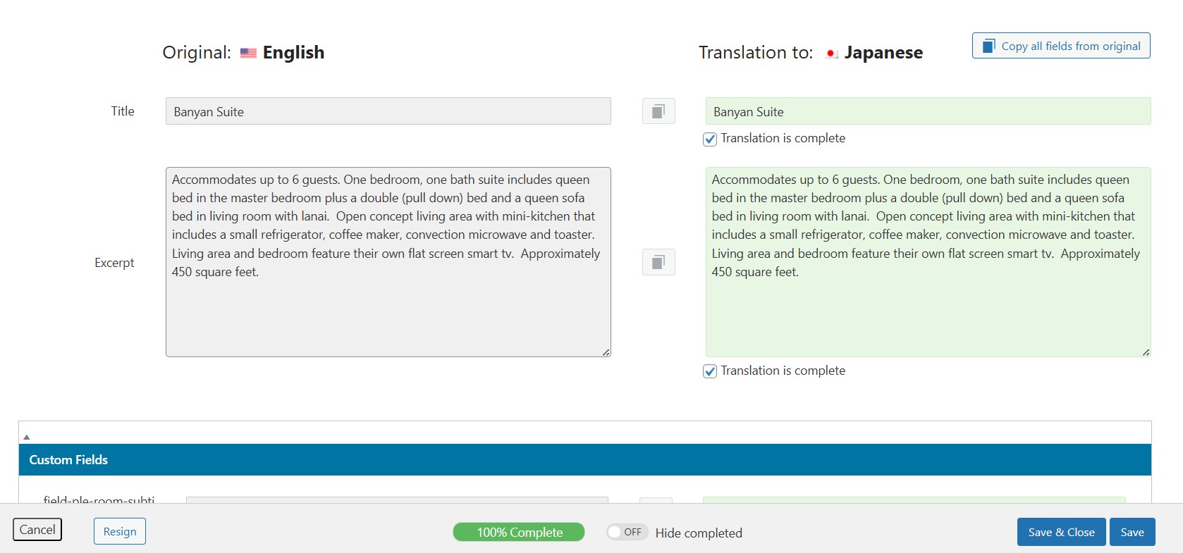

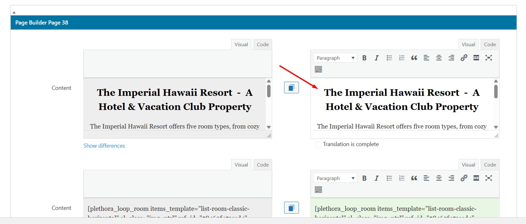

Thanks for providing the login details. I followed these steps:
1. Opened the Rooms page in edit mode (EN).
2. Clicked the secondary language icon to open the translation in WPML Translation Editor.
3. I can see that the English content is currently being used in the translated fields (please check the attached screenshot).
4. Could you please open the translation from the following link, add the correct translated content, and click Save & Close, then check if the issue is resolved?
5. Please do the same for the Rooms post below and confirm the result:
Kindly let me know how it goes.
Thank you

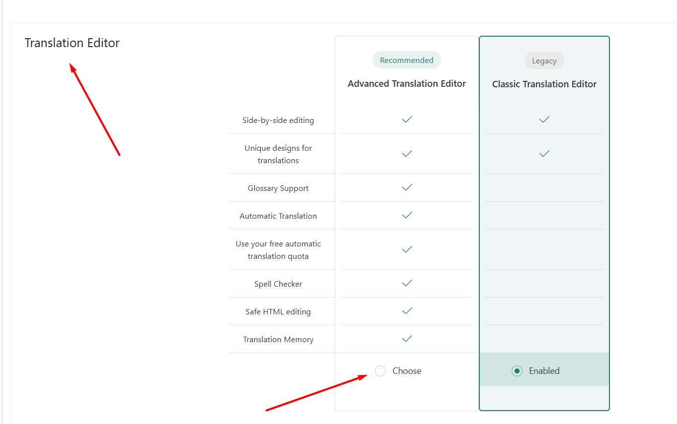

February 22, 2026 at 9:47 am #17840764
Noman
Sorry for the delay, I was off during the weekend (Friday-Saturday). At the moment, the WPML Classic Translation Editor is enabled (WPML >> Settings > Translation Editor). With this editor, you need to manually add the Japanese translation in the fields on the right-hand side and then click Save & Close.
If you would like automatic translation:
1. Go to WPML >> Settings and switch the Translation Editor to Advanced Translation Editor (ATE).
2. Then go to WPML >> Translation Dashboard, select the pages, and send them for translation. Here is a doc for more details: https://wpml.org/documentation/translating-your-contents/#how-to-use-translation-dashboard
3. You can either translate selected pages or enable the “Translate Everything Automatically” option. Here is a doc for more details: https://wpml.org/documentation/automatic-translation/translate-everything-automatically/
Thank you

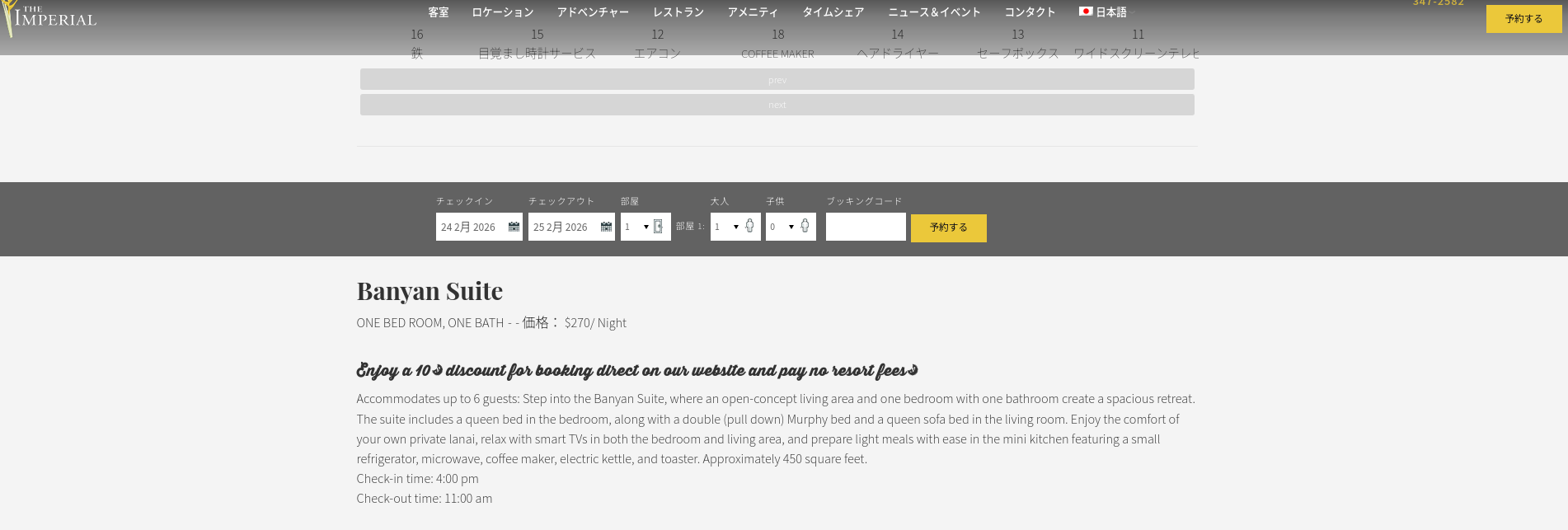

February 22, 2026 at 1:22 pm #17840977
casparD-4
below two url the text for Banyan Suite still is coming in english though I have followed the steps as suggested by you

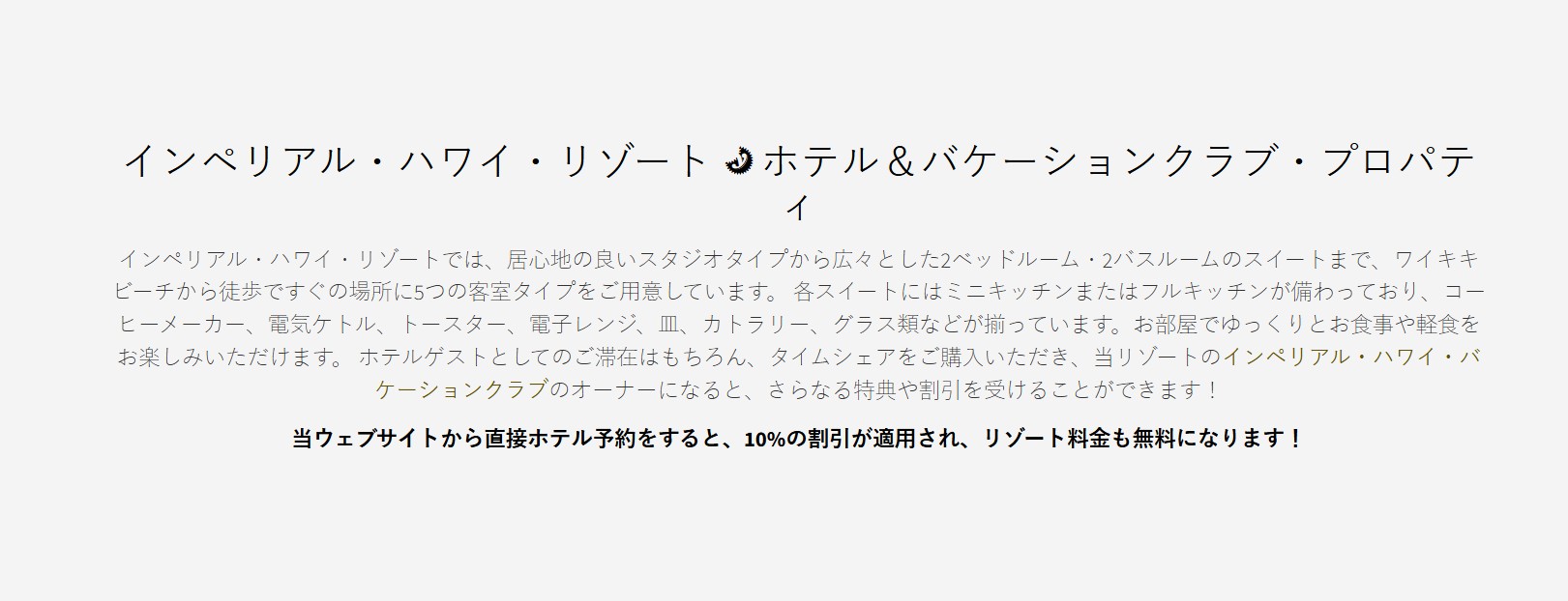

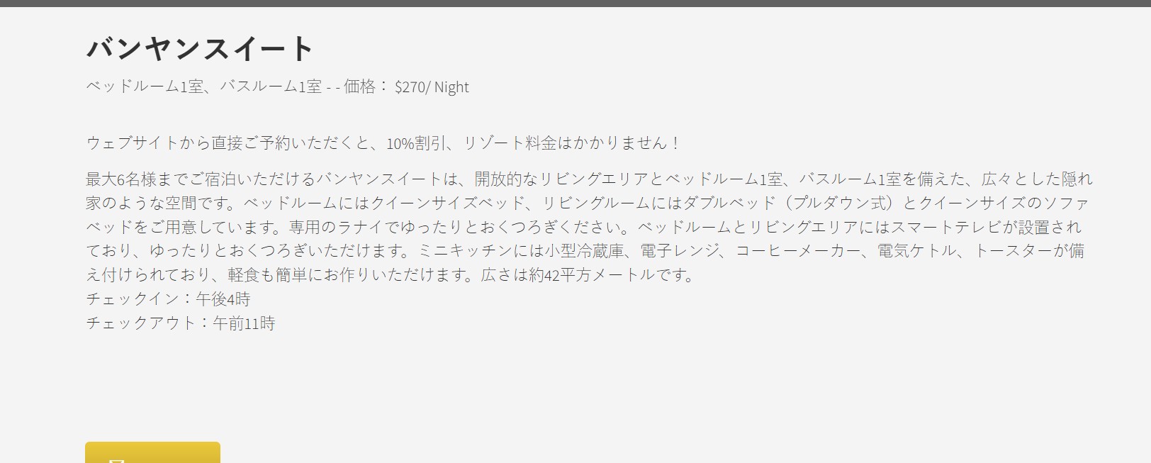

February 23, 2026 at 8:10 pm #17844323
Noman
I followed the below steps:
1. Enabled the Advanced Translation Editor from WPML >> Settings.
2. Opened the default language page in edit mode.
3. Made a small change in the page title to reload the translation.
4. Opened the translated page in WPML Advanced Translation Editor, completed the translation as 100% complete, pressed the complete translation button and now it shows the correct translation at frontend (screenshot attached).
Could you please check and confirm?

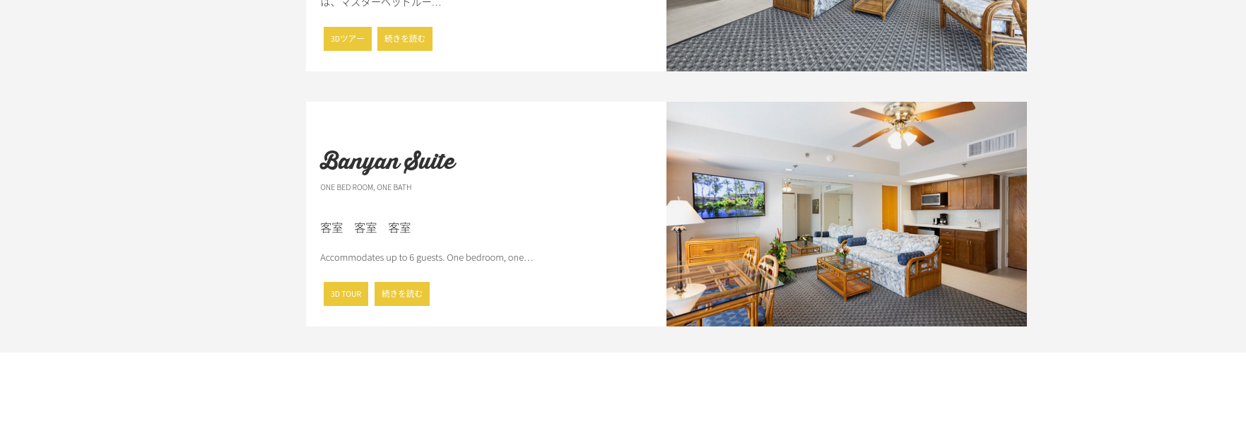

February 24, 2026 at 6:49 am #17844803
casparD-4
Dear Noman,
Its still not working for me , the steps are
1) Opened the url in incognito window
2) changed the language from english to jap
3) Clicked on Rooms from top
4) The room list showing it in english and the room details also in english
Screenshots are attached

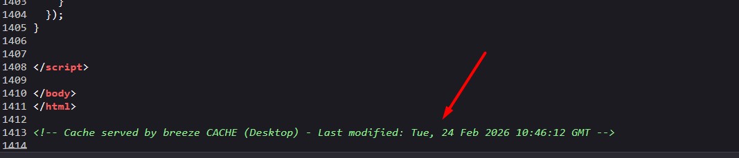

February 24, 2026 at 10:52 am #17845974
Noman

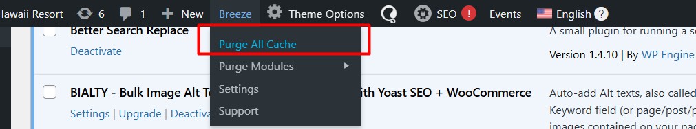

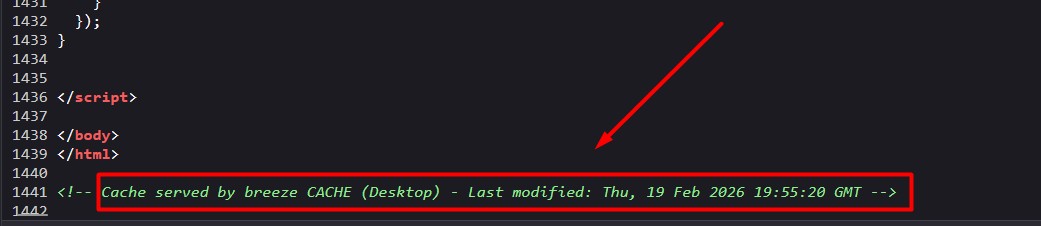

Sorry for the confusion earlier. The issue was caused by a cached version of the page being served to visitors.
I activated the Breeze cache plugin and cleared the cache. After that, the Japanese translation is now displayed correctly on the Rooms listing and details pages.
Could you please check again in an incognito window and confirm?
Thank you

February 28, 2026 at 8:28 pm #17862181
Noman
Hi Vishal,
At the moment, we provide support via chat/forum only. I’ll be happy to continue assisting you here.
I checked the Rooms page again and noticed the translation was saved previously using the Classic Translation Editor, which caused the English content to appear on the Japanese page.
To fix this, I:
1. Enabled “Use also for old translations created with the classic editor” in WPML >> Settings > Translation Editor.
2. Opened the original Room page and edited the Japanese translation in the Advanced Translation Editor.
3. Clicked Save & Complete to resave the translation properly.
After this, the Japanese pages are now displaying correctly on the frontend (also verified in an incognito window).
