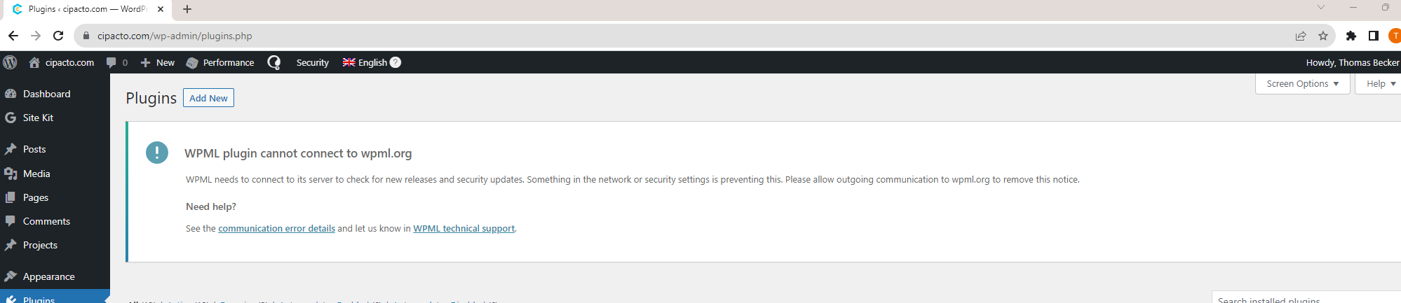

I was trying to update today and received the error message stated above.
The errors seems to have started - without me noticing - some time ago on:
hidden link -Error message
"Installer cannot contact our updates server to get information about the available products and check for new versions. If you are seeing this message for the first time, you can ignore it, as it may be a temporary communication problem. If the problem persists and your WordPress admin is slowing down, you can disable automated version checks. Add the following line to your wp-config.php file:
define("OTGS_DISABLE_AUTO_UPDATES", true);"
This seems to be a temporary, recurring issue, which briefly afterwards seems to resolved.
However, since 8 October I see only error messages (see attached image)

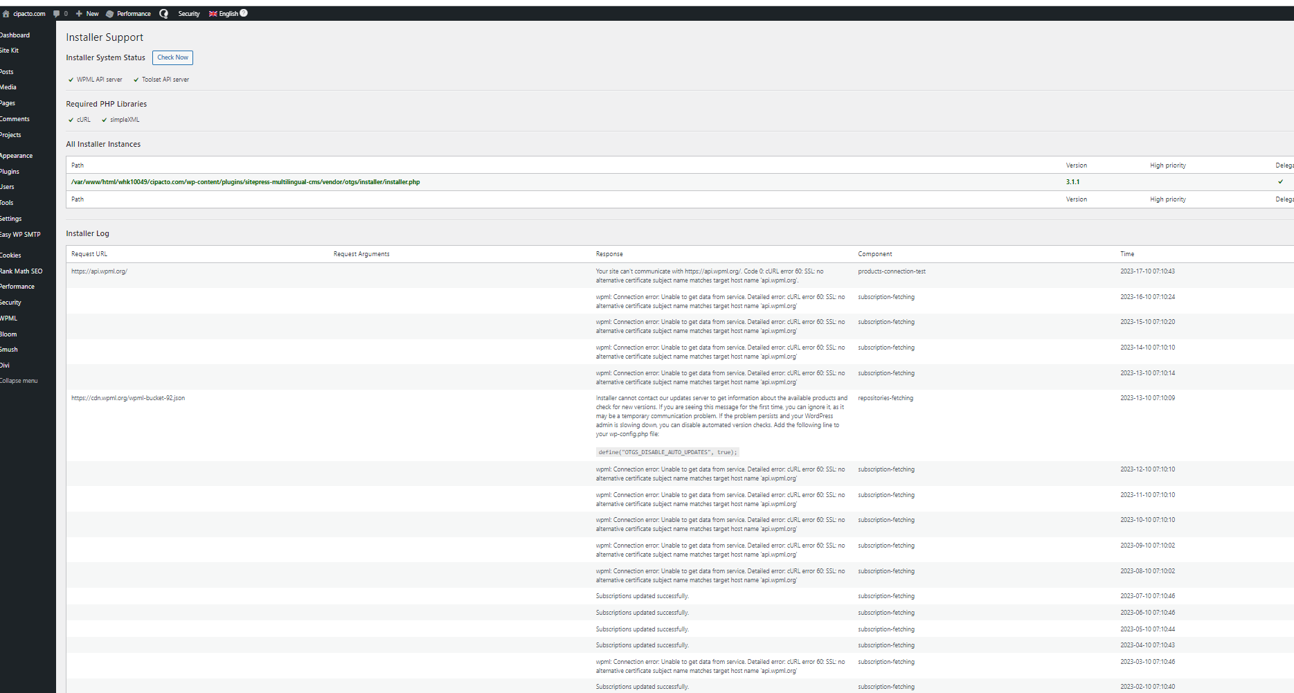

Can you check this?
https://wpml.org/faq/wpml-plugin-cannot-connect-to-wpml-org/#how-do-i-check-the-installer-support-log-for-errors
Perhaps you need to open these URLs, as they may be blocked by your firewall.
But apart from that, can you also check with your hosting company if they have some ideas related to this curl error 60?
As it may be something in these lines:
https://stackoverflow.com/a/34883260

Your Link: That is the screenshot that I attached in my request above. So, yes I have checked.
Concerning your other suggestions: I have contacted my administrator / provider, expect an answer until tomorrow

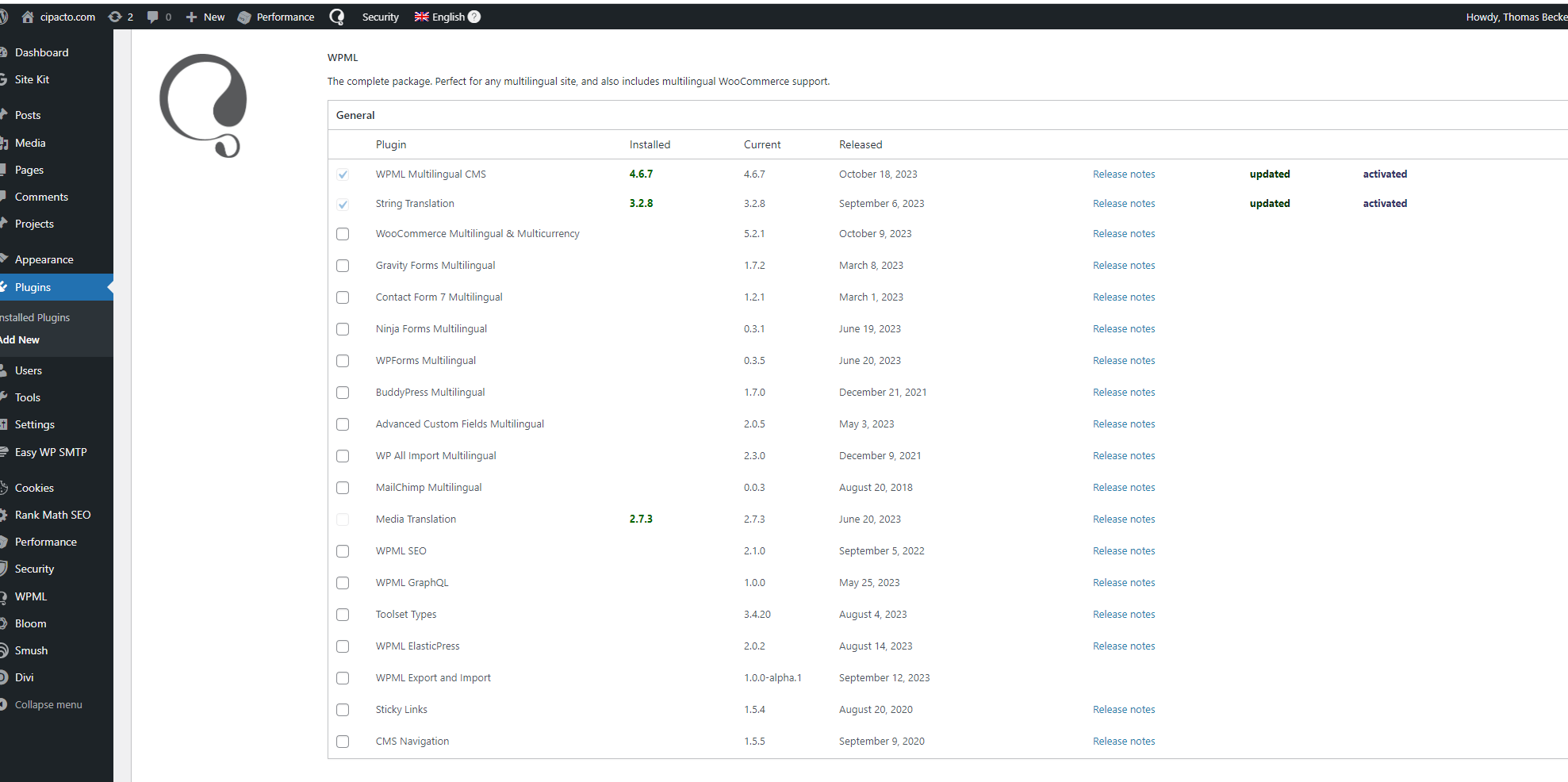

I have just been able to at least register again with my key and update WPML multilingual site, string tzranslations and media translation (attached screenshot).
However, there still is the warning that the WPML plug cannot connect to your website.(attached, too)

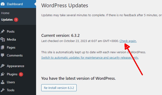

If you click this, is the error away? If not, what do you see in the installer?
October 23, 2023 at 9:25 am #14635013
thomasB-139
Hello Bruno,
the error messages do not show anymore. With "installer" I understand you mena the "plugins" overview page? - no more alert here.
