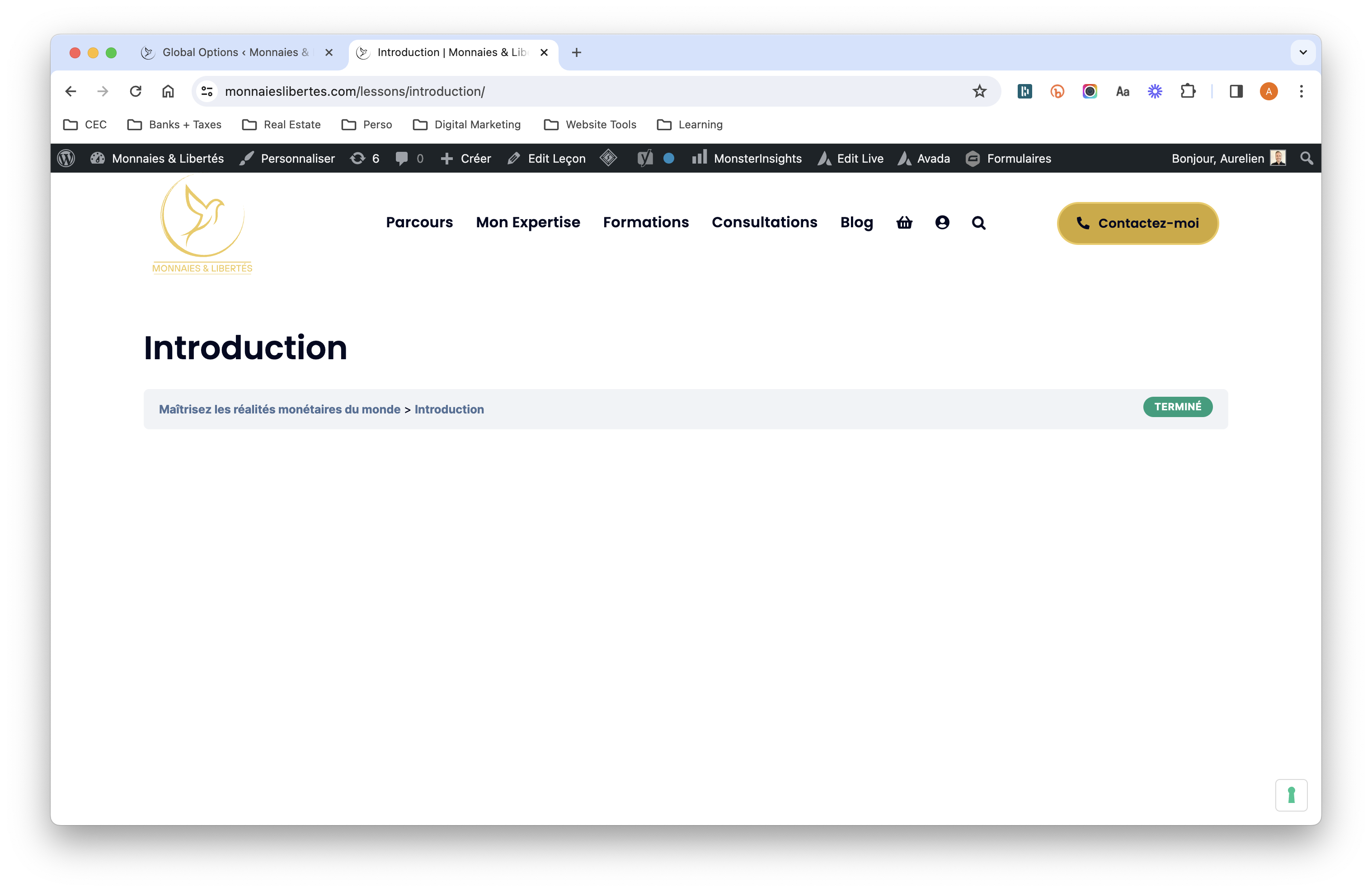

aurelienJ-2
I've received a reply from your2nd tier support:
"Please try to go to admin area > Avada > Options > Advanced > Switch to French language (or All languages) with the language switcher at the topbar > Enable option "Vimeo API Scripts" > Save and recheck this issue."
I've tried it and I still can't see the Vimeo videos when I go to the lessons.
Please let me know what other options we have.
Thank you,

I can replicate the issue with the incognito mode after rejecting the cookie notice on your site. Even after deactivating WPML and rejecting the cookie, the issue persists. So it isn't an issue with WPML in this case.
On your end, you can try some steps below and let me know how it goes:
1. Delete all browser cookies and data.
2. Visit the site again.
3. Accept the cookie and view the lesson.
Look forward to your reply.
December 19, 2023 at 2:11 pm #15093711
aurelienJ-2
That works and it's weird that it depended on accepting the privacy policy for it to work... we'll need to find out what's going on.
