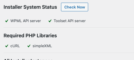

mircoP-6
Hi Andrey
Thank you for getting back to me so quickly.
cURL is installed and confirmed by WPML installer support (see attached image).
PHP memory is at the max the hosting allows without manually overwriting it (128M).
The browser console shows no errors.

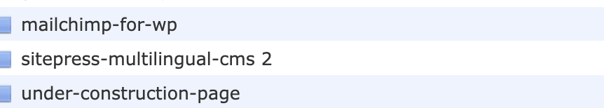

I appreciate your patience.
Good news! I’ve investigated this further and identified the cause of the issue.
In your plugins directory, the WPML plugin folder was named sitepress-multilingual-cms 2 instead of the expected sitepress-multilingual-cms. This non-standard folder name was causing the WPML setup wizard to break.
I’ve renamed the folder back to sitepress-multilingual-cms, and after that, the wizard started working correctly, and the issue was resolved.
I’ve attached screenshots for your reference.
