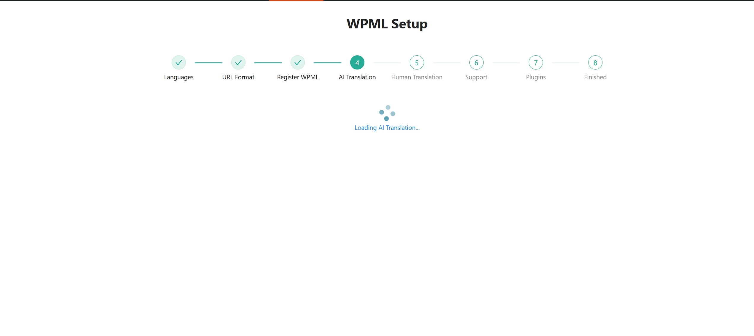

September 24, 2025 at 11:57 am #17429028
justinasG
I am trying to install the WPML plugin, but it gets stuck on the 4th step, which involves the AI translator.
The setup process is stuck on step 4, AI Translation loading, and I am unable to proceed.
Why is the WPML setup stuck on step 4?
How can I resolve the issue with the AI translator during setup?
