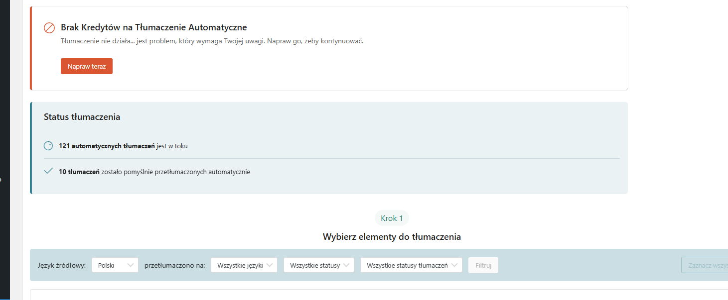

HI Otto,
Thank you for assigning the credits to my site rebelskin.pl—the automatic translation started right away.
Unfortunately, after translating only 10 products I received the same message: “Out of credits.” (see screenshot 1).
Each product contains roughly 350 words (screenshot 2), so the total word-count should not have exhausted the available credits. I have used WPML for other clients and have never experienced this, even on much larger sites with fewer credits.
I would like to switch to the pay-as-you-go model, but only if I can monitor exactly how many credits are being used. Is there a log or report I can review? It looks as though an error may be consuming credits incorrectly.

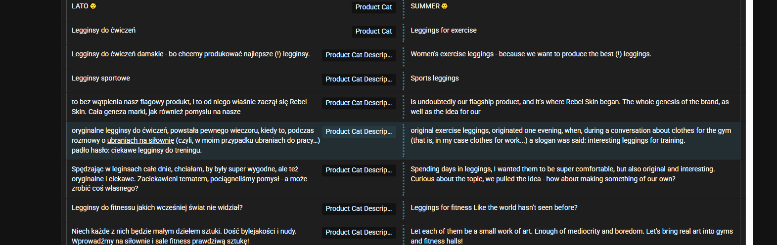

June 10, 2025 at 7:28 am #17120458
nataliaR-10
Hi Otto,
Ok, I think this must be the issue – we have a very long product category description.
But I believe the problem is that WPML translated the product category more than once, and I don’t think it should have.
Look at the screenshot I provided. The category "sports leggings" and the product description appear translated in a different product. So I think the system translated the entire product category within every product. Can you check it out, please?
June 10, 2025 at 1:28 pm #17122013
Otto
The fact that the translation appears in the editor does not mean that it consumed credits. If that segment was already translated somewhere else, it will appear, but it won't cost you anything.
I think everything worked as expected because I can see a few products that costed a lot (probably the ones that include taxonomies for the first time) and others that cost what you expected related to the content of the product itself.
