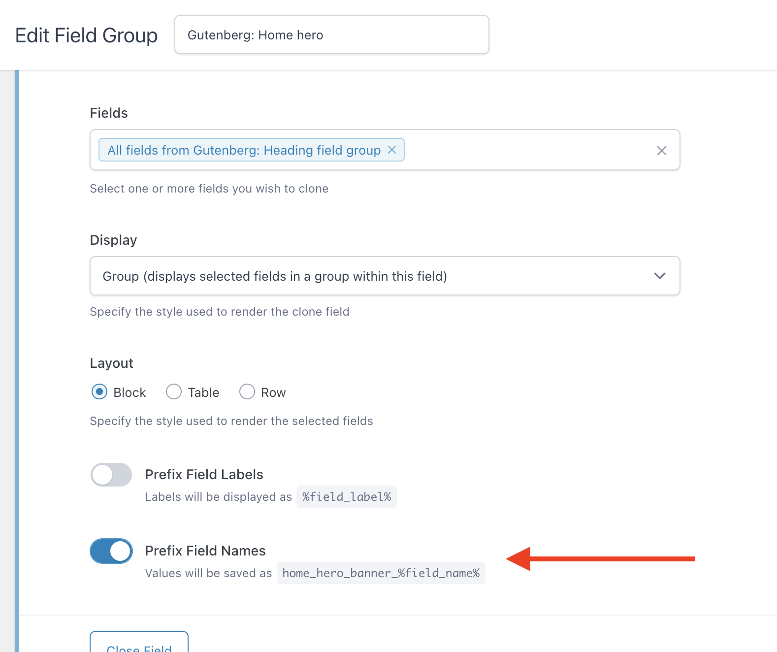

Our second-tier supporter has found the source of this problem and escalated it to our developers. He explained that the problem is with the prefix of the field name. Please see the attached screenshot. As a workaround, unless it is essential and you cannot, please remove this prefix setting, and it should resolve the problem.
When we have news from our developers about this case, we will update you here.

Yes, however, please know that our developer considers disabling "Prefix Field Names" in the Clone field as a valid workaround. He added that this is the default state. We will publish an errata page about it. To set expectations, I must mention that there will probably not be a permanent fix for this until this weekend. Furthermore, our developers will evaluate the priority of this case, so I can't promise it will be fixed soon.

It could be due to the Prefix Field Names option. If it is checked, then it is the same issue. If you believe it's a different issue, please let me know.
