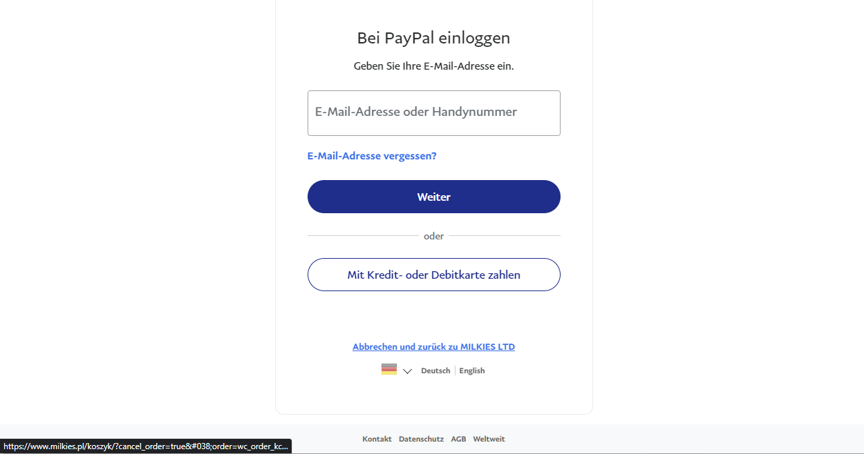

I'm sending an update to the ticket - I don't know exactly what is happening but when making orders from milkies.de (my german domain, secondary language) all the gateways get return URL to milkies.pl (my polish domain, main language). The entire checkout process is in german - but for example on the PayPal gateway I can see that the return URL is in polish - and even if I make the payment - the completion return URL is also in polish.

- And the most important - payment gateways like PayPal - from the customer side - had return urls directing back to milkies.de (not milkies.pl)
- The e-mail that the customer received was sent via milkies.de and everything was in german

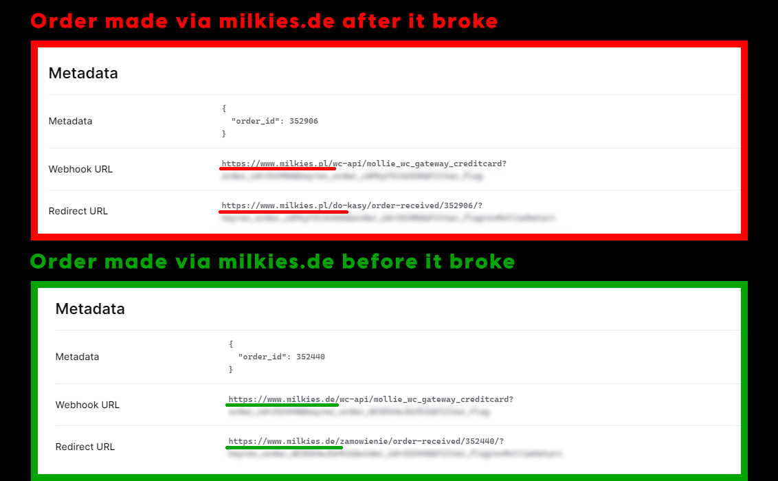

- And the most terrible thing - all customers that buy from milkies.de and pay via PayPal / Mollie (any gateway that redirects them outside of my store) are redirected back to milkies.pl after the payment is successful - making them super confused. I can see for example in Mollie (please look at screenshot) that the redirect URLs that are passed are wrong.
Here are the strange things after some of my digging:
- The "wpml_language" parameter in postmeta for the orders is set correctly - if I order through milkies.de the parameter in postmeta for that order is "de"
- Not everything is switched back to polish - it looks like part of the order processing is suddenly done via milkies.pl instead of milkies.de domain and the polish information is being presented instead of the german one
- If the order is done via the standard Offline Bank Transfer gateway (where no redirection outside of my store happens) - everything is correct - the admin notification is correct - everything is as it should be.
So the way I was able to diagnose this issue at the moment - WPML fails somewhere along the payment gateways and that screws up the order processing - some of the processing is done via milkies.pl and that screws up everything else.
November 29, 2023 at 5:48 pm #14954721
katarzynaL
Lucas - just a little update - from what I'm seeing - this issue is strictly corelated with the Webhook URL / Redirect URL that are sent to the payment gateways being generated always via the main language domain (milkies.pl) - even if the order is done via secondary language.
After this happens the gateway sends the confirmation of the payment to the URL via milkies.pl domain (instead of milkies.de or milkies.eu).
