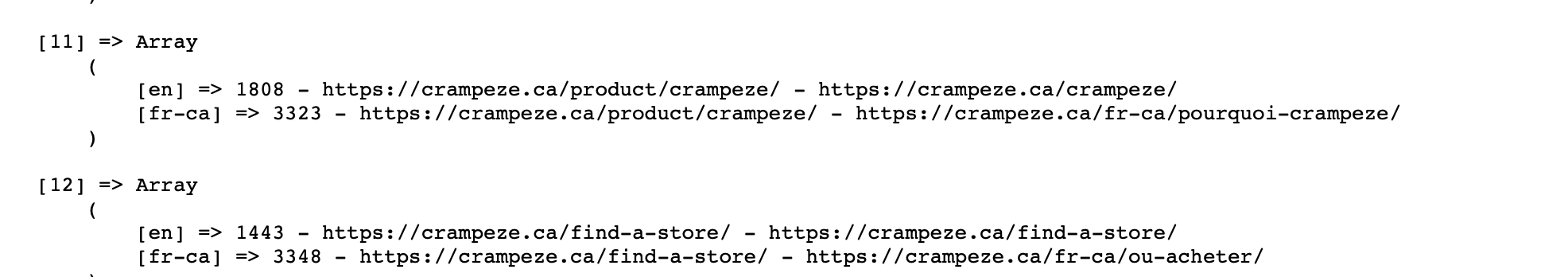

$permalink = get_permalink( $pid );
$post_link = apply_filters( 'wpml_permalink', $permalink, $post_lang_code, true );
I'm trying this code but it's returning bad results (pls check attached image)
The desired result should be
What's wrong with my code?

please note as per our support policy we can not support, debug custom code or provide custom coding services.
We will be glad to help, with some advice and hopefully, that works for you, otherwise, we advise hiring WPML contractors: https://wpml.org/contractors/
Anyway, I further checked the hook for bug and similar code and it works just fine. I am not aware of your other custom code and setup, but it could be you are not getting the correct language code or Post ID or some other parts causing issues.
We advise using wpml_current_language hook:
- https://wpml.org/faq/how-to-get-current-language-with-wpml/
You can check my results in the footer of the next test website: hidden link
Code used: https://pastebin.com/raw/6BXDk6zN
Hope this helps and please note it is just an example code and to be further adjusted and managed for your case by the developer.
