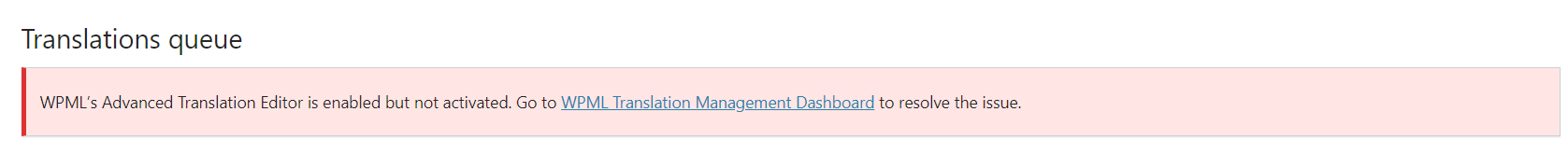

WPML’s Advanced Translation Editor is enabled but not activated. Go to WPML Translation Management Dashboard to resolve the issue.
I have tried several ways to fix that but unable to fix, please give a proper solution.

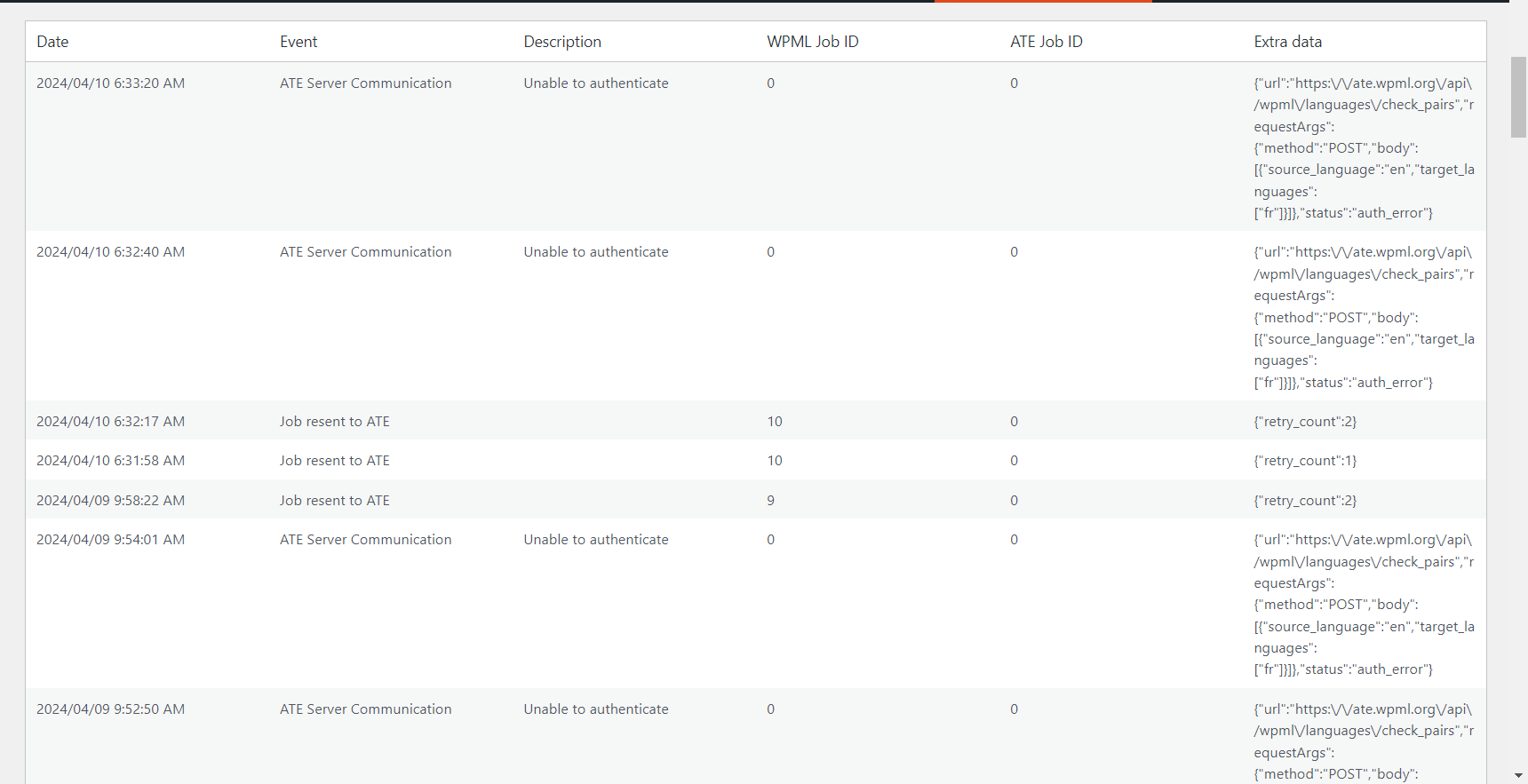

Can you please go to WPML->Support-> ATE error logs and share with me the top 3 errors you see logged?
This will help us understand what might be causing this behavior.

April 10, 2024 at 7:50 am #15502524
estherJ-5
I am attaching a screenshot of the errors in the error logs.
Please try to fix it asap.

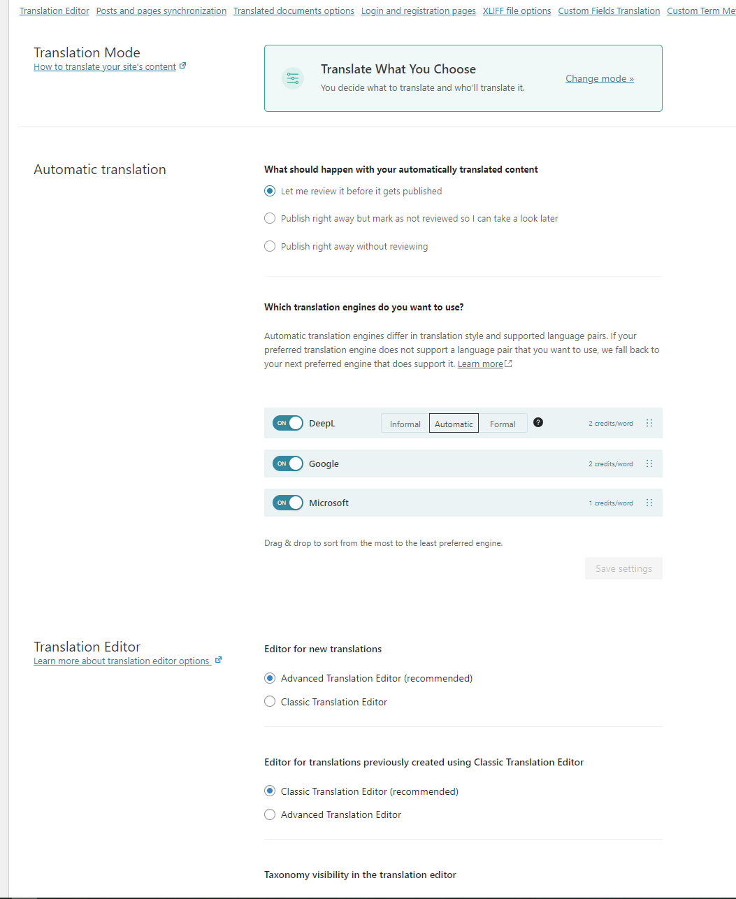

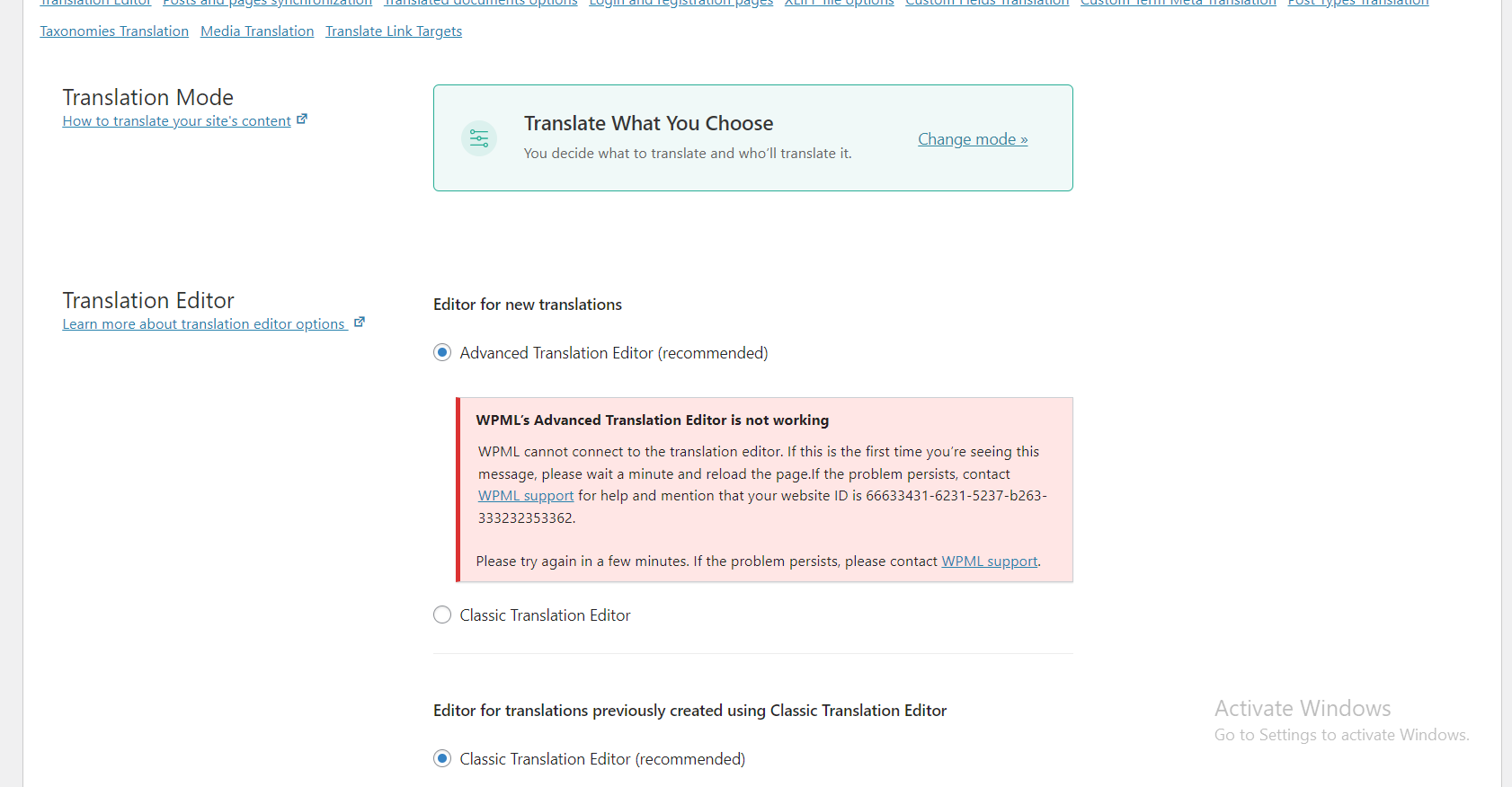

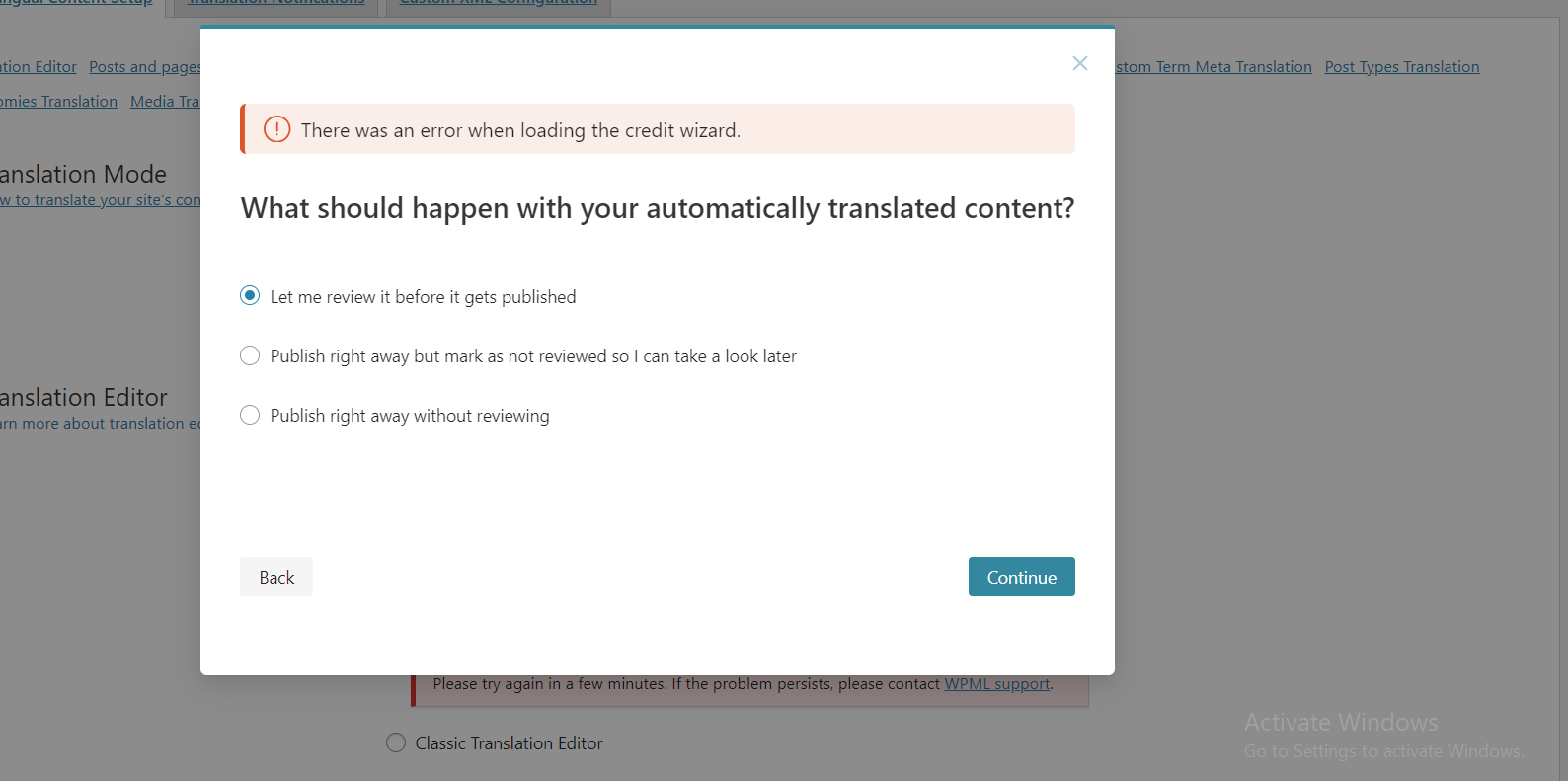

I tried the above steps that you have told, but still it doesn't work.
One more thing i have checked, i was checking the settings option and found that i have selected to "Translation what you choose" but when i tried to select automatic translation then got an error. I have attached the screenshot for the same.
And in the Translation Editor getting error that translation is not working and a pop-up with my website id and connect with support-Wpml.
Please look into this and try to resolve this issue asap.
Waiting for your reply.
Thankyou.

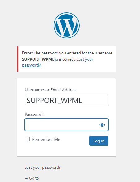

April 12, 2024 at 12:03 pm #15512769
Marsel Nikolli
Can you please check the login details, I get an error when I try to log in (Please check the attached image).
Thanks,
Marsel
April 12, 2024 at 1:14 pm #15513044
estherJ-5
Hi Mersel,
I have updated the password in the last message please check that one.
April 12, 2024 at 1:36 pm #15513087
