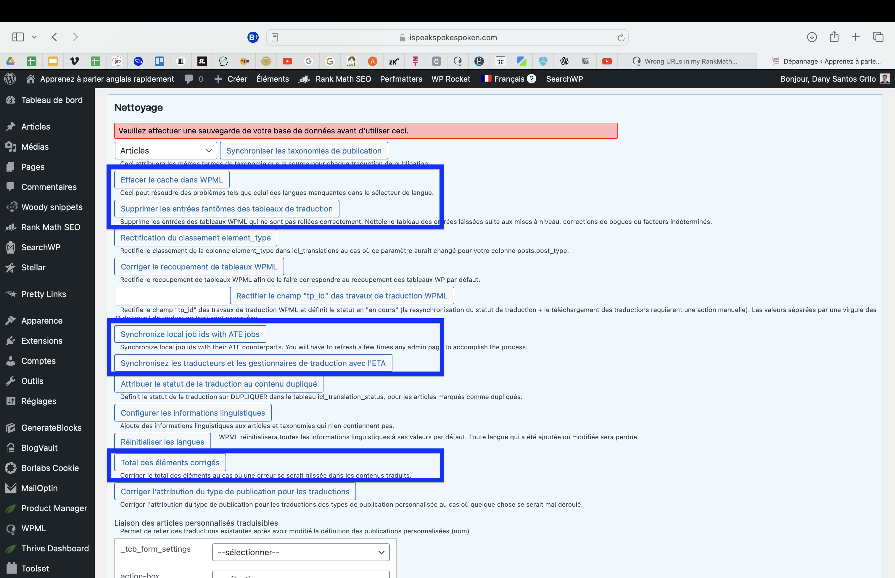

2. How can I easily remove them without having to go over the entire DB?
WPML provides some handy (advanced) operations for these, from syncing jobs with ATE to removing ghost entries etc. Please go to WPML → Support → Troubleshooting page and find the relevant options. Each option has some description underneath. You can try the suitable ones. After applying each operation, wait for it to finish and check for your issue before applying another one. So you can know what resolved the problem.
Please remember to take a full backup of your website and database, before going for troubleshooting operations.
Please notify me if any of these help resolve the issue, or I'll try my best to further assist you on the matter.

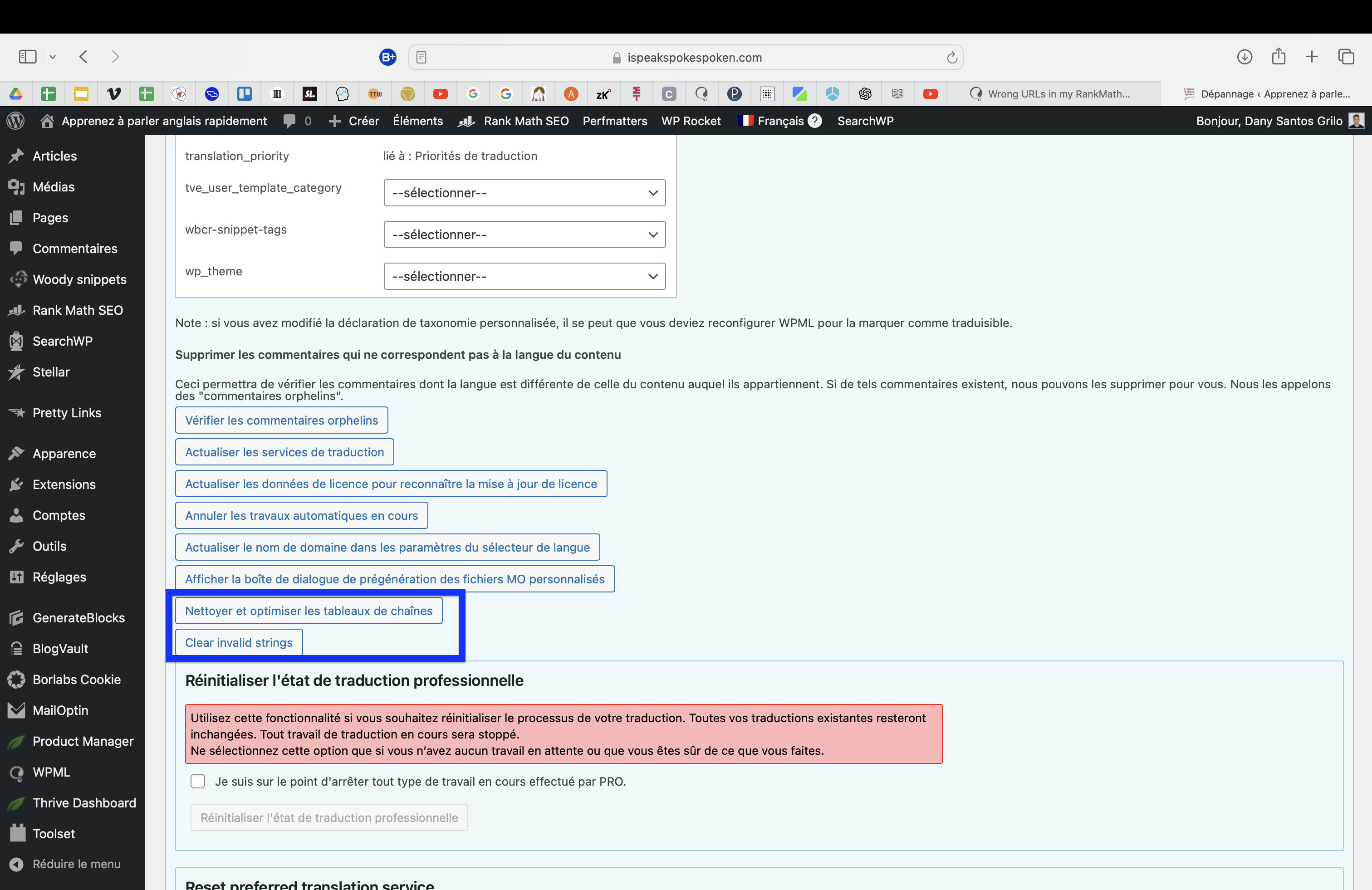

I've tried many different options in the "troubleshooting" page and I still have the issue (see screenshot).
I can give you an access to a staging version of the website, if you want to.
Thank you for your time,
Adrien

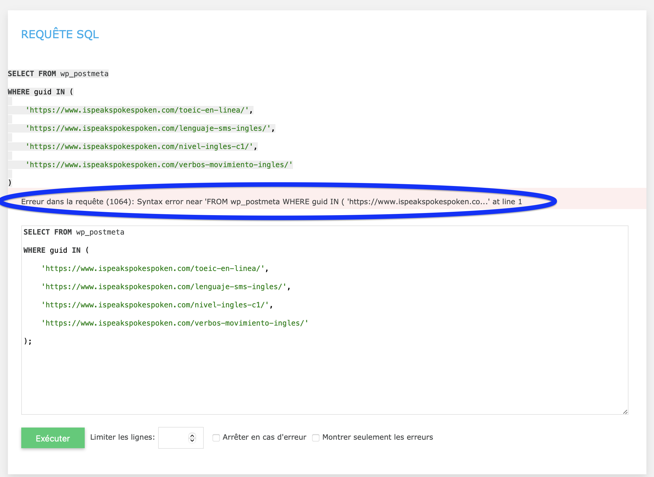

I did a whole backup of the website and ran your "SELECT" command. However, I faced an error: 1064 syntax error.

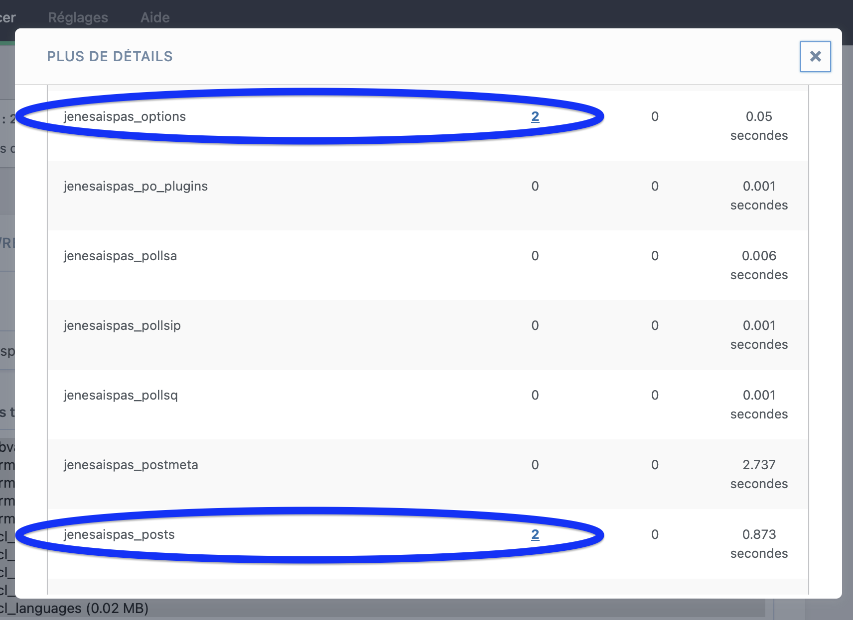

I used the plugin "search and replace" to see where the wrong URLs were located, and I found out that they appear in these DB tables :
- wp_options
- wp_posts
However, I don't have enough knowledge to know why there's a 1064 syntax error. You'll find a screenshot.

I see. I'm sorry, I'll update the queries:
SELECT * FROM wp_posts
WHERE guid IN (
    '<em><u>hidden link</u></em>',
DELETE FROM wp_posts
WHERE guid IN (
That should work. Please share your results.

What is interesting though:
When I use your SQL command with the wrong URL, for example:
/vocabulario-navidad/, I get 2 results.
When I use it with the right URL, for example : /es/vocabulario-navidad/, I get 0 results.
If needed, I can provide you with an access to the staging version of the website I'm using to try and fix this issue.
