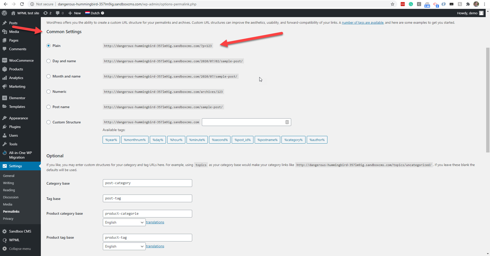

If I understand you correctly, and according to what I can see on the test site, the option that is currently on in the permalinks section is 'Plain'. Please see the attached screenshot.
If so then unfortunately I'm afraid that this is not a good solution because WPML needs to work with the pretty permalink structure of WordPress and not with the plain structure. Changing this behavior is not a simple coding task.
