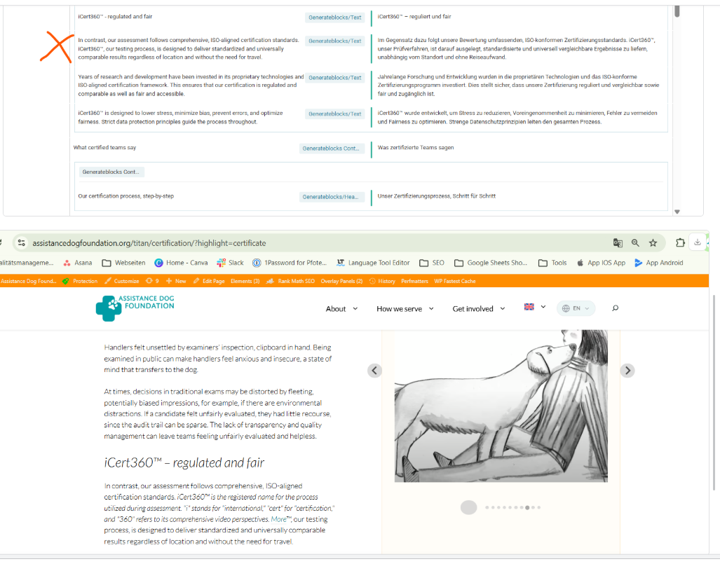

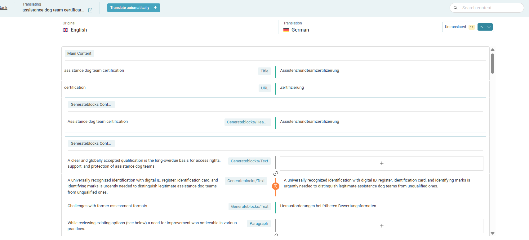

5. Certificate page
The text in the WPML editor is not the same as what we are having on our page.
And I edited the translation in the the editor a little bit, press save and complete and I returned now suddenly it has gaps in the translation (screenshot below).

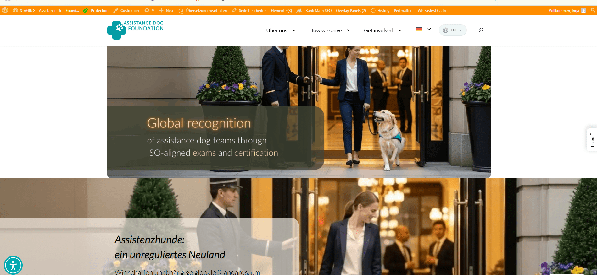

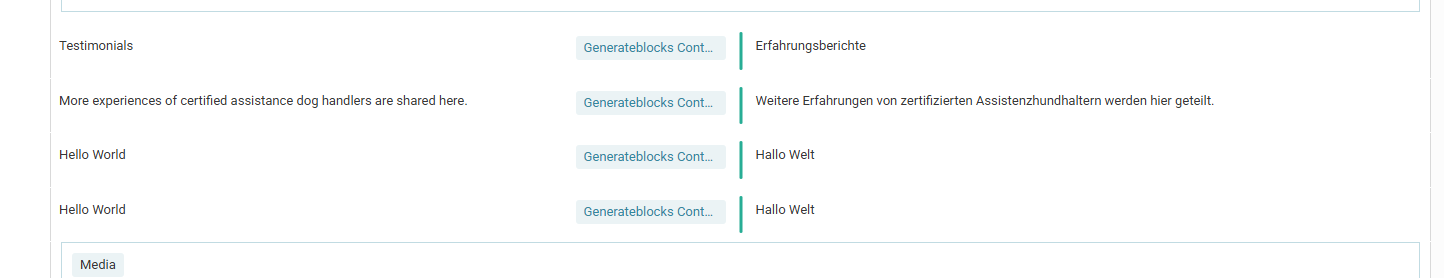

6. Home - Front page
The first image is double on the translated page.
An English image below, I added the German one in the Media Library of WPML but it doesn't get replaced.
And there is suddenly a Hello World in the editor, which we do not have on the English page.

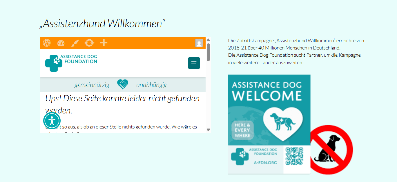

7. About assistance dog teams
The video is showing up for the first second, then it claims cant be found.

5. Page certificate - outdated translation
I clicked on translating it again automatically in the WPML dashboard but unfortunately the text in the side by side editor is still outdated. How do I re-translate correctly?
6. Front page with multiple issues
I made you a video, I think it is easier for you to take a look.
And if needed, I can request a WP staging login for you from our team.
7. About us page - video
Also a short video that you can see it. With a great demonstration effect, normally the videos works on the english version. But my guess is, we have to break the connection to use a different embed code for the german video - correct?

As for outdated translation in translation editor, you can go and make small change to default language page title, save and then click the arrows icon to update translation and it should show latest content to be translated.

So we keep this one here for 5. Page certificate

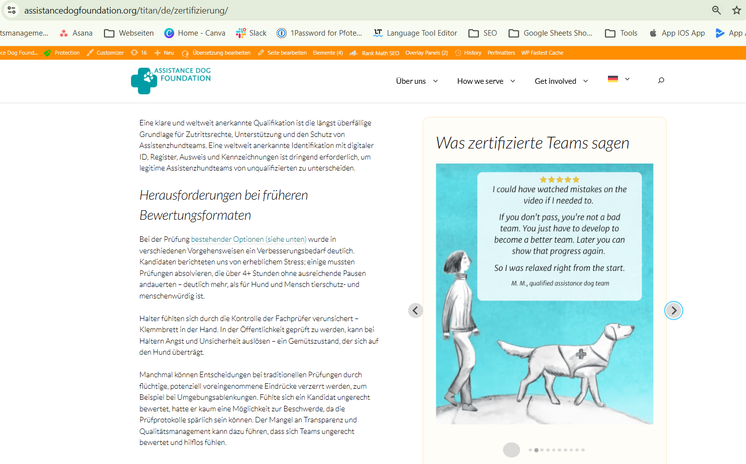

Okay I noticed that the error is on our WP staging site, the editor of the page looks different from the view of the page.

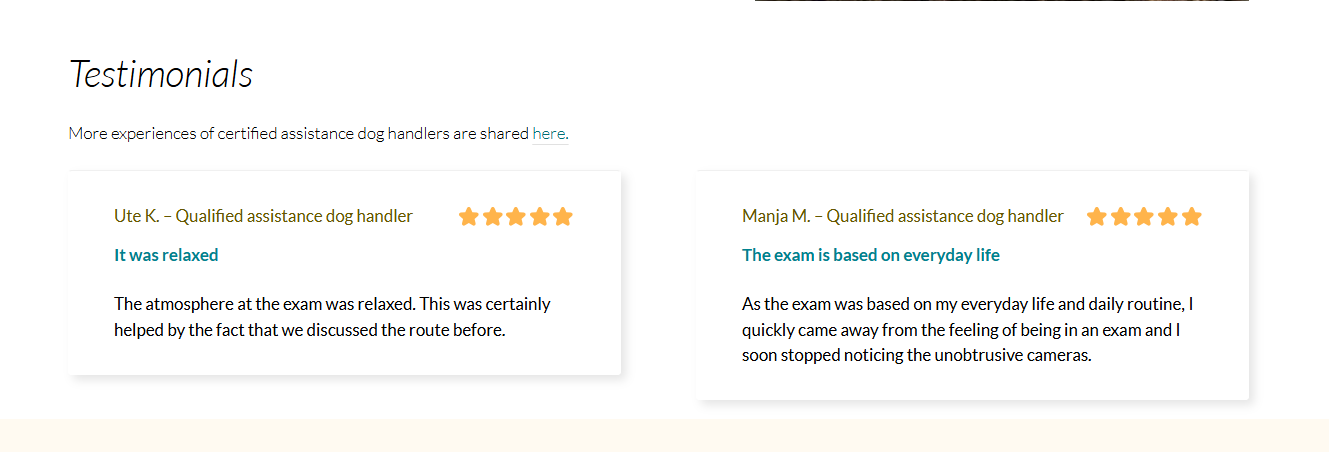

But there is one issue with WPML Media
I added all testimonials to the WPML media library. I don't understand why the second one in the carousel has a different name than the others.
But unfortunately the image stays in English on the German page.

Hey Dražen,
thanks. Yes, I tried your steps. But I think the problem is somewhere else. Because the WordPress editor shows a different text than the view of the page.
So I informed the IT team to take a look there.

I’m not sure I fully follow. If you are using the WPML Translation Editor, the content should be managed there rather than in the WordPress editor.
Could you please share the exact steps where you see the difference between the WordPress editor and the frontend?
Also, if the issue is already visible in the default language, then it’s likely not related to WPML, since WPML only affects translated content.
Let me know and I’ll take a closer look.

Exactly. I found the problem on the default language as well, so it is not related to WPML.
