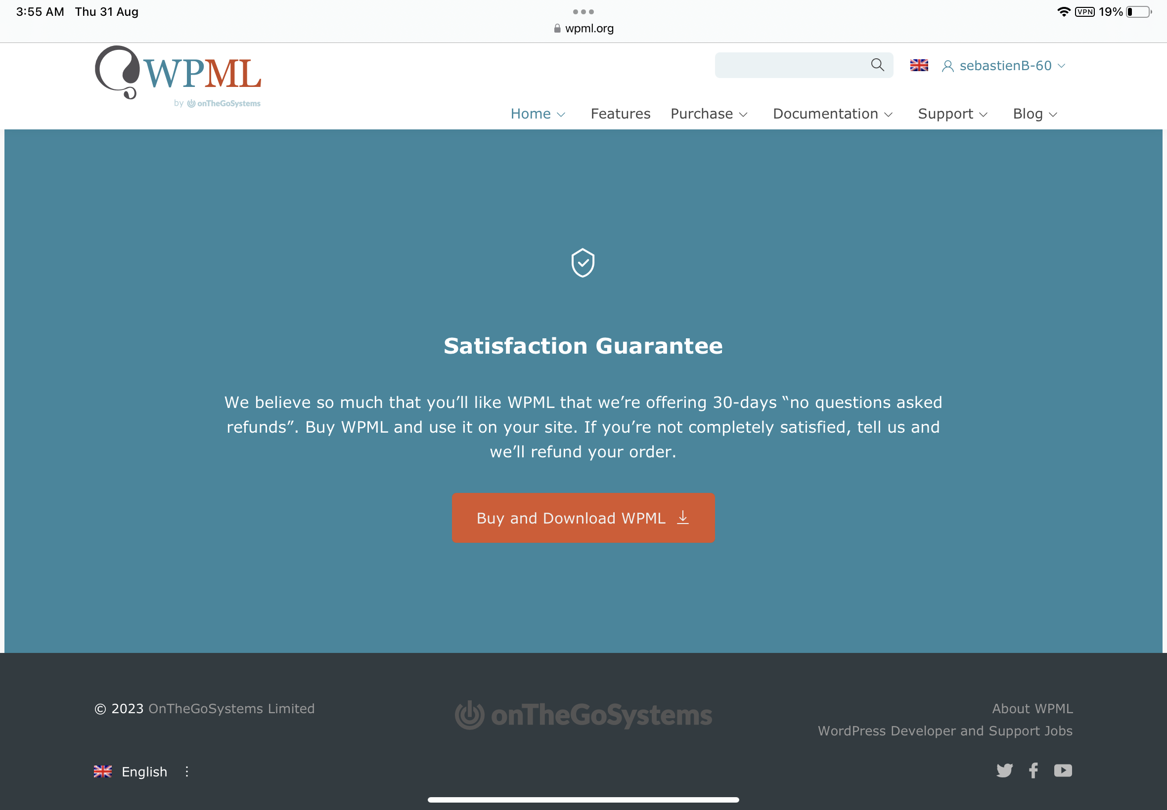

Your slogan is?!?, satisfaction guaranteed? You even delete the saying i was waiting for 12 hours. It is 4 am in Thailand.

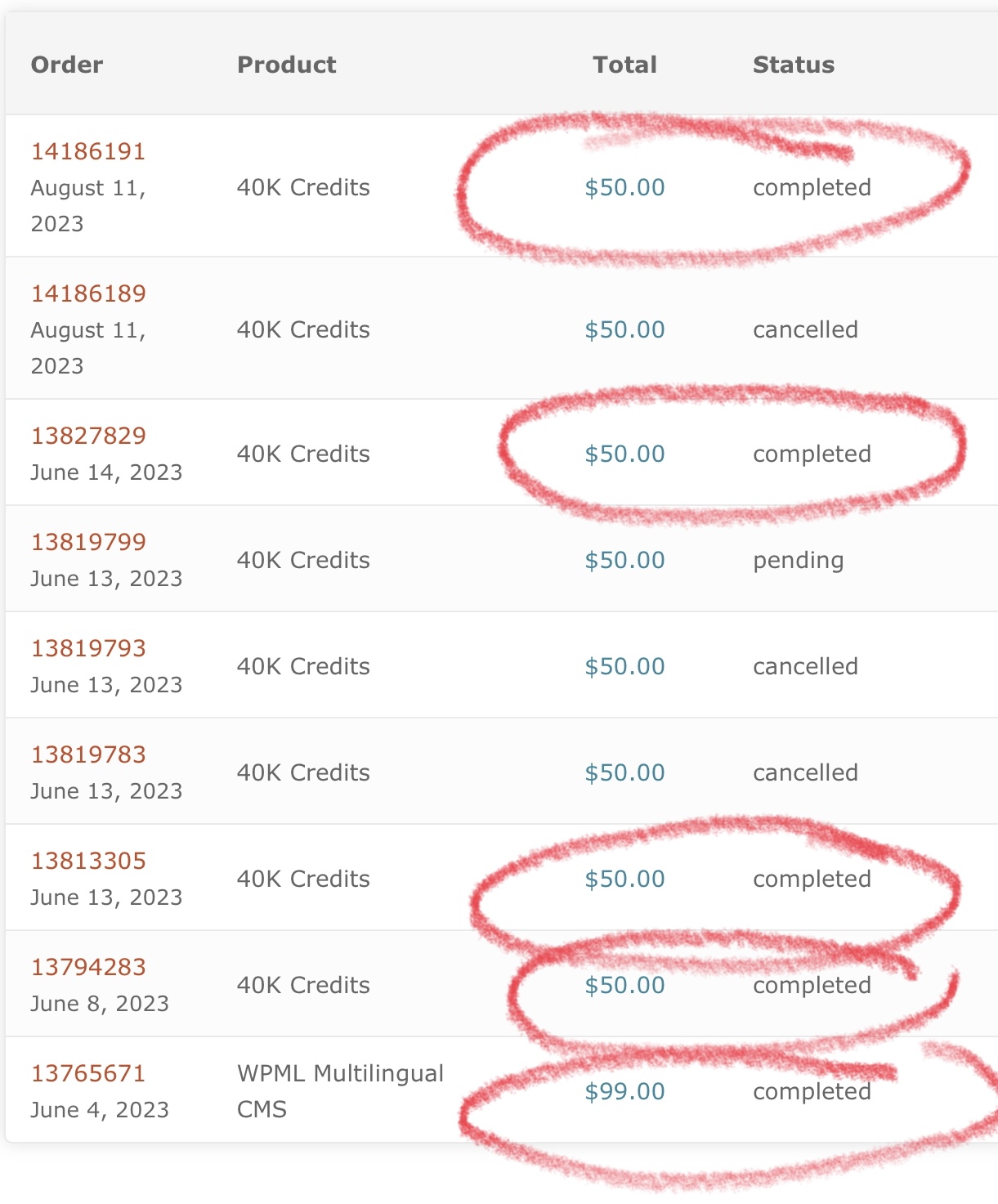

I paid 300$ in less than 3 months, can someone helped me, it is URGENT. Lauren did not help, she copy paste articles that I read and it does not work for me. Not sure why.
