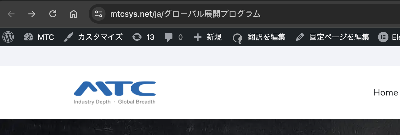

The URL you are sharing does not exist which is why it's redirecting.
The Japanese URL for that page is as follows:
