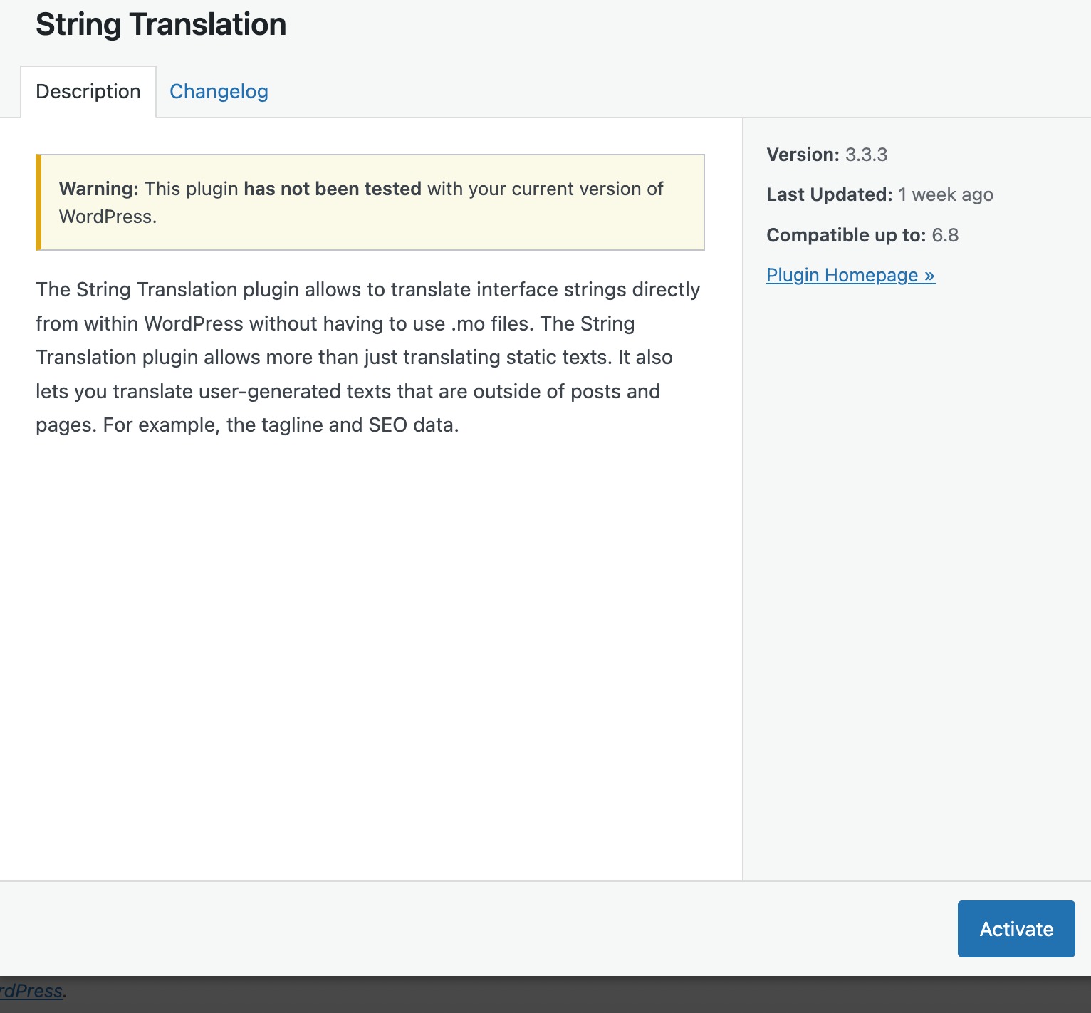

azimd
looks like problem with string translation 3.3.3, if we disable this looks like working as expected.

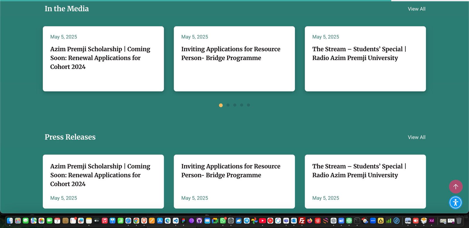

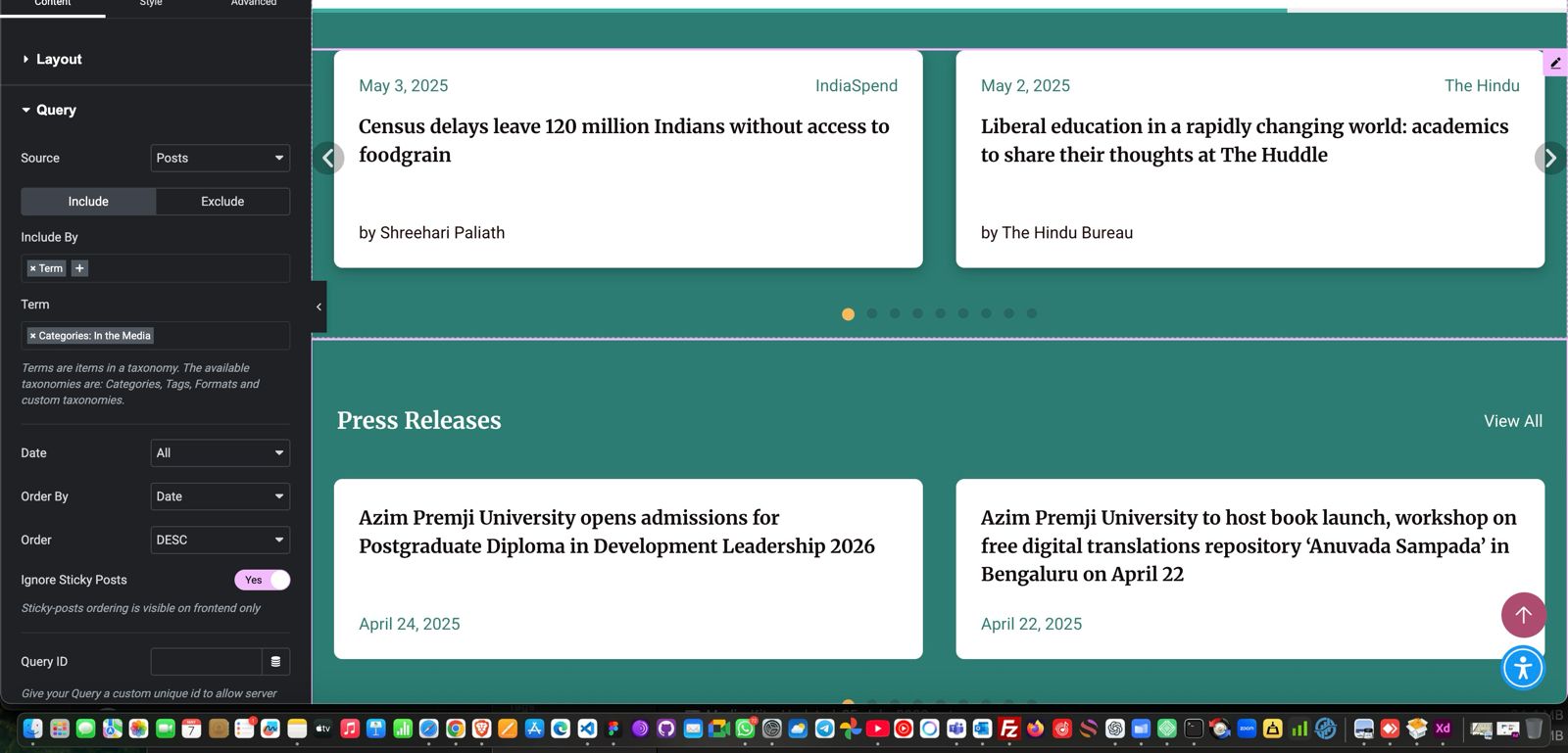

Hi I have attached the screenshots for the Elementor editor where the post categories are loaded correctly but when we see the same home page on the front end, both the sections are loading all the posts without any category selection.
If we disable the string translation(3.3.3) plugin, then this category works fine in the front end. Any idea what might be the issue?
Before we updated to WPML 4.7.4 and string translation 3.3.3 it was working fine.
