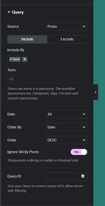

What is happening, is that after closing Elementor, the Query Terms are not remaining saved.

On your site, for some reason, the widgets do not save their category setting in the query section.
Could you please give this a test by creating a completely new widget with a loop item template and category query on your site?

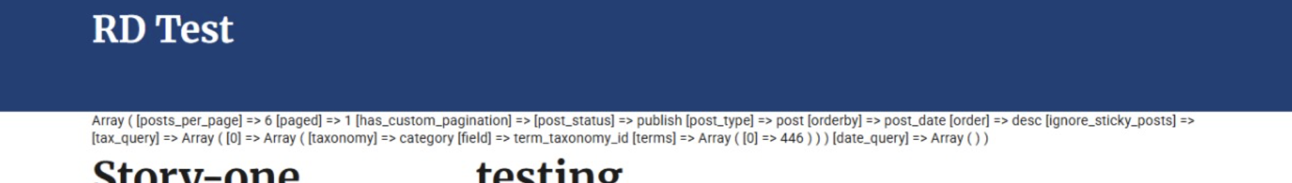

We did some investigation while you were away and wanted to share our findings. I’ve attached two screenshots — one showing the query when the String Translation plugin is enabled, and the other when it’s disabled.
For some reason, the [tax_query] element is missing from the query array when the String Translation plugin is active.
Additionally, we’re now able to filter posts using the query ID, but not by category name. Strangely, the category filter is not being included in the main query when the plugin is enabled. We’re currently applying the category filter using the query ID, but only after the main query has been fired — which isn’t ideal.

Here are the query parameters:
query parameters when string translation plugin is enabled:
Array ( [posts_per_page] => 6 [paged] => 1 [has_custom_pagination] => [post_status] => publish [post_type] => post [orderby] => post_date [order] => desc [ignore_sticky_posts] => [date_query] => Array ( ) )
query parameters when string translation plugin is disabled:
Array ( [posts_per_page] => 6 [paged] => 1 [has_custom_pagination] => [post_status] => publish [post_type] => post [orderby] => post_date [order] => desc [ignore_sticky_posts] => [tax_query] => Array ( [0] => Array ( [taxonomy] => category [field] => term_taxonomy_id [terms] => Array ( [0] => 446 ) ) ) [date_query] => Array ( ) )
