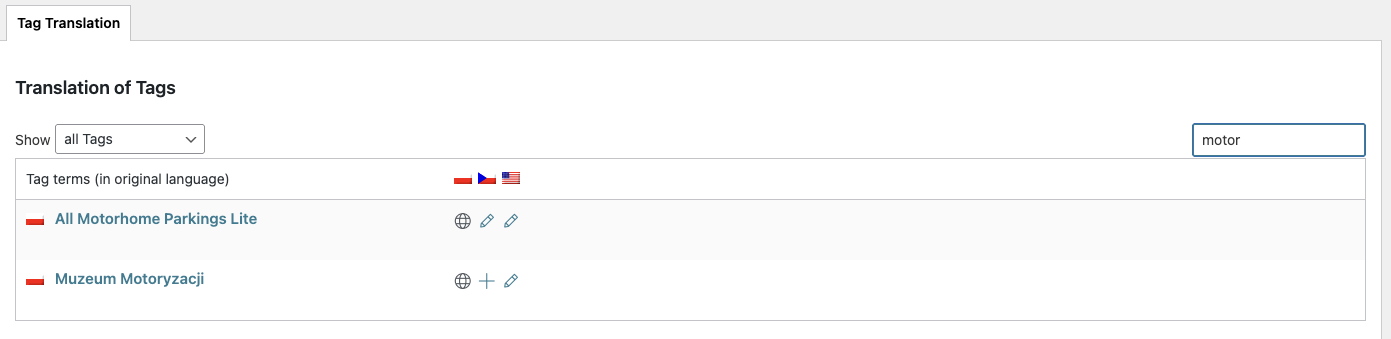

June 9, 2025 at 2:34 pm #17118850
Otto
Thanks.
I created a new post and added to it the tag: "All Motorhome Parkings Lite", which was untranslated to Czech.
I sent the post to automatic translation and after that the tag is translated to Czech. Check the screenshot attached, please. Am I missing something? What are the steps I should follow to see the problem?
I added the credits to your account.
