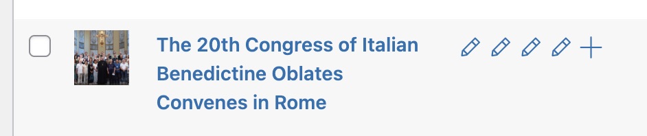

October 13, 2025 at 3:32 pm #17480471
Stefano
Ciao, Carlos
Please see the two screenshots attached.
The first will show the post and the “plus” indicating that the ES version is not translated. The second will show the number of articles in the different languages. There are 82 articles in all of the other languages, but only 81 articles in ES.
Furthermore, when I view only the ES posts, this post does not appear. So there is no post to delete. There is no trash to empty, either.
I tried to translate the post anyway, as you recommended. It is stuck again. Of course, I have a backup of the site, so I am going to leave the post “stuck” so that you may more clearly see what is going wrong.
All of this is very clear from the Admin panel of the web site. If you need help logging in again, please let me know.
Thanks -Simon
October 14, 2025 at 9:42 am #17482640
Carlos Rojas
WPML Supporter since 03/2017
Hi Simon,
It seems the entry in the database for that particular post is corrupted. Please re-create the post in English, translate it into the secondary languages, and double-check if the issue disappeared.
