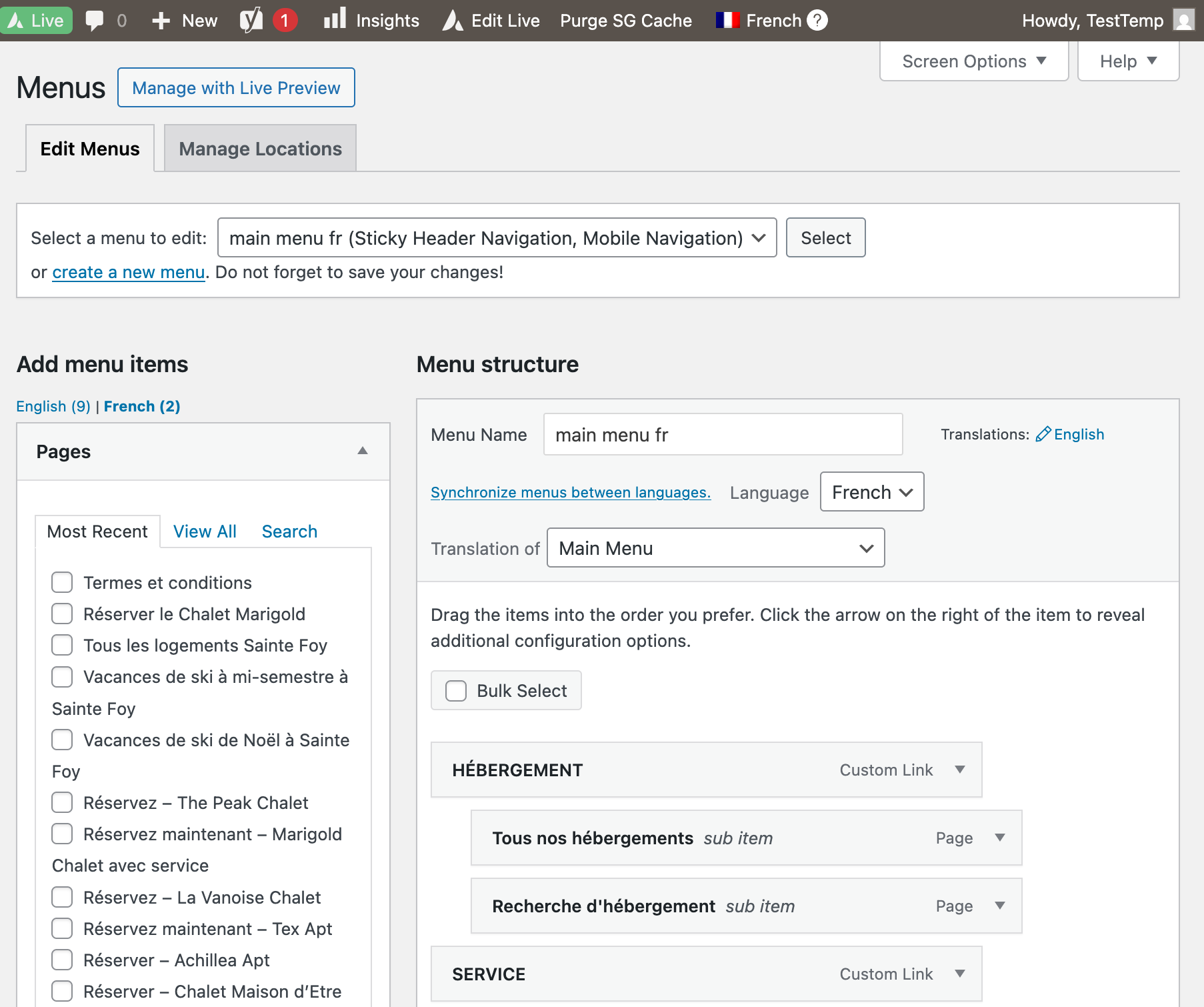

1. We recommended checking the menu settings in WordPress under WP > Appearance > Menu to ensure the correct menu is selected for the French version.
2. It's important to link the primary language "main menu" to its translated version as shown in the provided screenshot. This step is crucial for the menus to display correctly across different languages.

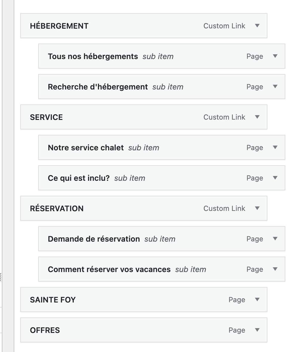

I am using Avada and have a French menu which is separate from the English one on my site hidden link. The main menu (top menu) is no longer showing, except for the last tab, although the submenus are visible. I need help to have this main top menu show again. I have attached a screengrab of the menu that should be showing.
The main French menu is not displaying, except for the last tab, while submenus are visible.
Why is the main French menu not showing except for the last tab?
How can I make the main top menu visible again?

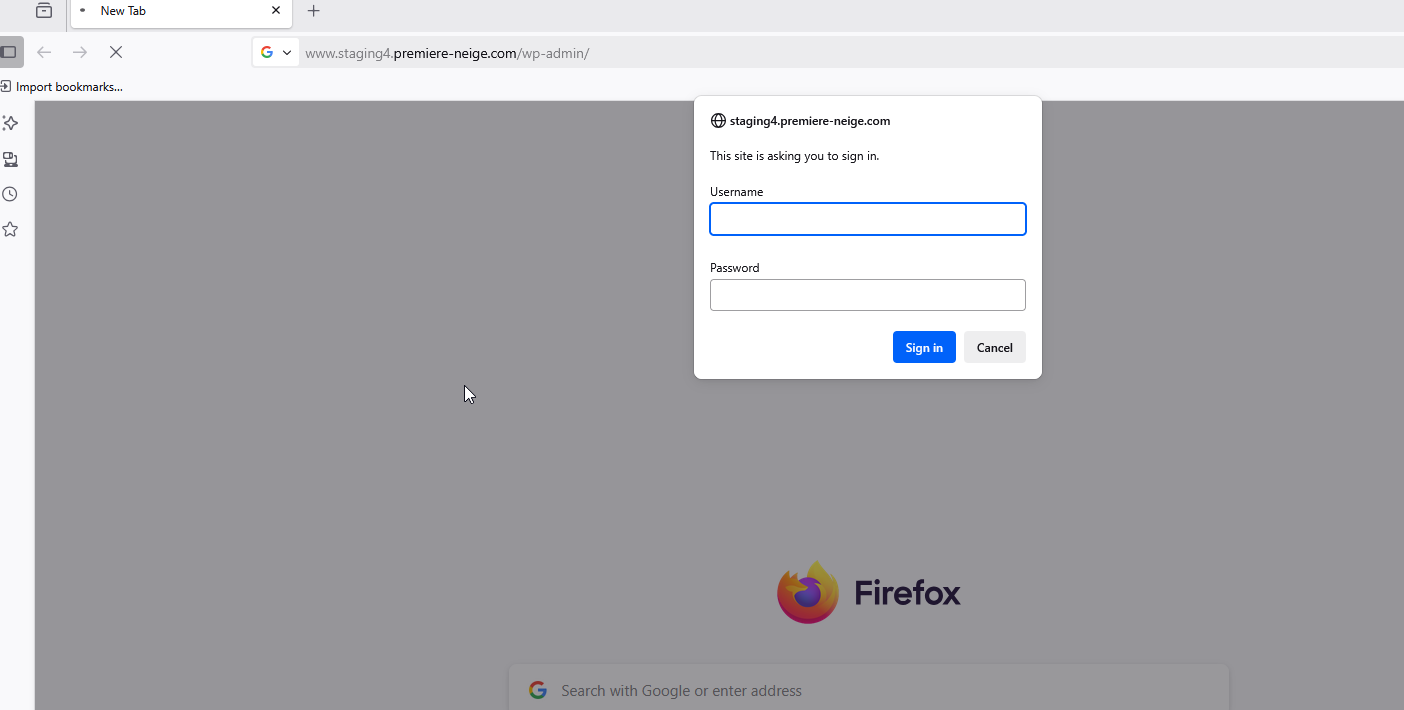

June 24, 2025 at 4:15 pm #17166209
Thanks for your reply. Could you share the access for the authentication popup as shown in the attached screenshot?
June 24, 2025 at 6:53 pm #17166474
hollyJ
So sorry Kor, there is an additional layer of security. Can you re-send the secure form and I will give you the details

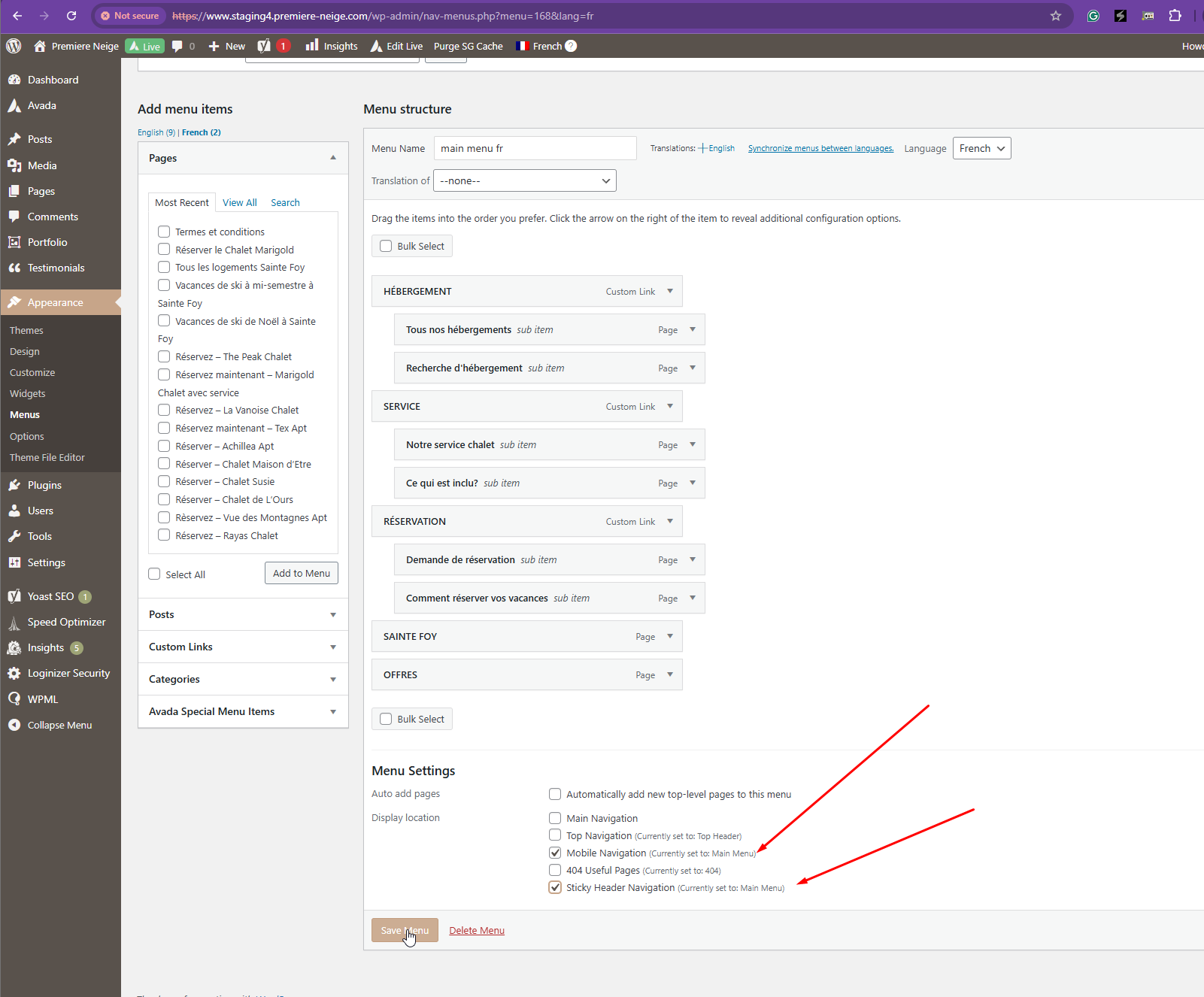

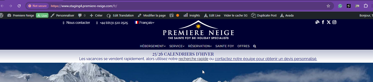

June 25, 2025 at 8:44 am #17167730
Thanks for your reply. I've switched the menu using the checkboxes here in WP > Appearance > Menu as shown in the attached screenshot. Is this what you're trying to achieve? hidden link

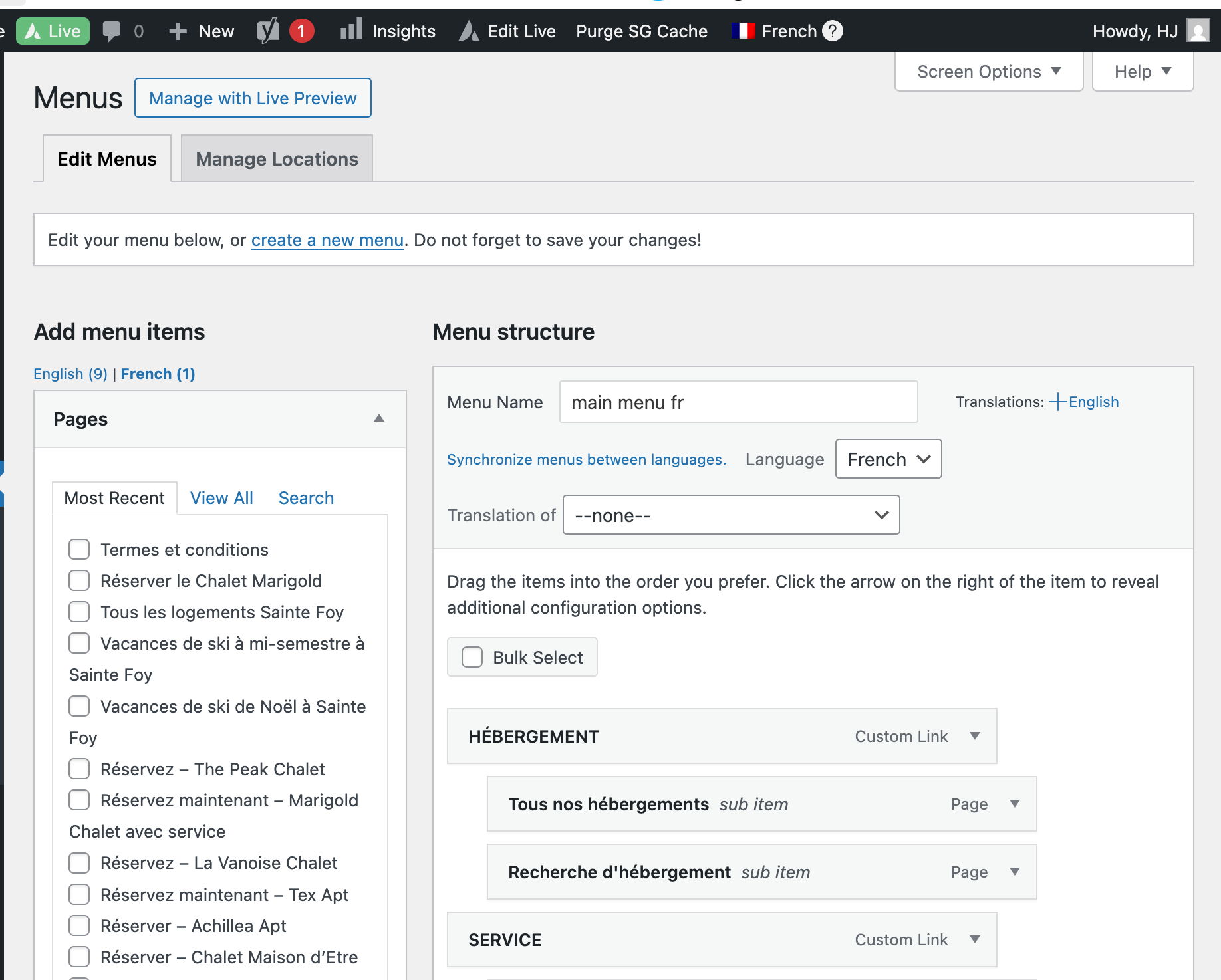

hollyJ
I can see what you've done, but I think you have also done a translation, see the differences between the live and staging site. I'm not sure how you got to this.
Just ticking the alternative styles for the menu doesn't have any effect on the live site. It still shows the wrong top menu.
Historically I just created this menu specifically for the french side. I can see you made a test menu of some sort?
What should I do now?
