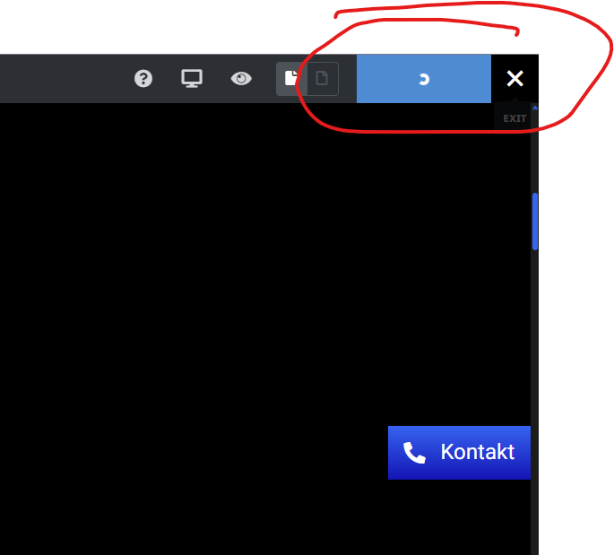

I am trying to save a page with my page builder Avada after installing WPML. The issue occurs on the DE version of the page. Here is the link to the page where the issue can be seen: hidden link
Instead of seeing a green success message after saving, I encounter an infinitely rotating saving process in the top right.
Why is the page not saving in DE after installing WPML?
How can I resolve the infinitely rotating saving process issue?
