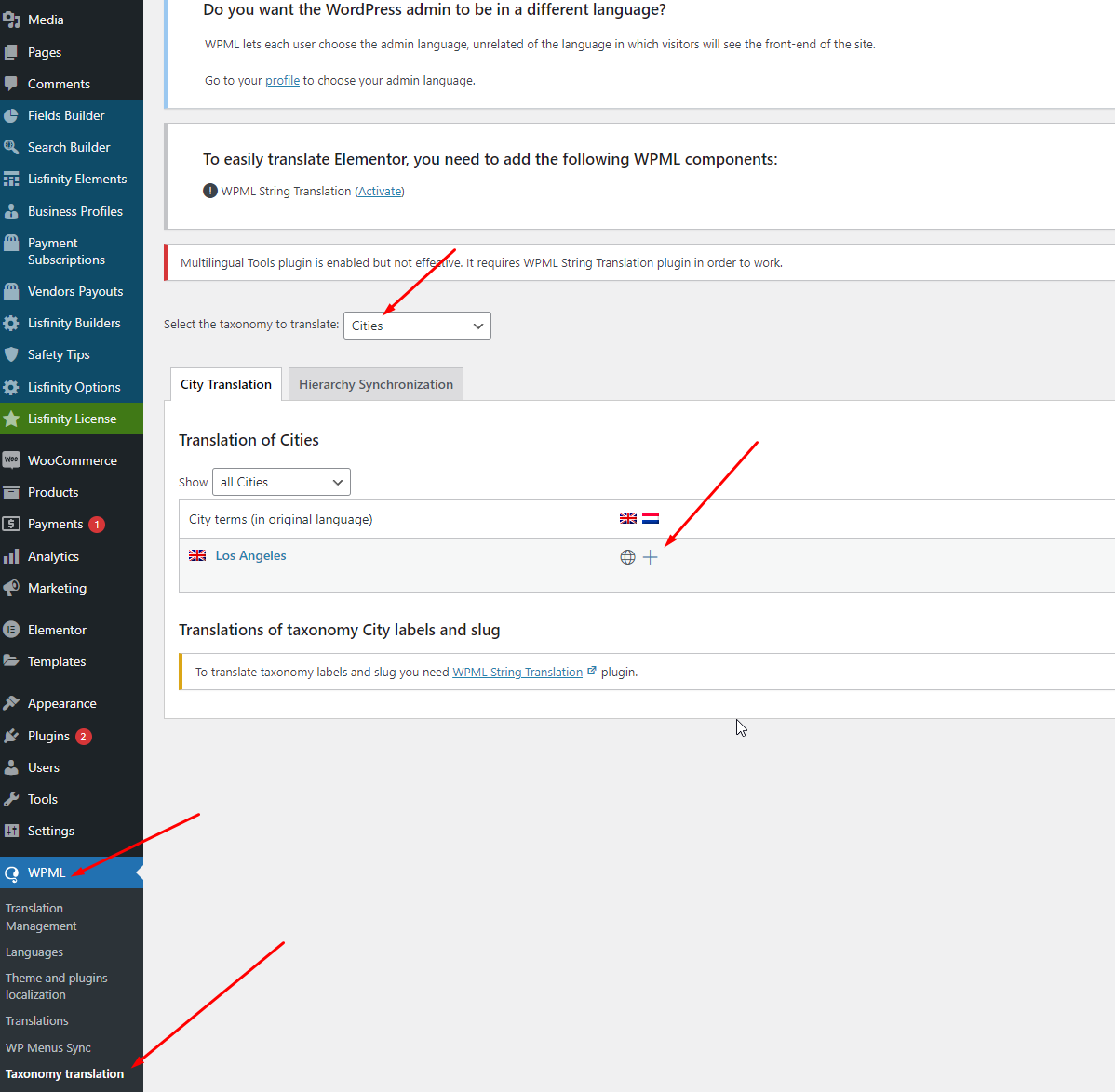

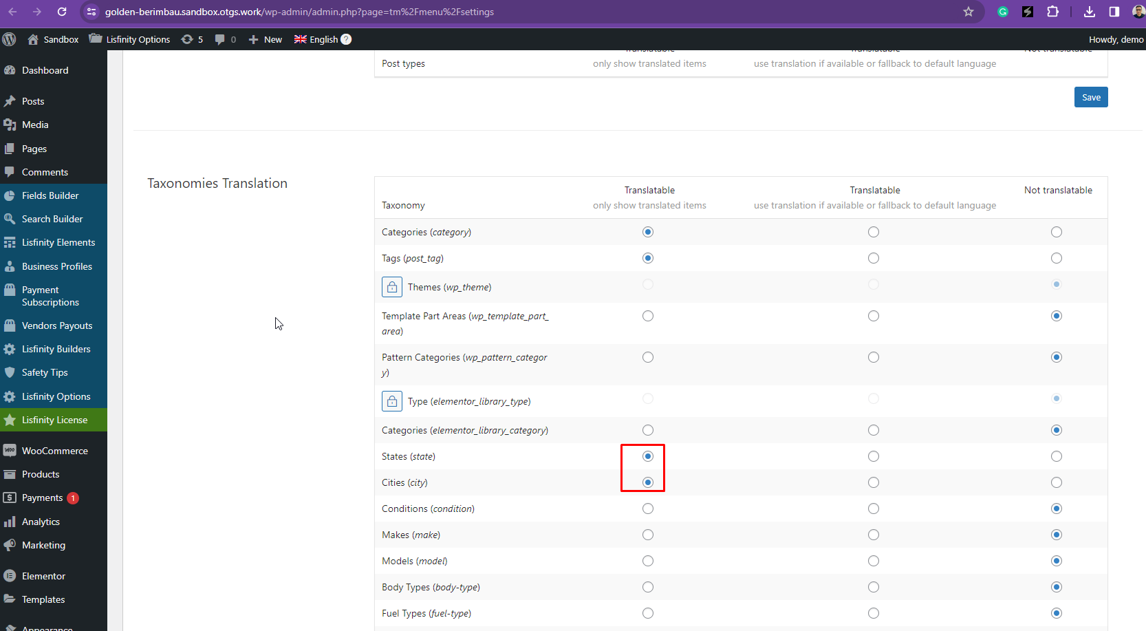

Thanks for your reply. I've checked and could you please try this method to translate the categories. On this page, hidden link go to Taxonomies Translation > I checked "States" and "Cities" as shown in the attached screenshot and clicked "Save". Not when I try to translate the categories here hidden link , select "Cities" on the dropdown and you'll be able to translate the "Cities" category as shown in the attached screenshot. Is this what you're trying to achieve there? |

There is only Los Angeles in cities however if you check the common taxonomies group there will more than one city, and also I need to translate other taxonomie groups like real estate, transport etc |
