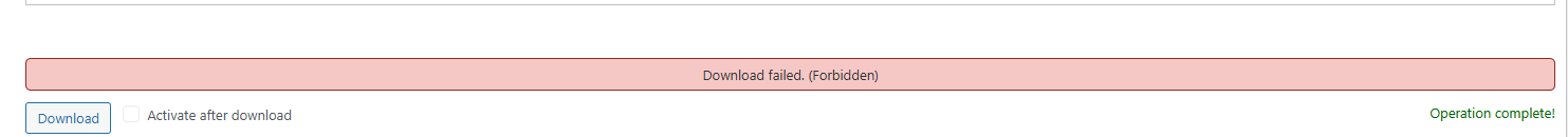

I am working on a site under development and trying to update WPML Multilingual CMS and download String Translation.
I am encountering an error message: 'Download failed. (Forbidden)' when attempting to update or download the plugin.
Why am I receiving a 'Download failed. (Forbidden)' error when updating or downloading WPML plugins?

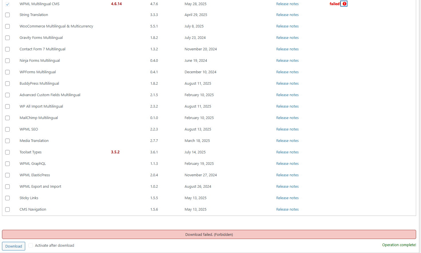

August 21, 2025 at 2:17 am #17335716
itH-7
I still have the same issue after Deregister and register the sitekey.

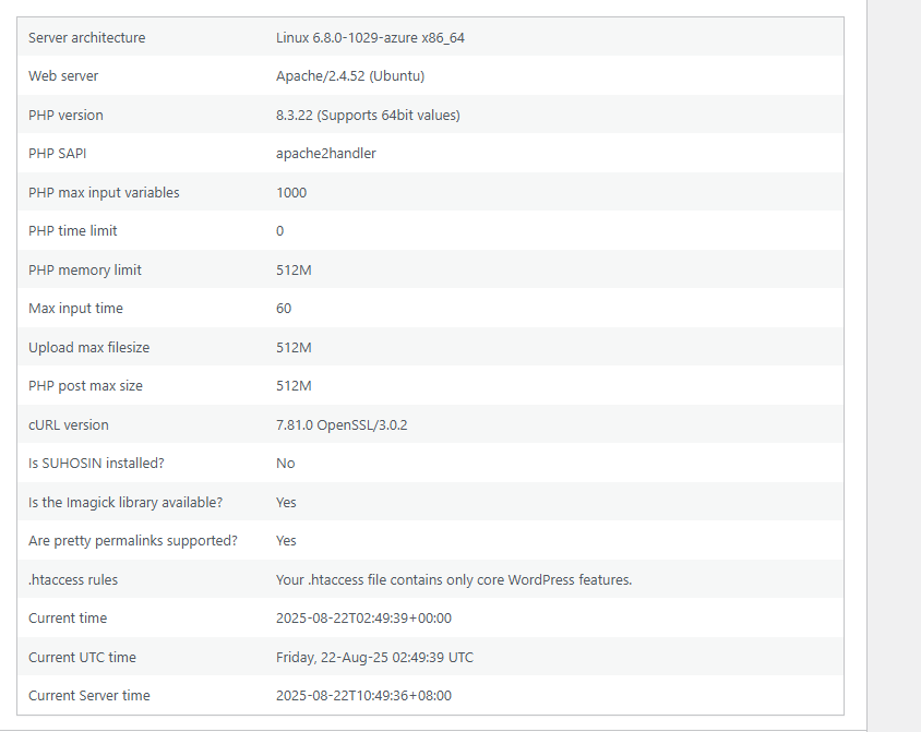

August 22, 2025 at 2:52 am #17339286
itH-7
I have already updated the PHP settings you mentioned above, but still have the same error.
