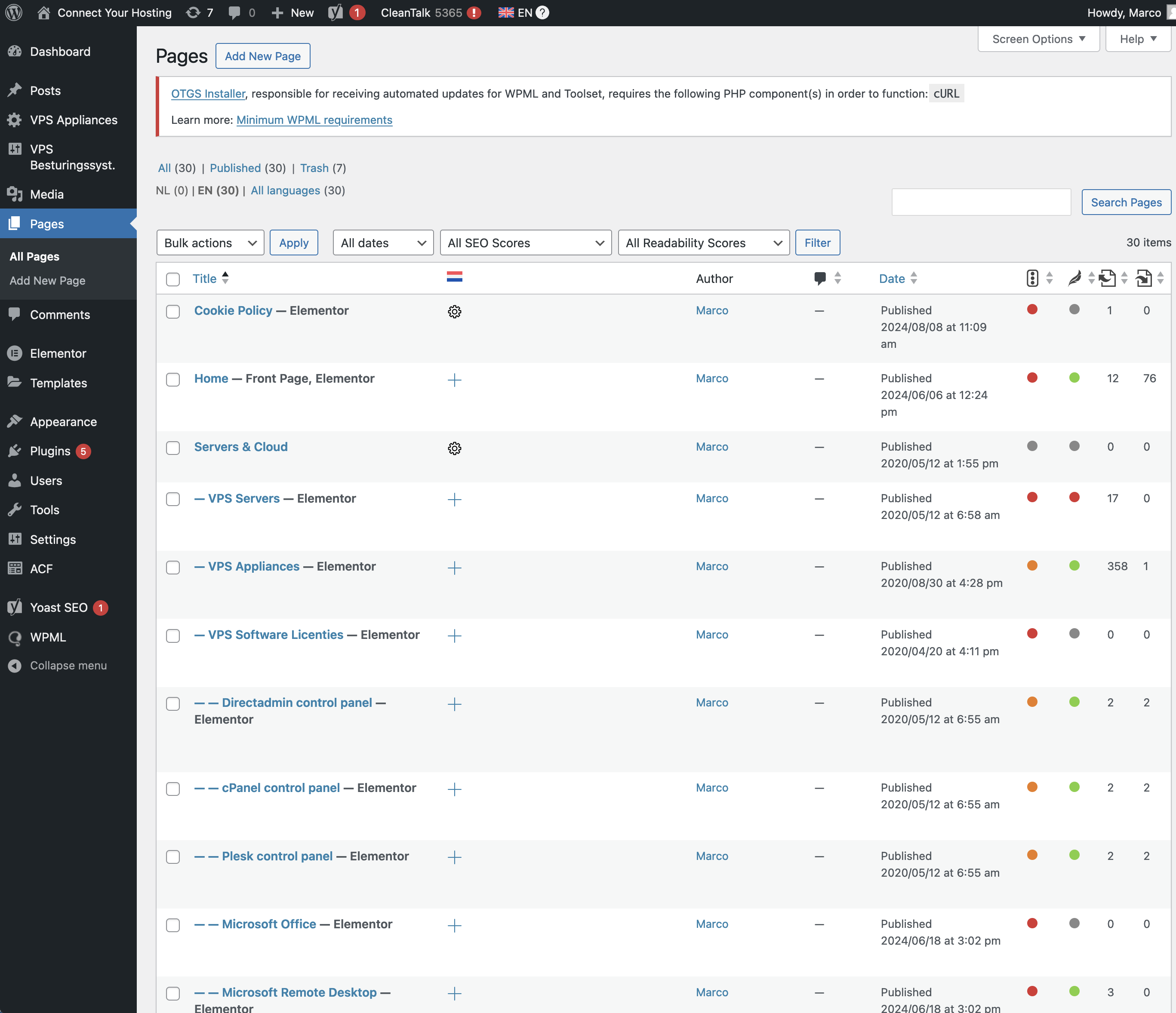

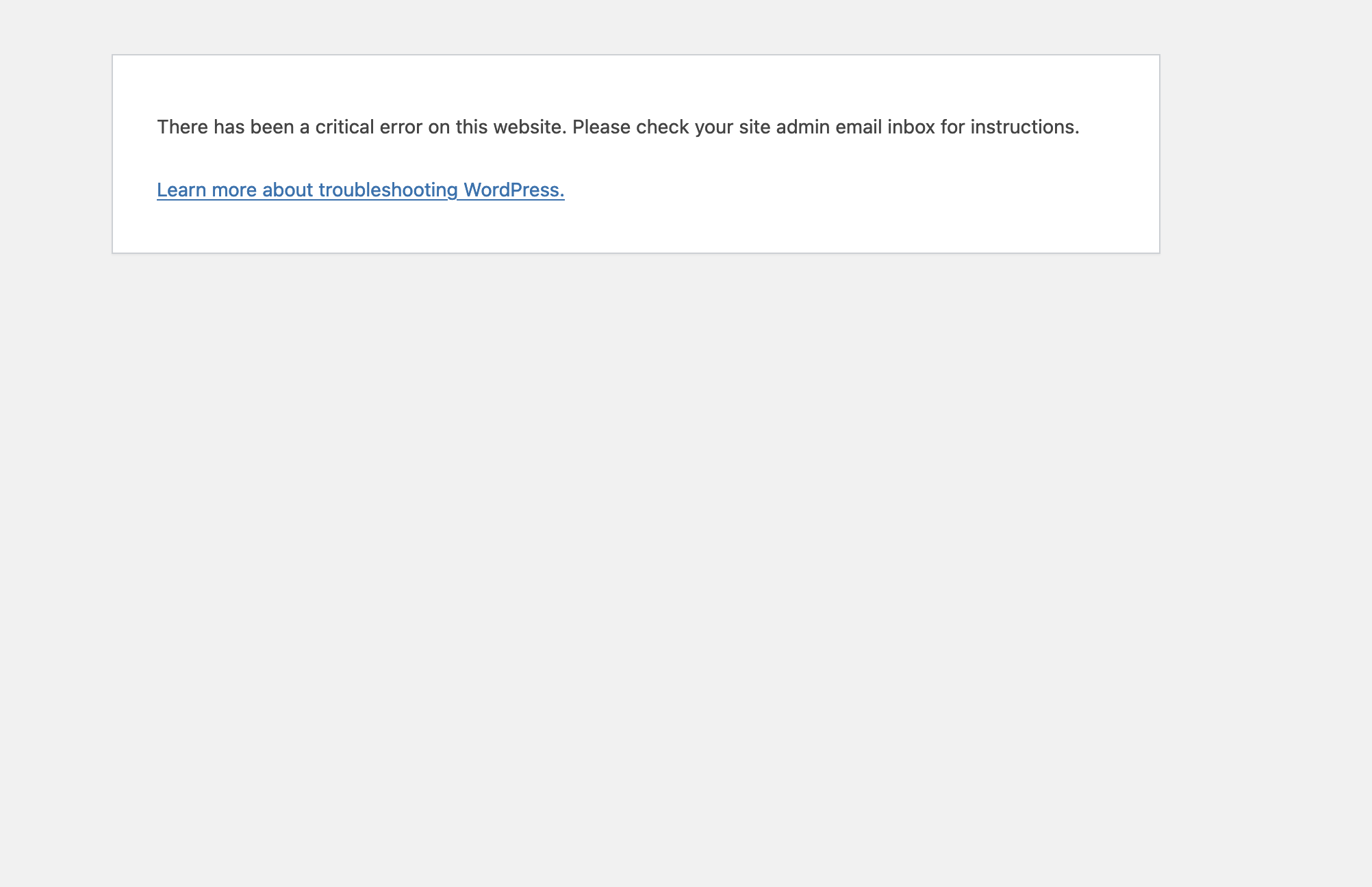

August 16, 2024 at 6:00 am #16076734
Marco
problem is still there. When I try to translate a page I get an error.

August 19, 2024 at 8:28 am #16082367
Marco
This is the error:
Fatal error: Uncaught Error: Call to undefined function mb_ereg_replace_callback() in /var/www/test.connectyourhosting.com/htdocs/wp-content/plugins/sitepress-multilingual-cms/classes/xliff/class-wpml-tm-validate-html.php:124 Stack trace: #0 /var/www/test.connectyourhosting.com/htdocs/wp-content/plugins/sitepress-multilingual-cms/classes/xliff/class-wpml-tm-validate-html.php(34): WPML_TM_Validate_HTML->hide_wp_bugs() #1 /var/www/test.connectyourhosting.com/htdocs/wp-content/plugins/sitepress-multilingual-cms/classes/xliff/wpml-tm-xliff.php(196): WPML_TM_Validate_HTML->validate() #2 /var/www/test.connectyourhosting.com/htdocs/wp-content/plugins/sitepress-multilingual-cms/classes/xliff/wpml-tm-xliff.php(169): WPML_TM_XLIFF->validate() #3 /var/www/test.connectyourhosting.com/htdocs/wp-content/plugins/sitepress-multilingual-cms/classes/xliff/wpml-tm-xliff.php(141): WPML_TM_XLIFF->appendData() #4 /var/www/test.connectyourhosting.com/htdocs/wp-content/plugins/sitepress-multilingual-cms/classes/xliff/class-wpml-tm-xliff-writer.p in /var/www/test.connectyourhosting.com/htdocs/wp-content/plugins/sitepress-multilingual-cms/classes/xliff/class-wpml-tm-validate-html.php on line 124
There has been a critical error on this website. Please check your site admin email inbox for instructions.
