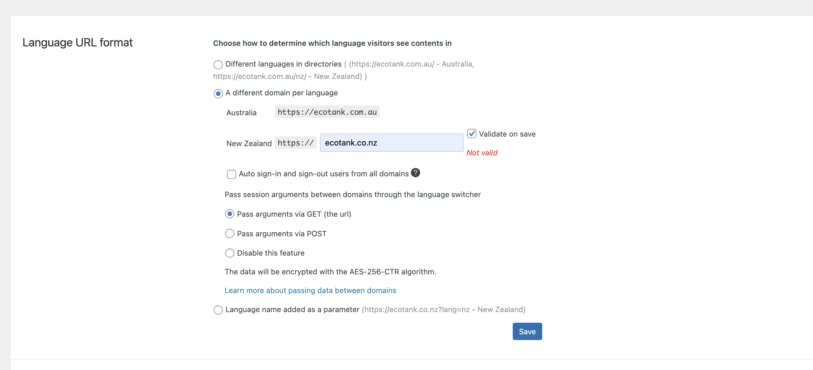

I am trying to use a different domain for our NZ site.
It is showing as not valid.
Why is the different domain for our NZ site showing as not valid?
June 24, 2024 at 4:05 am #15801536
madeleineW-3
The domain was previously working but the support person I was previously working with suggested I change to use "Different languages in directories" to test as there was an issue with the domain not showing the content.
I did this and then we have fixed the NZ domain so it points to the AU hosting but now when I try and switch back to using different domains per language it doesnt work.
Could you help us toubleshoot this?
Madeleine

Hi Madeleine,
there is currently an active redirect to the .com.au domain:
HTTP Headers
>>> <em><u>hidden link</u></em>
> 301 Moved Permanently
Status:	301 Moved Permanently
Code:	301
Connection:	close
x-powered-by:	PHP/8.2.20
content-type:	text/html; charset=UTF-8
x-redirect-by:	WordPress
Location:	<em><u>hidden link</u></em>
content-length:	0
date:	Mon, 24 Jun 2024 06:59:30 GMT
server:	LiteSpeed
Please remove this redirect. Once you can access a file like hidden link without being redirected, it will save valid.
For more information, you can refer to this guide https://wpml.org/documentation/getting-started-guide/language-setup/language-url-options/how-to-use-wpml-with-different-domains-per-language/#2-configure-the-dns-settings.
Marcel
