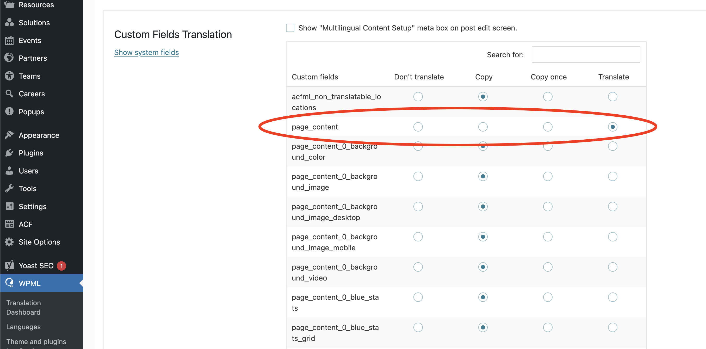

I have managed to isolate the issue (or one of the issues) in a reproducible way! I think the problems are related to the fact that this is a multisite using ACF fields synced with JSON.
"Can you please change the setting in the ACF settings, save, then change it back and save. Then visit the WPML settings page and check if it's OK now." This worked to fix the WPML settings page.
However, by re-saving the ACF fields on one site, the other sites in the multisite network show "Sync available" on the ACF page since the JSONs' modified time is now newer. If I run the sync on one of those sites, then go check the WPML settings page on that site, the page_content field is set to translate for some reason. So I have to go to the ACF page, change-save-unchange-save again, and that fixes the WPML settings page but of course triggers all other sites to show "Sync available" again. So it's an endless circle.
And the issue where pages seemed to "fail" translating seems to occur when I try automatic translations not realizing the page_content field had been set to translate instead of copy, due to the syncing issues.
With this in mind, would it still be helpful for me to enable debug? I wonder if this is a quirk with how this multisite/ACF is set up. Even though it uses JSON syncing, it does not utilize the default acf-json folder to do so, but a custom mu-plugin folder instead, which I suspect is the reason why the attached image doesn't seem to do anything when I try it.
January 29, 2026 at 8:39 pm #17775198
Otto
WPML Supporter since 09/2015
Timezone: America/Argentina/Buenos_Aires (GMT-03:00)
Thanks for the investigation and detailed report.
Yes, I think that the mu-plugin folder can be the root cause.
WPML/ACFML doesn’t “scan your server for JSON files anywhere”; it relies on what ACF reports as its Local JSON load points (the folders returned by ACF’s acf/settings/load_json logic). If your multisite uses a custom mu-plugin folder for JSON and that folder is not registered consistently and early (or differs per subsite / load order), then ACFML can end up:
- not seeing the same JSON definitions you think it should,
- or seeing them in a different order
Is it possible for you to check this hypothesis (I don't know the specifics of your setup)? I can provide a fresh multisite install if needed to test it from scratch.

January 30, 2026 at 6:50 pm #17779297
Otto
Thanks.
I think a WPML XML config file can help a lot here, specifically as a “lock” so the page_content field can’t keep flipping between Copy and Translate when ACF JSON sync / ACFML scanning runs:
Right now, your problem is not “how do I translate this field?”, it’s “the translation preference keeps getting overwritten by the Local JSON / multisite sync behavior”. A wpml-config.xml can make WPML treat specific custom fields with a fixed rule, regardless of what ends up shown (or temporarily mis-shown) in WPML → Settings → Custom Fields Translation.
https://wpml.org/documentation/support/language-configuration-files/
Can you please try this:
Create (or update) a wpml-config.xml in the active theme and force the rule for the field key you care about:
<code
<wpml-config>
<custom-fields>
<custom-field action="copy">page_content</custom-field>
</custom-fields>
</wpml-config>
[/php]
That tells WPML: for the meta key page_content, always copy.
Let me know if this helps.
