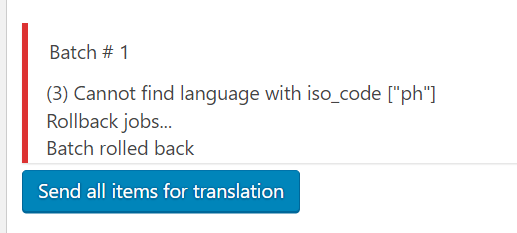

When sending an XLIFF to MemoQ we get an error as in the attached doc:
Cannot find language with iso code PH.

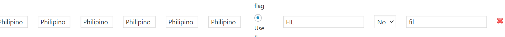

I can configure the language codes according to the ones in MemoQ.
Can you explain why do I still get such an error?
(attached are the error and the configuration)
I can see from your screenshot that you added "FIL" instead of "ph". if you change it to "ph" and try to resend the jobs, does it work?

The issue here is that you are trying to send memoQ a translation file with iso code PH, which is not supported by memoQ.

2- A screenshot from the languages page: Go to WPML -> Languages -> Edit Languages and send me a screenshot of this whole page to see the codes configured in the website and make the right mapping for your project.
