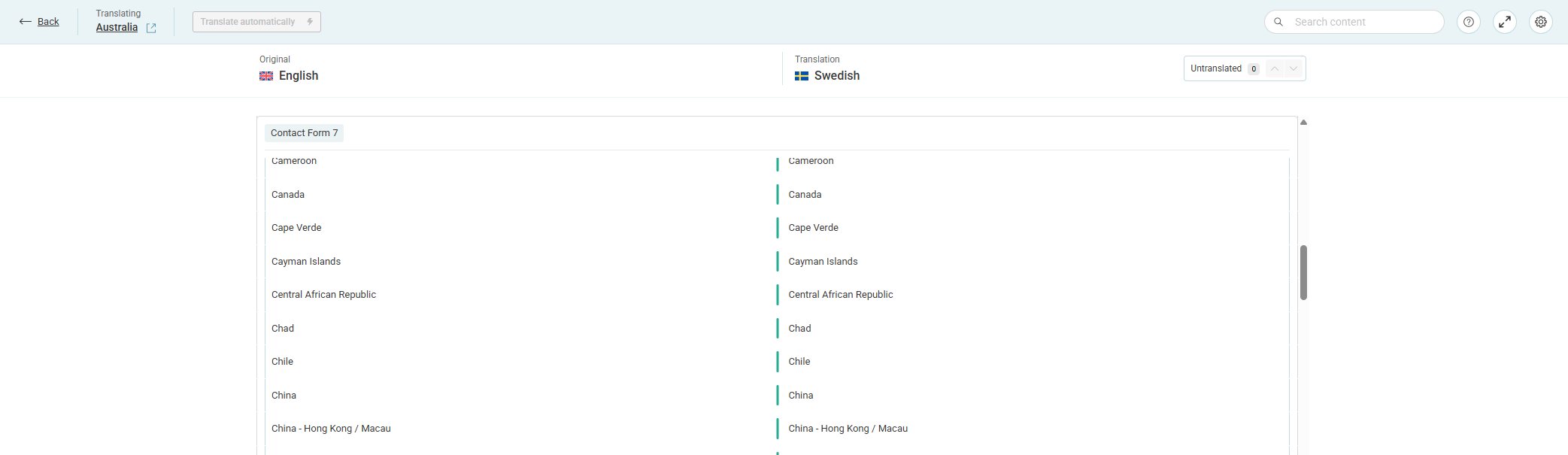

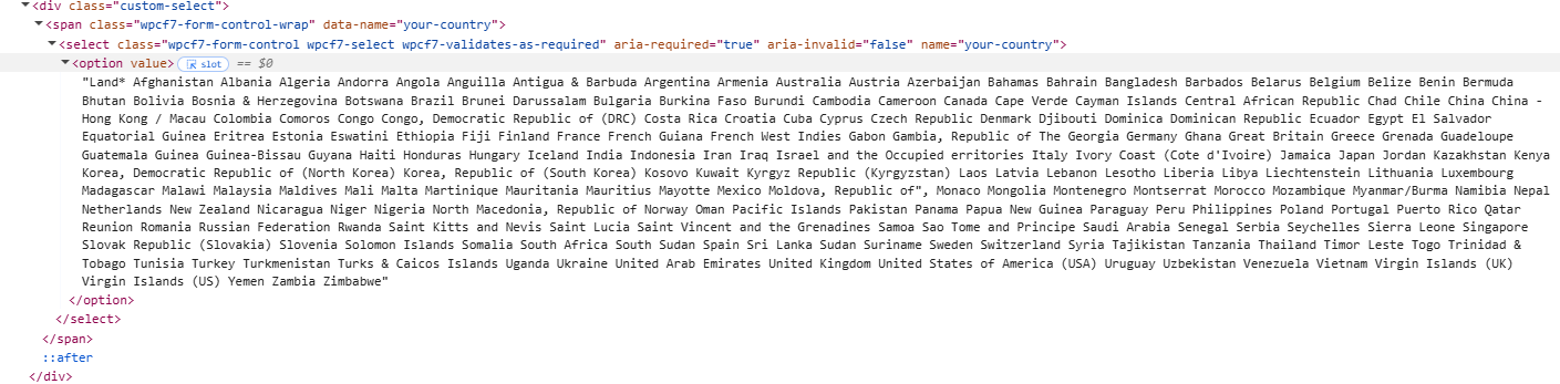

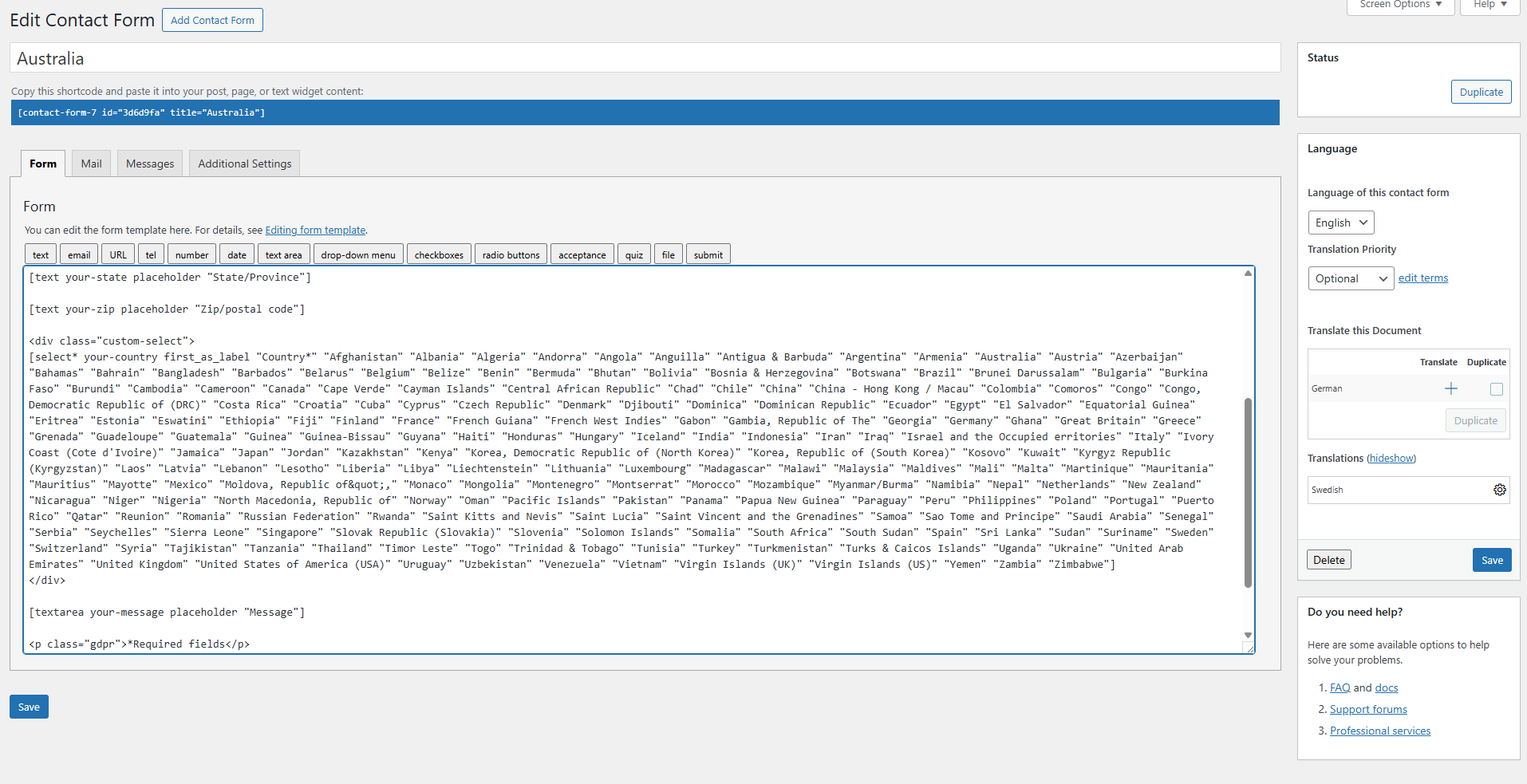

I believe I got the same issue as the following links, but the fix doesn't seem to work for me. I've disabled "I prefer bigger segments" inside ATE, but the options in the select still all go into 1 long line. See attached image

After changing the option "I prefer bigger segments" I've tried removing the translation for the form and adding it again, tried adding translation to a different form, but nothing works.
I'm using WPML Multilingual CMS version 4.8.6, WPML Multilingual for CF7 version 1.3.3, Contact Form 7 version 6.1.5.

I tried to replicate this issue on a fresh WP test site with WPML and CF7, but was unable to do so. Maybe it is something specific to your form's code or a problem in the translation process you took. You can see my translated form here: hidden link. The drop-down field to select a country is OK. But I might also be missing a step you did that I'm not aware of.
Could you please use the same code from your contact form on the test site and see if you can replicate the problem?
