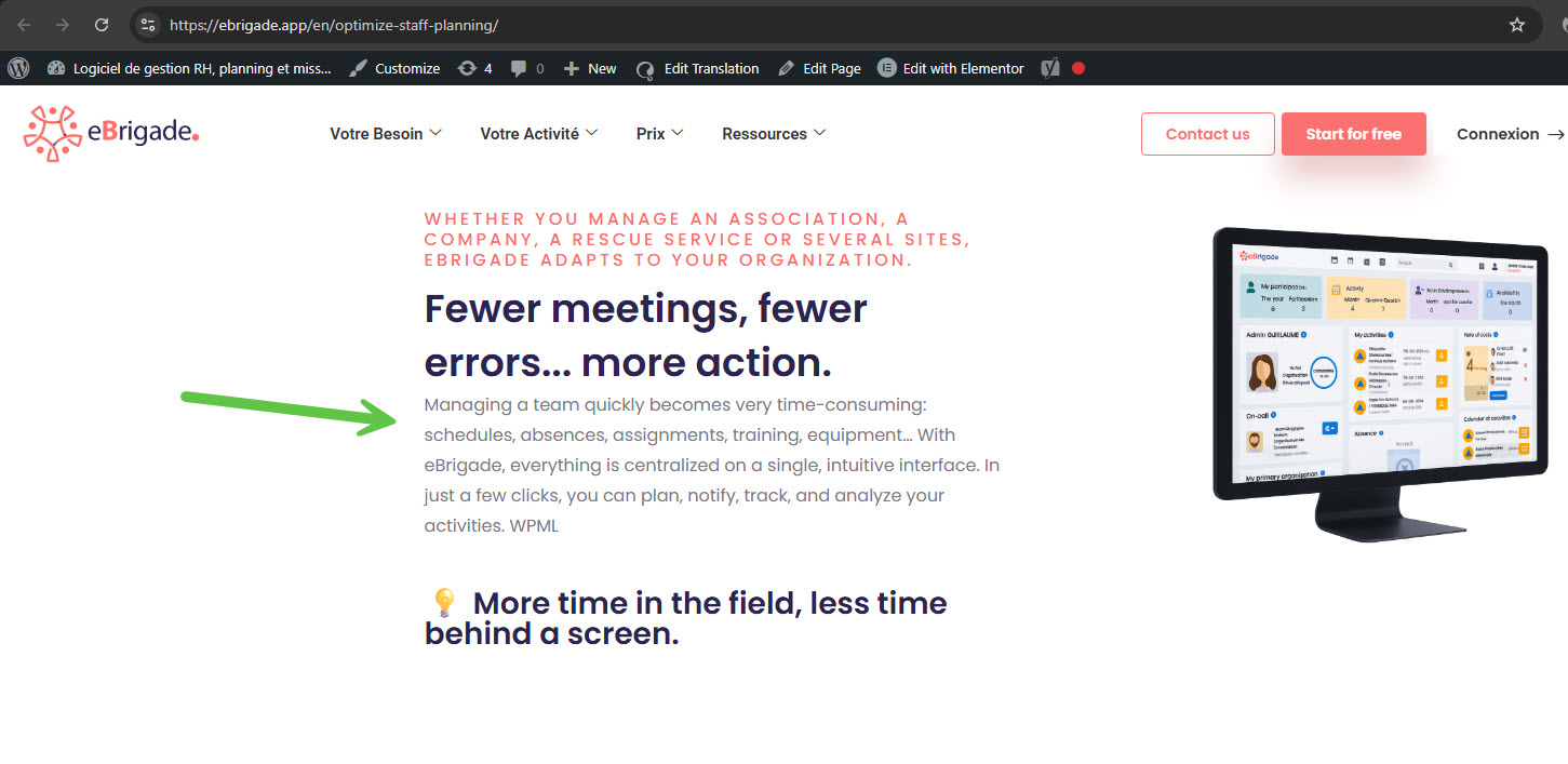

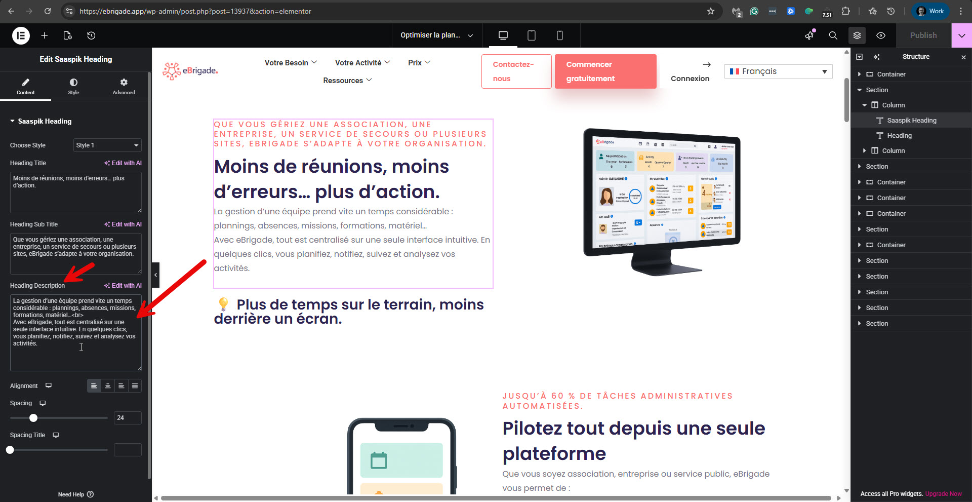

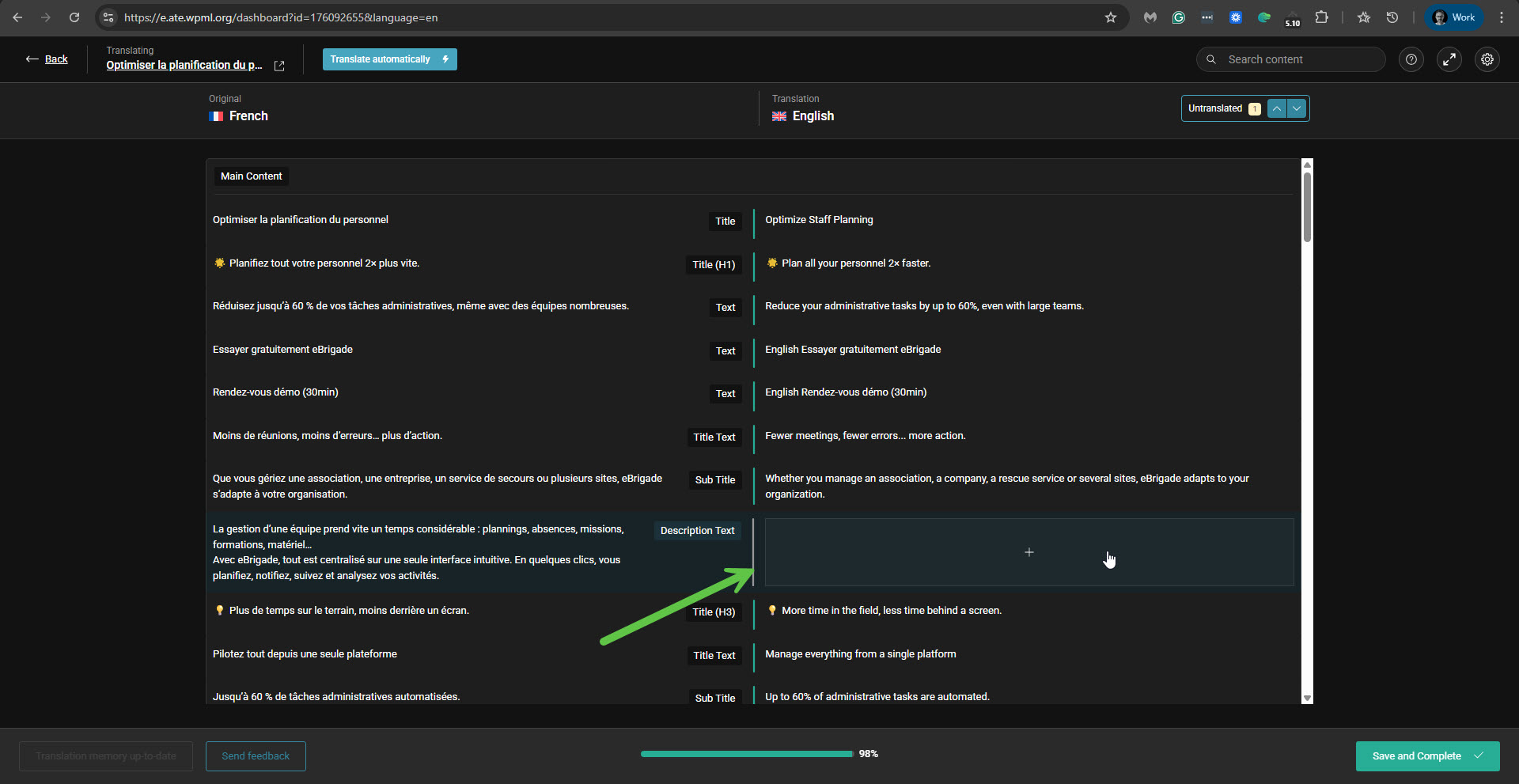

Let's take as an example some text that is not getting translated on this page:
I'm referring to this text:
La gestion d’une équipe prend vite un temps considérable : plannings, absences, missions, formations, matériel…
Avec eBrigade, tout est centralisé sur une seule interface intuitive. En quelques clics, vous planifiez, notifiez, suivez et analysez vos activités.
This text is coming from the Heading Description field of the Saaspik Heading widget. Please see the attached screenshot saaspik-heading.jpg. In WPML -> Settings -> Custom XML Configuration, I already added support for the Saaspik Heading widget. However, it missed the support for the Heading Description. It was like this:
    <widget name="saaspik-heading">
      <fields>
        <field>title_text</field>
        <field>sub_title</field>
      </fields>
    </widget>
But now that we have text in the Heading Description field, we can also add translation support for it, like so:
      <fields>
        <field>description_text</field>
      </fields>
After adding this, I went to the page's editing screen here: hidden link and ensured the translation was complete. If it is not completed, I complete it. It is important to do that because it was incomplete before I added the translation support I mentioned above. Now that it is complete, I make a small change to the original page and click the Save button. Now you will see the circled-arrow icon next to English. And now, when you edit the translation with the Advanced Translation Editor, you will be able to translate the heading description. Please see the attached screenshot, complete-trans-in-ate.jpg. If you check the frontend, you will see it is completed. Please see the attached screenshot translation-ofdescription.jpg. Now this was just an example. But it is possible that adding <field>description_text</field> will also fix other parts on other pages that are not translated. So you need to repeat what I explained on other pages. And if there are other Saaspik widgets without translation support, you need to add them.

6. Click the Save button to update the page.
7. Translate the page with the Advanced Translation Editor.
8. Add the HTML markers, as I show in the video below.
9. Complete the translations.
While trying this, I recorded a video. Please watch it here, as I hope it will help you understand what you need to do: hidden link
Please let me know if you have any further questions.
