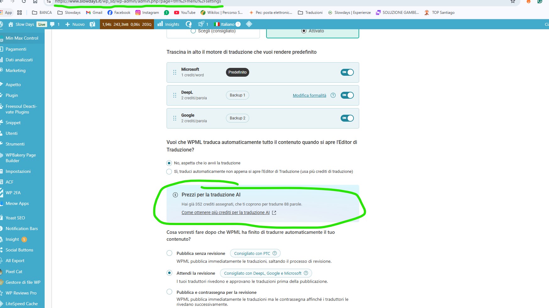

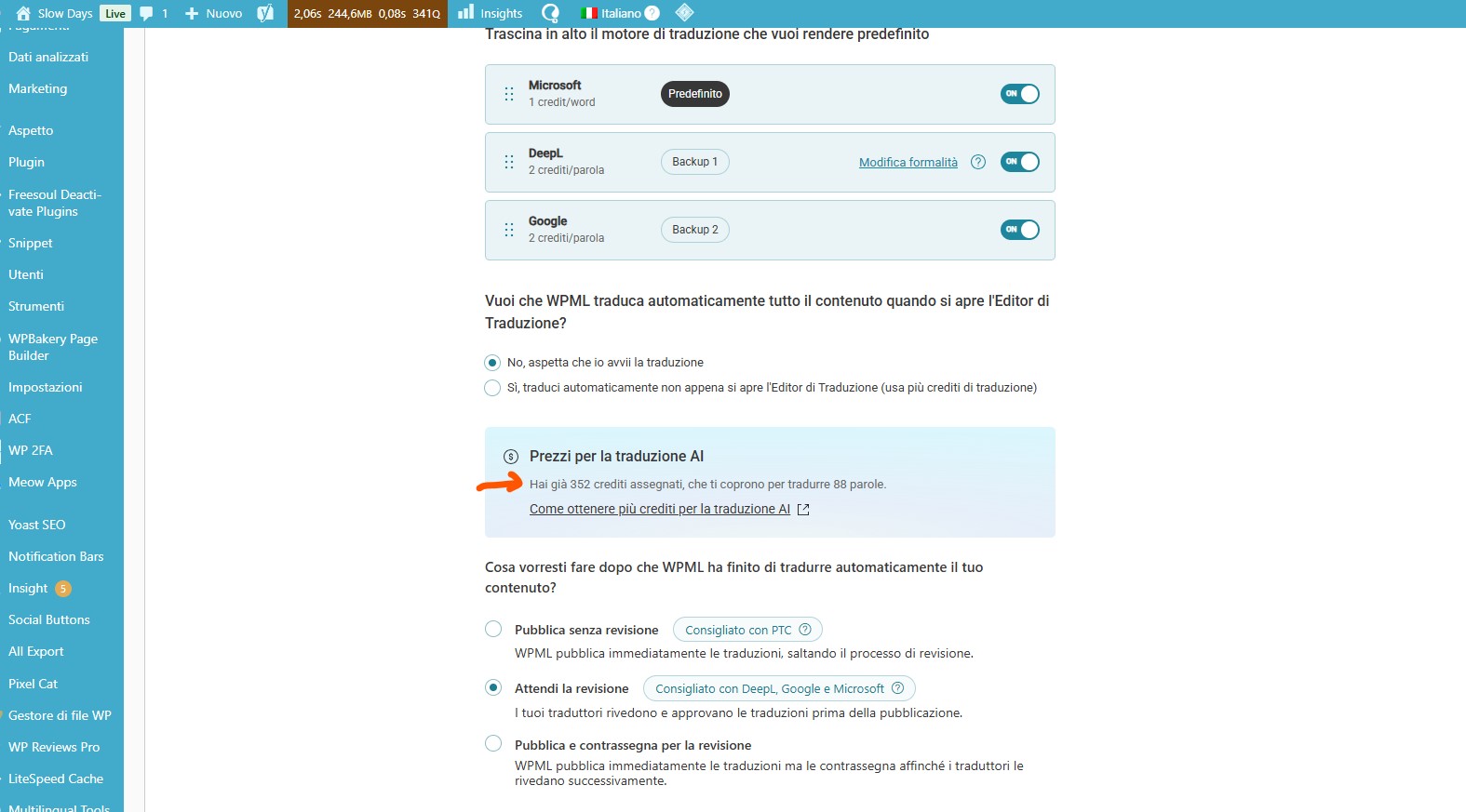

The client renewed their WPML license and received a total of 92,000 credits. Despite assigning these credits to their website through the WPML.org account, only 352 credits are visible and usable for translations in the WordPress backend under the WPML → Translation Dashboard → Translation Tools tab.

I renewed my WPML license. I received 90,000 credits + 2,000 free credits. I installed and registered the purchase key. However, I don't see the credits as usable in translations.

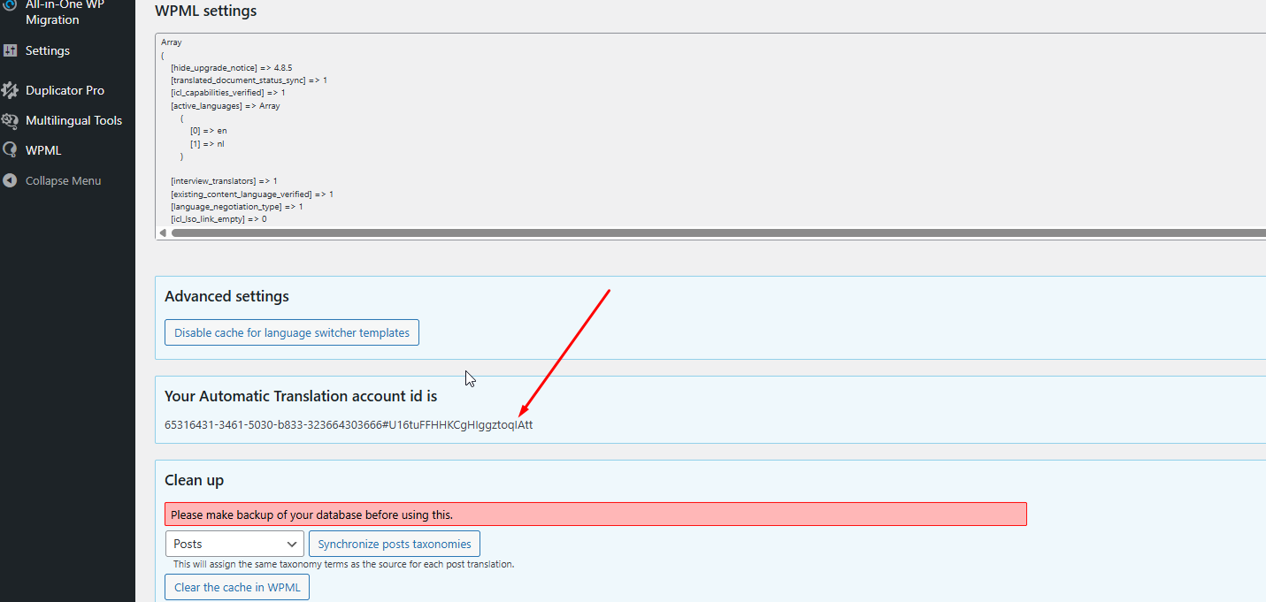

Thanks for your reply. I can see multiple registrations on our system here, and it's causing some issues over there. Could you please navigate to WPML > Support > Troubleshooting link > Copy and paste the "Your Automatic Translation account id is" number here so that I can check? It looks like the attached screenshot.
January 3, 2026 at 3:37 pm #17701545
claudiaG-4
Il tuo ID account di Traduzione Automatica è
34316264-6137-5532-a461-383439366431#ItO1Tr08HHO3vOTyKcLokgtt

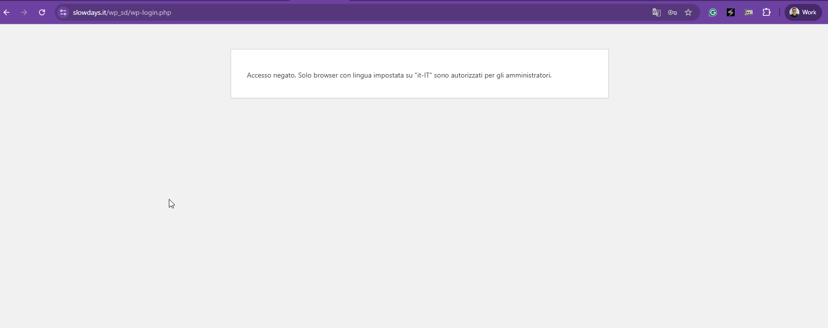

Thanks for your reply. I'm getting this login error "Accesso negato. Solo browser con lingua impostata su "it-IT" sono autorizzati per gli amministratori." as shown in the attached screenshot. Could you temporarily disable the security so that I can check?
January 5, 2026 at 3:00 pm #17704436
claudiaG-4
The admin area is protected by a rule that allows administrators only when the browser language is set to Italian (it-IT).
Could you please temporarily switch your browser language to Italian (it-IT) and try again?
If it still blocks you, I’ll disable the rule from the server-side. But I'm not sure that I will be able to do 🙁
January 5, 2026 at 3:23 pm #17704519
claudiaG-4
The issue was caused by a WordPress plugin that restricts admin access based on browser language.
I’ve temporarily disabled it so you can log in and proceed.
