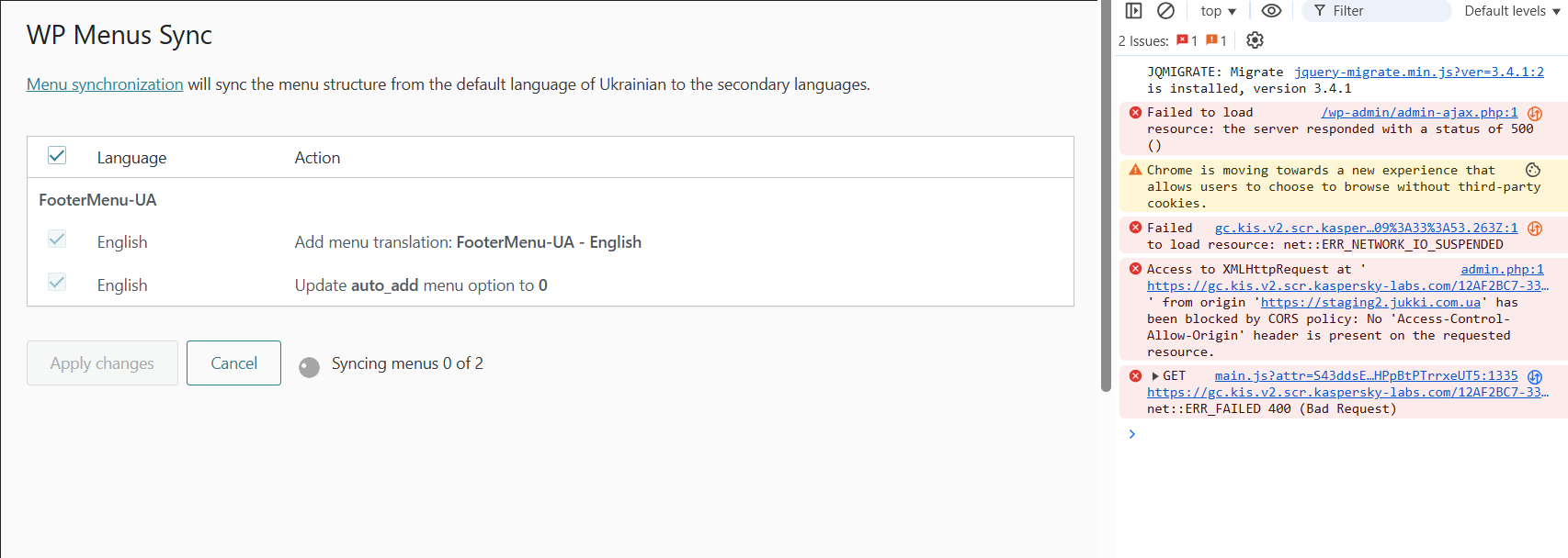

When I try to create a menu in the UA version to sync it with the EN version, I get a critical error, and no menu is created. Maybe it's connected?

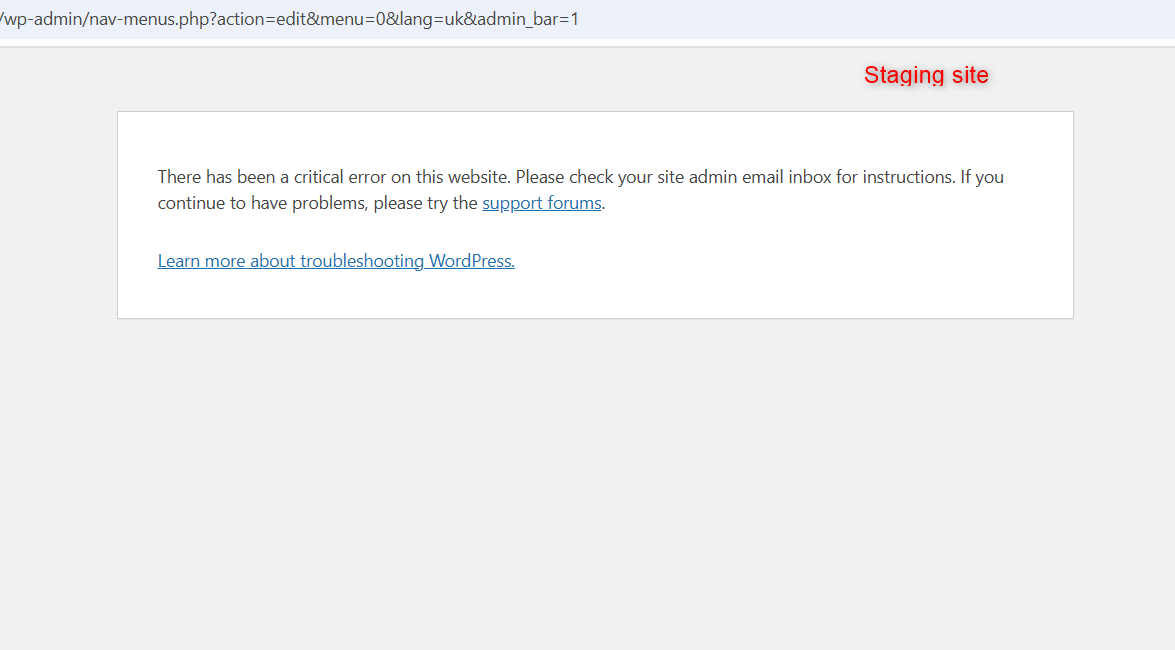

Thank you for the updates. I did a quick test on your staging site. Refer to the attached image. I hope this is the error you were referring to. Please verify, so we can proceed with further debugging.

Yes (I think) I could not sync nor create menu in UA

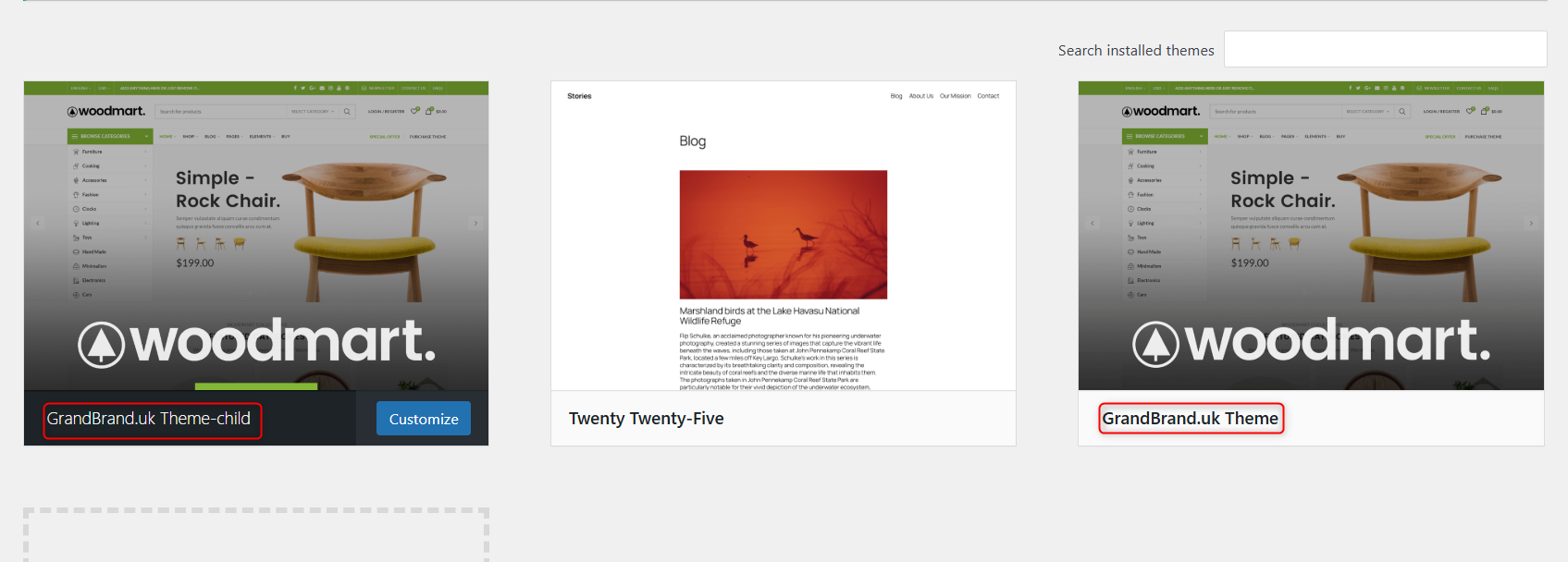

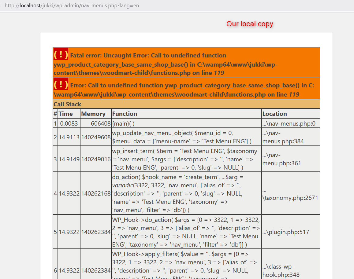

We have completed several rounds of testing and explored possible workarounds. It appears that the fatal error occurs when creating or syncing the menu, likely due to a conflict with the child theme.
We tested this after updating to the latest versions of the plugins and deactivating all other plugins except WooCommerce, WoodMart Core, and WPML, but the issue persists.
Could you please confirm whether you have renamed or made any changes to the parent theme? If so, we recommend downloading the latest version of the WoodMart theme, installing it on your staging site, and checking whether the issue still occurs.

That's the effect of the "White Label" option within the theme (even after update) so should not make the difference.
