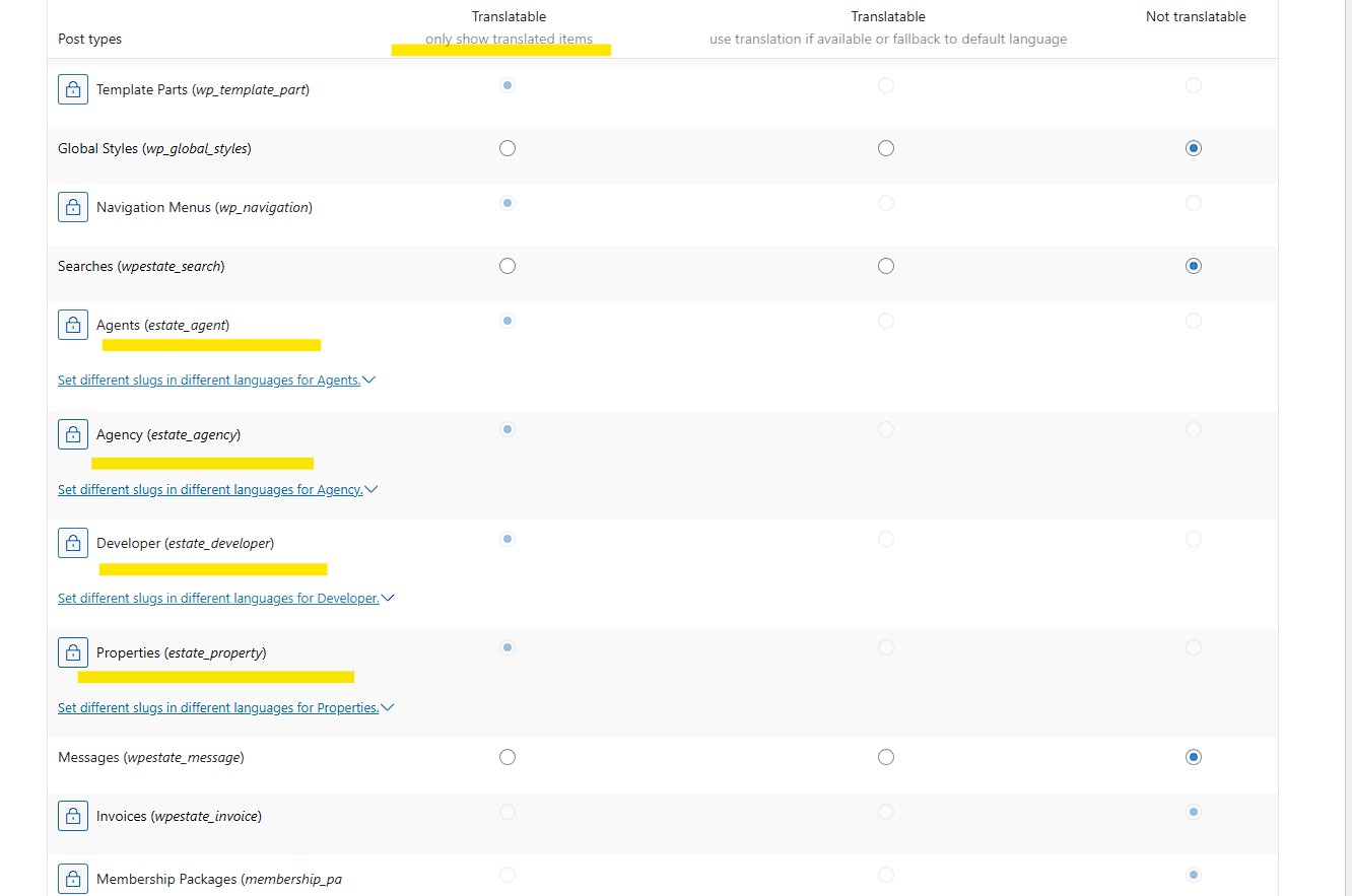

April 27, 2023 at 1:57 am #13545617
Please take note again that the issue that you experience on your site only occurs if properties are untranslated and the fallback option is used.
Now, on the sandbox if you go to WPML > Settings you will see that all Custom Post Types form WP Residence are locked and by default set to "Translatable - only show translated contents."
This means that the developers of WP Residence are including a pre-defined configuration for their post types and the fact that they are locked, means that you ar not supposed to change those settings, as you could experience unexpected behaviors.
This means the custom post types from WP Residence appear not to support the fallback options so it would not make much sense to keep replicating the issue, as this is already pre-defined by the author in this way.

Take note that the WP Residence Theme is using this setting inside the wpml-config.xml file in their theme:
<custom-types>
<custom-type translate="1">estate_agent</custom-type>
<custom-type translate="0">wpestate_invoice</custom-type>
<custom-type translate="0">membership_package</custom-type>
<custom-type translate="1">estate_property</custom-type>
<custom-type translate="1">estate_developer</custom-type>
<custom-type translate="1">estate_agency</custom-type>
</custom-types>
This means they define that those post types should use those specific settings.
Could you please ask them, if they do this on purpose as the post type would not support a fallback option?
Take note, that I will be glad to escalate this issue internally for you, but I think it would save time if you could first clarify with WP Residence if a fallback option should work with WPML for their post types.

Hi. this is answer from wp residence support:
Hi Marius,
Thank you for contacting us.
I got the Development Team's reply. We did not lock the elements intentionally. The WPML compatibility made the settings in the WPML config a while ago and this is how it stayed. we did not change it and it was not the case, until now. You should be able to make the changes that you want.
If WPML can provide the updated wpml-config, we can include it in our next theme version.
