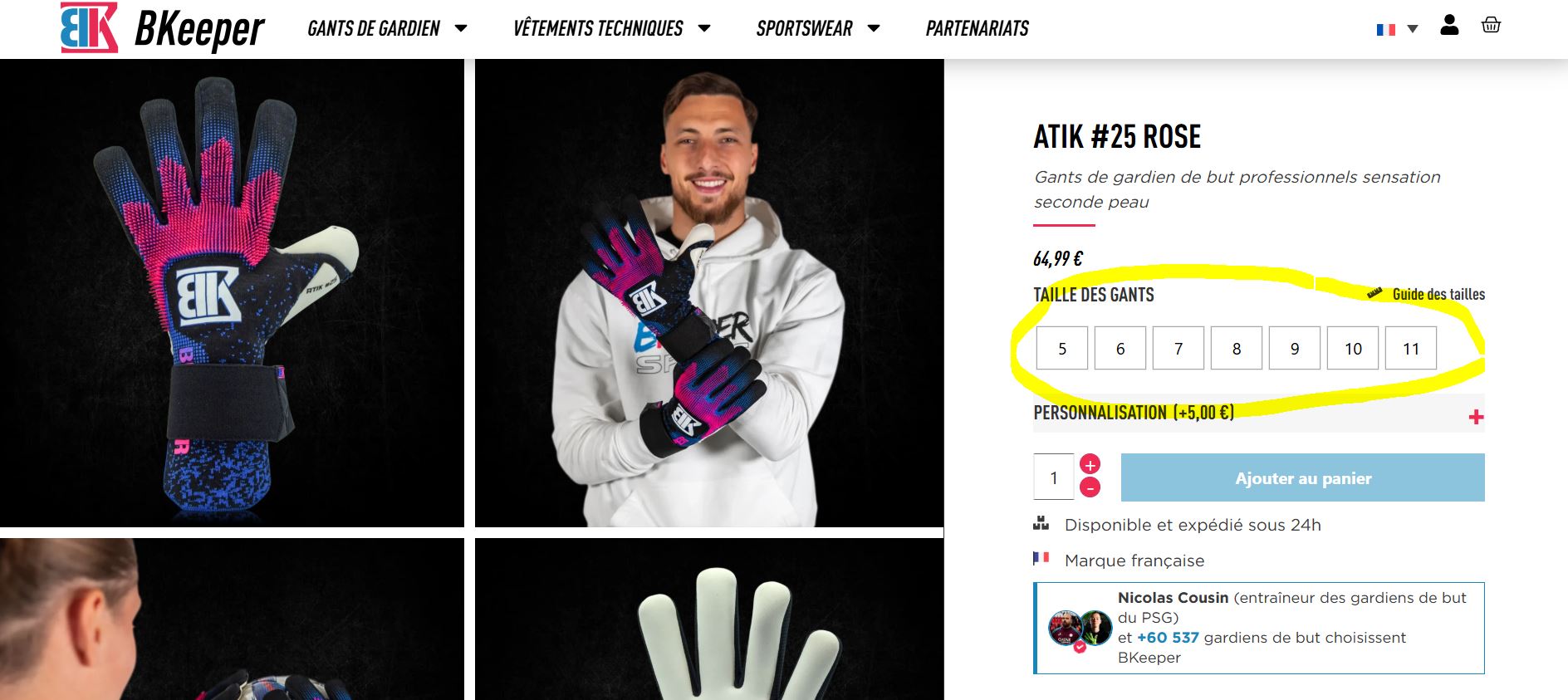

I suspect that the problem here is that the 'Taille des gants' terms (3,4,5,6,7,8, and so on) were created in French, the second language, and not in English, the default language. Please see the attached screenshot. I tested the same behaviour on my test site, and the problem occurs there as well. Fixing this problem would be creating those terms again in English and then updating the variations accordingly.

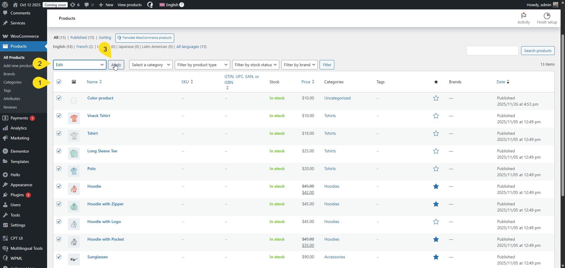

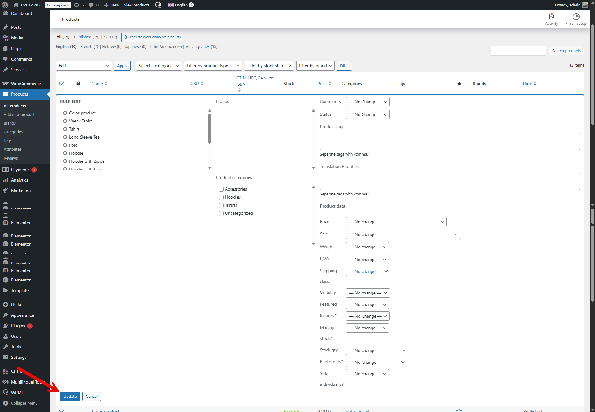

About your second concern, the need to update all the products. You can update all the products in bulk. To do that, go to Products -> All Products, and select all of the products that show on the screen. Then from the bulk action drop-down, select Edit. And then just click the Update button. Repeat this action if you have more products in secondary screens. Please see the attached screenshots.
