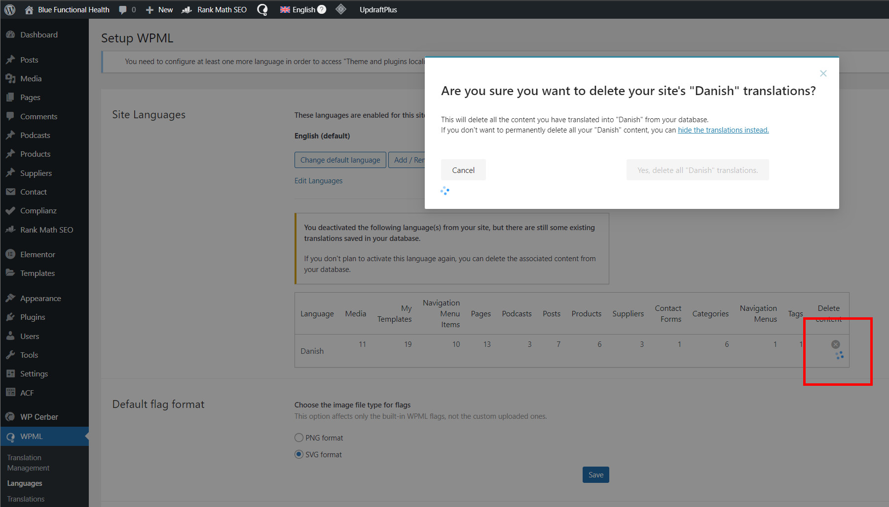

Following your instructions on how to delete and remove WPML from a site, the "Delete content" (red box in image) from the database routine is stuck. I've waiting over 30 mins for the process to complete, but it is just stuck. I've tried cancel and reclick the delete button. Same thing happens.
The document I follow: https://wpml.org/documentation/getting-started-guide/language-setup/deleting-languages-and-plugin-data-by-doing-a-wpml-reset-on-your-site/
I need to deactivate/remove all of WPML from this new dev site (subdomain), which is a fresh clone of a production server where WPML is currently working fine. On the dev site WPML is not needed.

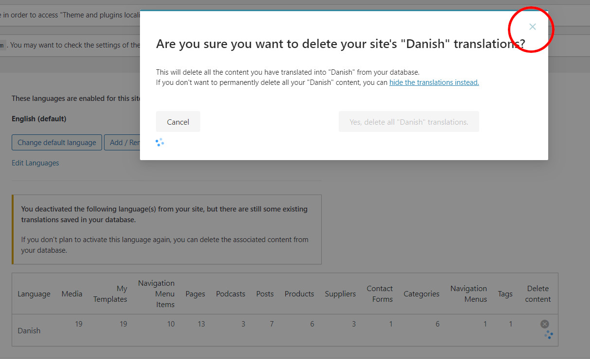

Didn't help. It still seems stuck when trying to delete the language (waited for 5 mins for it to complete).
April 23, 2024 at 11:10 am #15555440
thomasH-153
Don't know if it helps, but I can only stop the process by clicking the cross. Cancel is not allowed (shows a red "stop" icon).
