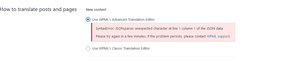

The problem showed here --> https://wpml.org/wp-content/uploads/2021/06/9013951-wpml_adv_trans_editor_json_error.png is happening because your server has REST disabled. please ask the hosting support to enable it IF you want to use the advanced translation editor.
If you want to use the classic translation editor then that is not needed but at this point there won't be issues at all with the translations 🙂
If you want to see everything that i did, you can check this video: hidden link
I also saw that your WPML URL format was set to parameters which doesn't work with Buddypress (as seen in the notification that would appear now about this): hidden link
I have already fixed that and made sure it worked.
Regards.

you seem to hv forgotten about this ...
https://wpml.org/errata/rest-api-is-disabled-blocking-some-features-of-wpml-notice-and-performance-issues/
and interestly enough, i installed the work-around suggeted - AND THE PROBLEM WENT AWAY!
also interestingly -
1. REST is NOT inactive!
2. the problem is YOUR code.
