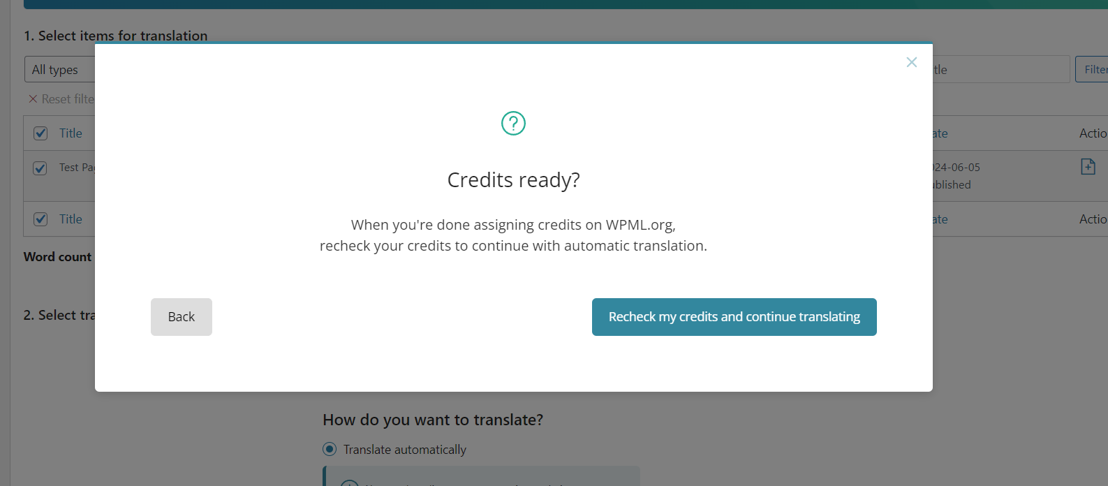

denisK-21
I'm trying to reproduce the problem, but I don't have credits for automatic translation.
I added a test page with a shortcode
