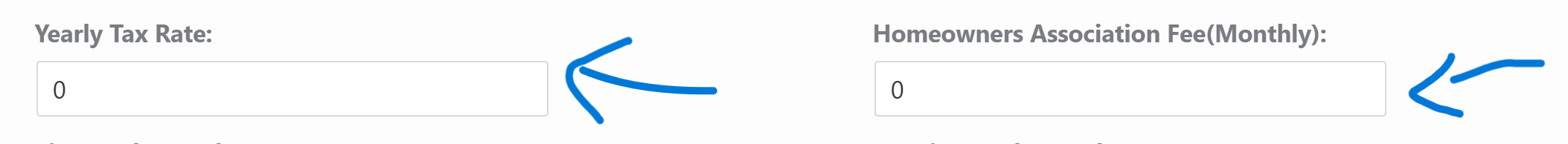

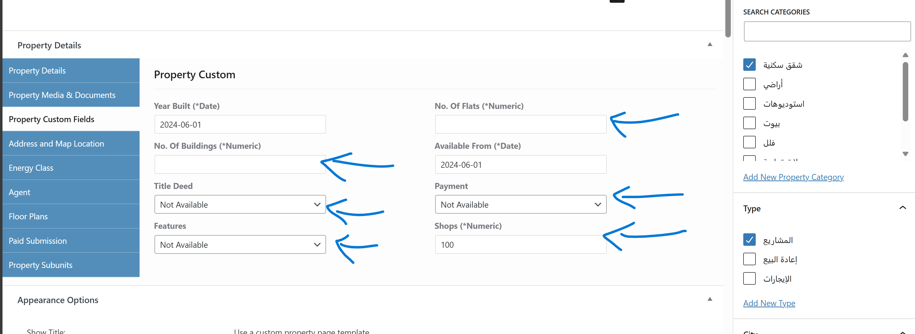

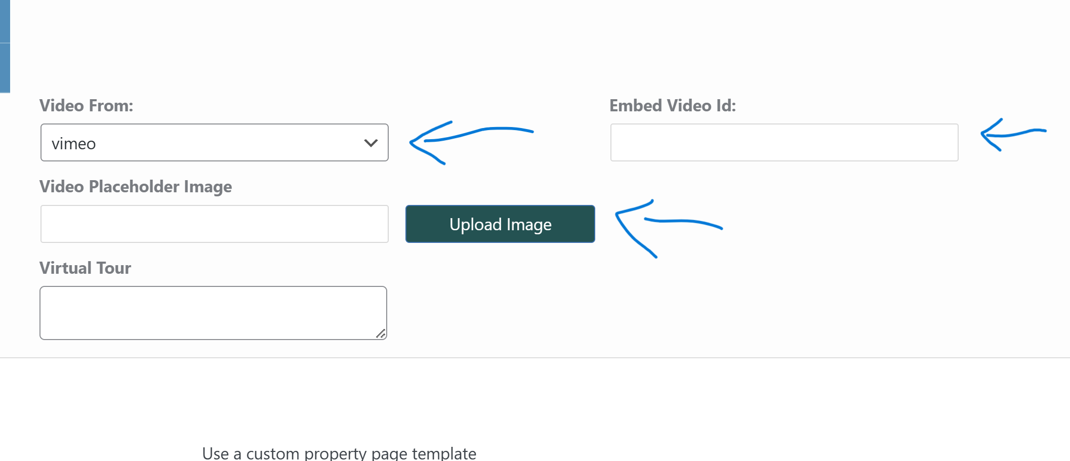

I am unable to copy this part. I have tried many times, but it didn't work. I have to add it manually for each property in every language. Could you advise me?

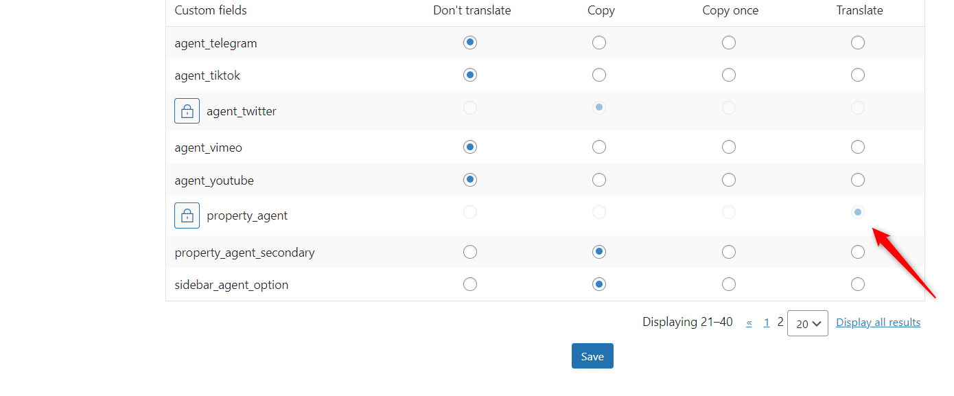

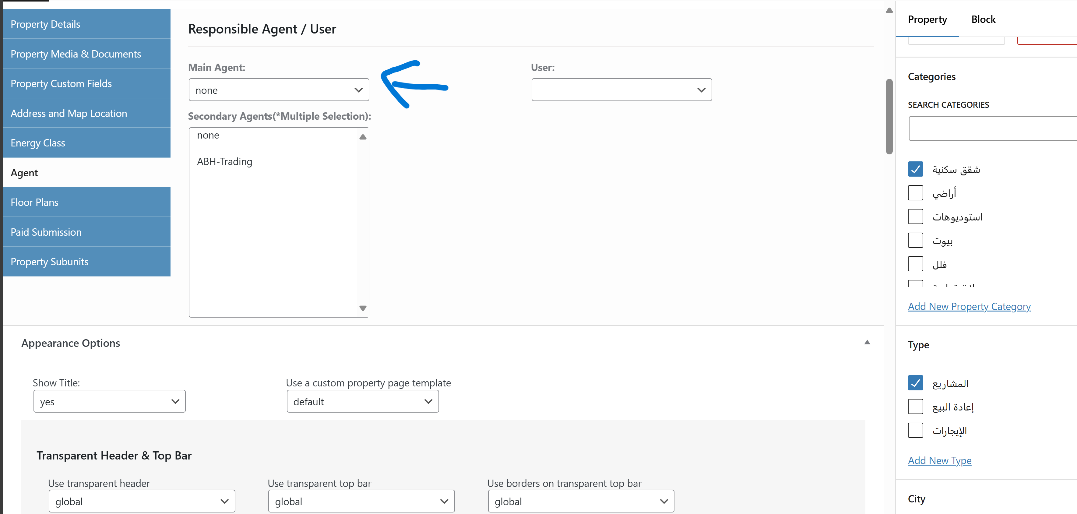

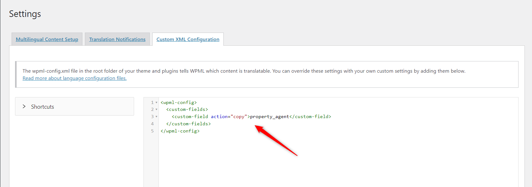

Thank you for the details and login information. I created a private Property post for testing and the issue is reproducible. The result is same after setting *property_agent* field as *Copy* via WPML language configuration. Because it is set as *Translate* by the theme author via wpml-config.xml. Please check the attached images for more details.
