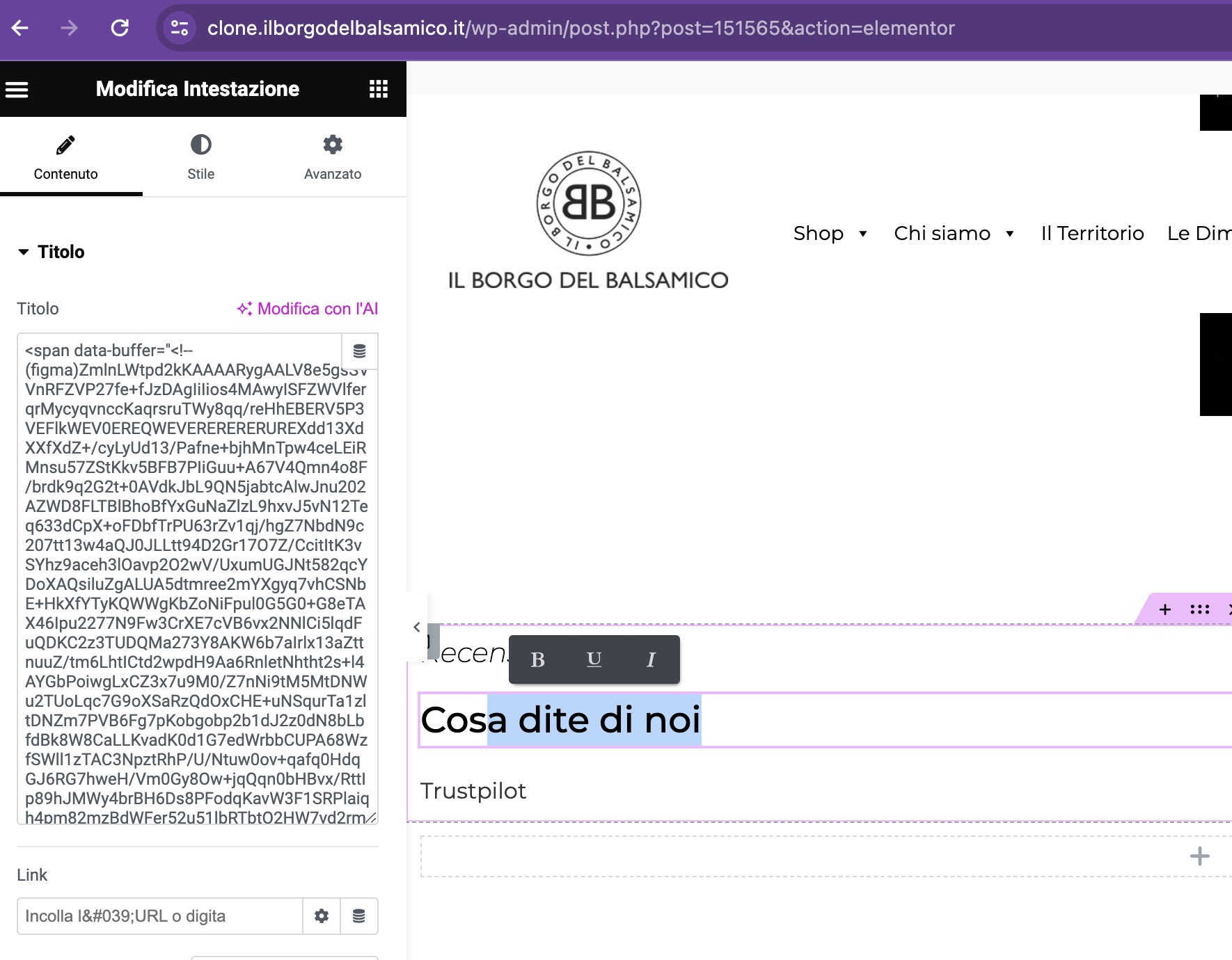

I could see this "strange text/code" here hidden link as shown in the attached screenshot. This is what's breaking the Advanced Translation Editor. Could you remove or replace it?
Please check your other pages and make sure you clean up these "strange text/code". Let me know how it goes.

the code you found was in "Home new" but is not in the other pages I listed; in any case, even by removing that code the translation doesn't work, at least for me.

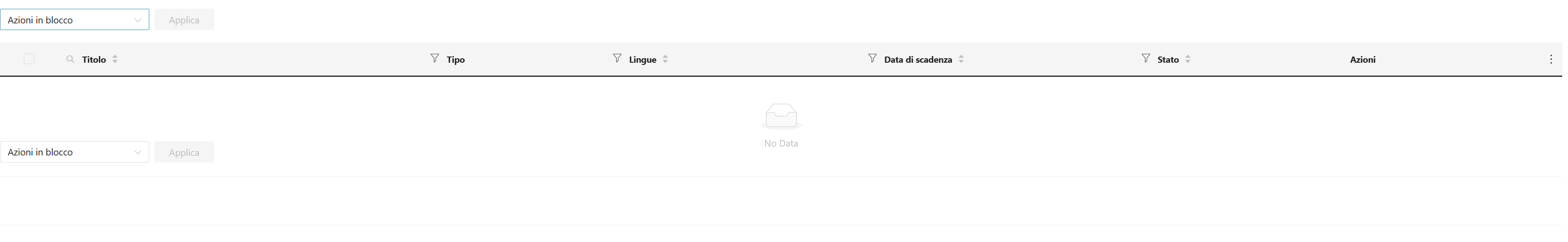

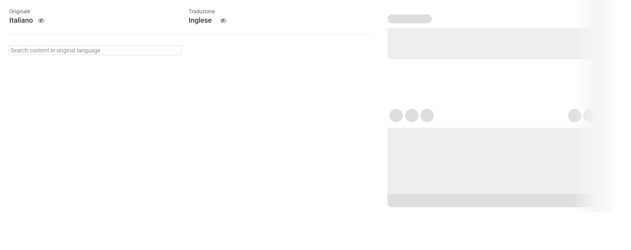

once I delete the suspicious text in "Home new" from the "all pages" table in wp if I click on the "gear" icon to edit the translation, wp tries to load the advanced editor but remains blocked as per the screenshot.
For the other pages, (Wine Vinegars / Aged Condiments) unable to find any strange code, however, trying to add or edit the translation opens the translation queue showing only an empty "No data" table
I attach screenshots
