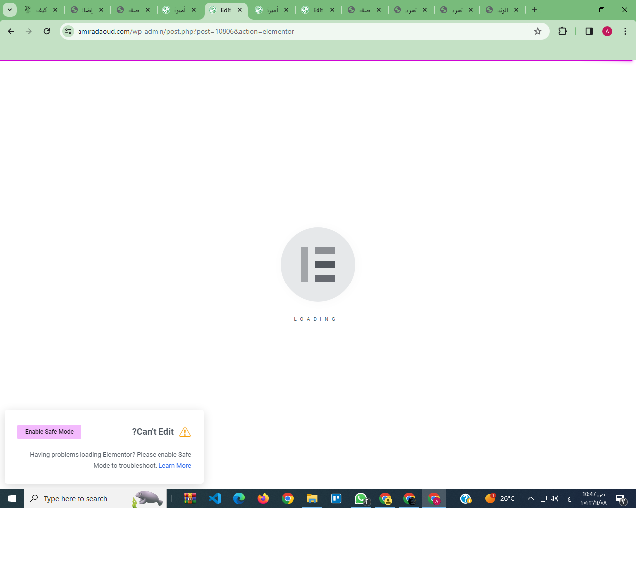

netarowB
"I have an issue with translation. When I duplicate any page and start translating it to English independently, Elementor gives me a white page. Also, when I try to open any translated page, it redirects me to the original language, which is Arabic."
sample page of the issue: hidden link

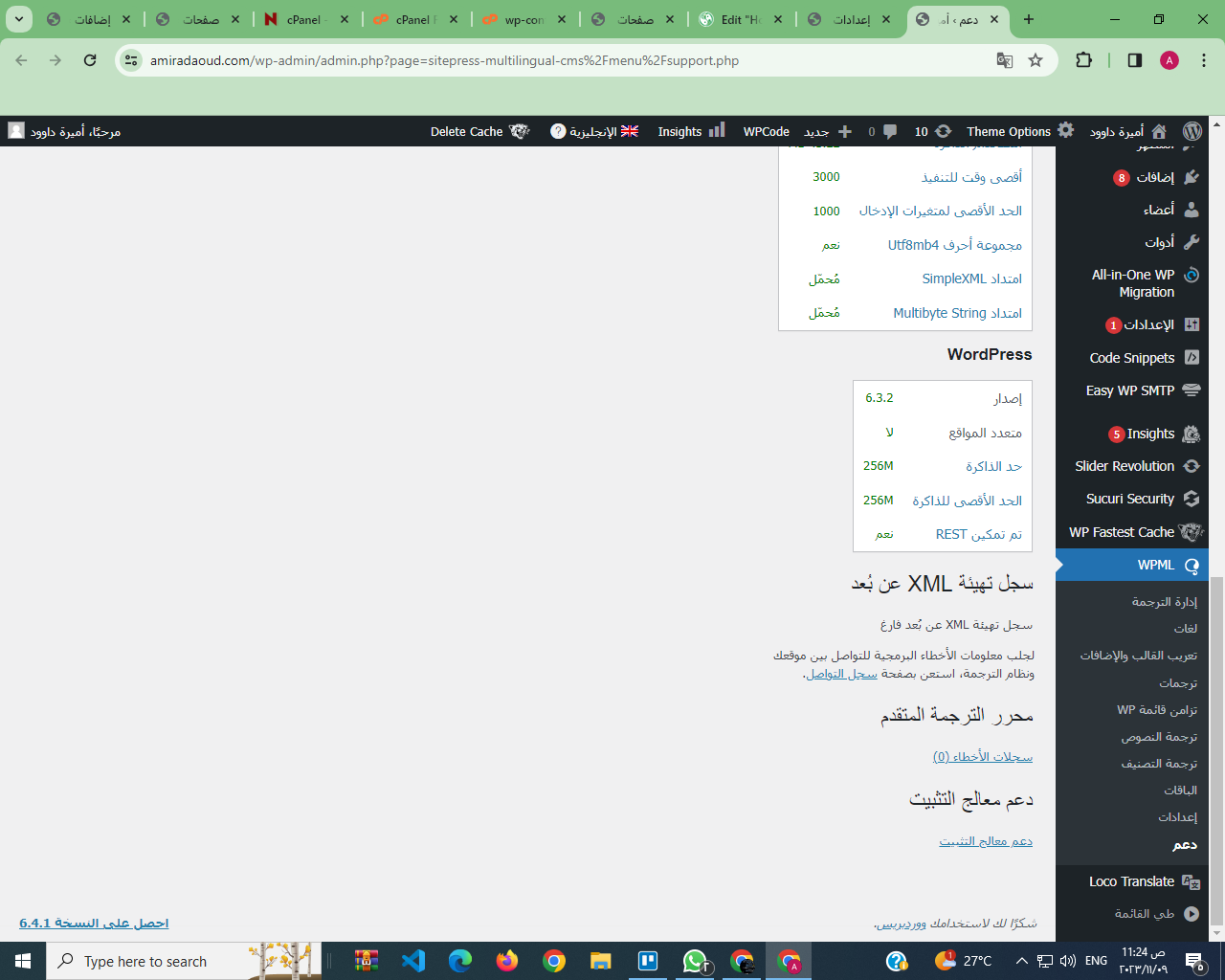

November 9, 2023 at 9:25 am #14763833
netarowB
I have incresed the memory limit to 256m
but the elementor gives me the same error
