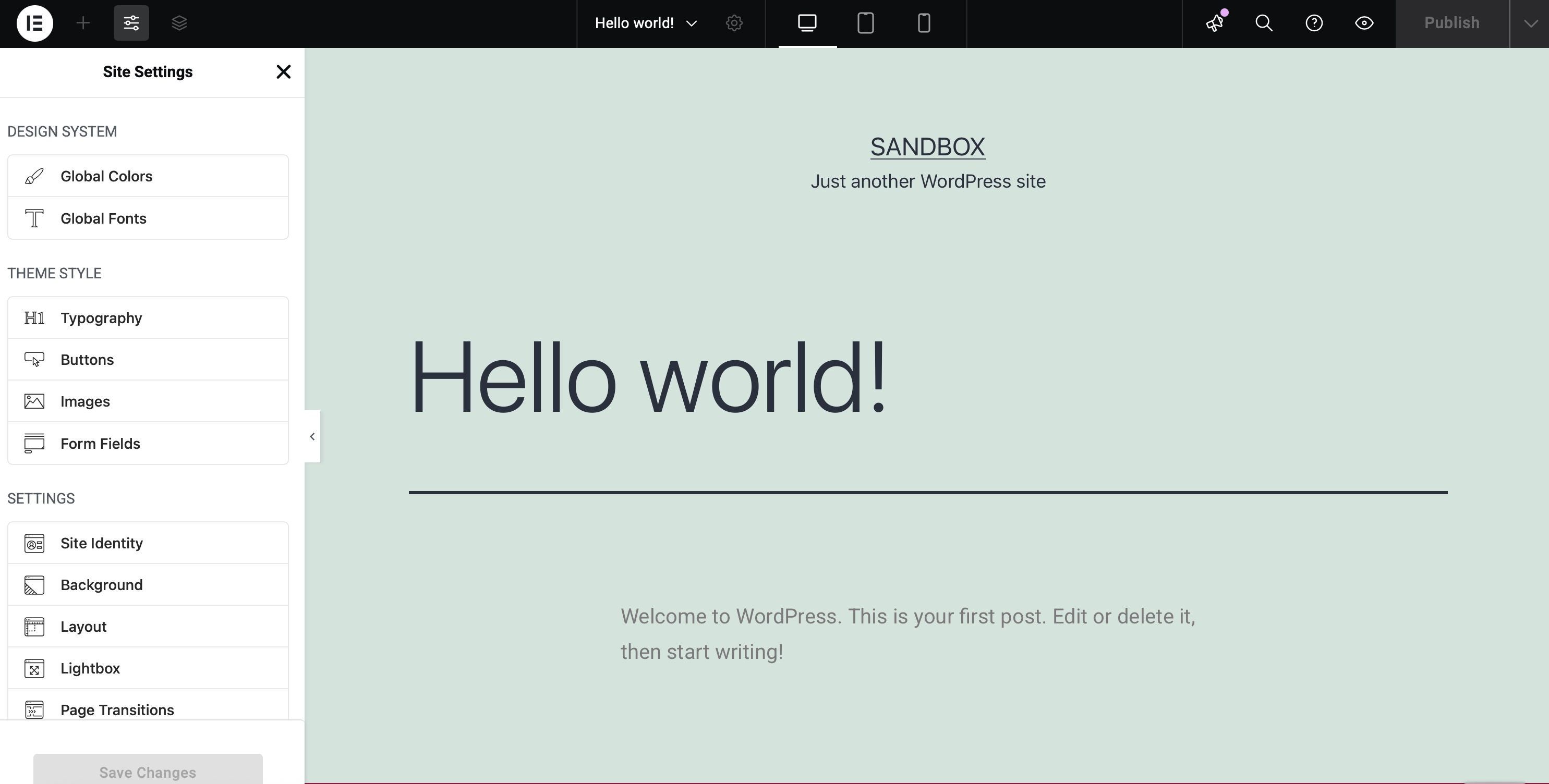

Okay, but again, the link leads me to Elementor using containers instead of sections. Mine is set as sections only. Are you sure it will have the same results?
April 24, 2025 at 5:02 pm #16965636
Lauren
no, I'm not sure it will have the same results but you are welcome to change to using sections instead of containers.

April 24, 2025 at 10:29 pm #16966447
ronaldT-5
I can't find any of the options on your list, from #1 to #4.

You need to go to Elementor -> Settings -> Features. I can see the Container setting there. hidden link
April 25, 2025 at 3:09 pm #16969320
ronaldT-5
Oh, from the WordPress dashboard, and not from within the Elementor editor! It should have been step 1. I missed it otherwise.
