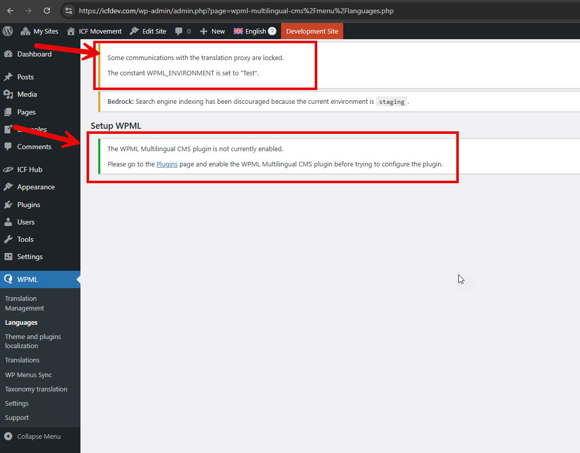

You are using a WordPress multisite installation; however, WPML is not enabled on your multisite system. Please see the attached screenshot. To learn how to work with WPML in a multisite environment, please read our guide here:
https://wpml.org/documentation/support/multisite-support/
Moreover, there is a message saying this:
Some communications with the translation proxy are locked.
The constant WPML_ENVIRONMENT is set to "Test".
Can you please explain what the WPML_ENVIRONMENT constant is?
It is not one of our contents. You can see the list of our constants here:
https://wpml.org/documentation/support/wpml-coding-api/wpml-constants/
There is a strange situation on your site where WPML is not enabled. However, the WPML admin menu is displayed. I suspect that your WordPress site has some custom configurations. Do you know about any such configurations?
Itamar.
April 22, 2025 at 7:51 am #16953467
benjaminA-35
the plugin is now enabled on the multisite blogs and the WPML_ENVIRONMENT variable is now removed. The site is also correctly registered in the multisite settings ( see screenshot ). To my knowledge we don't have any custom configurations currently active that could affect WPML.

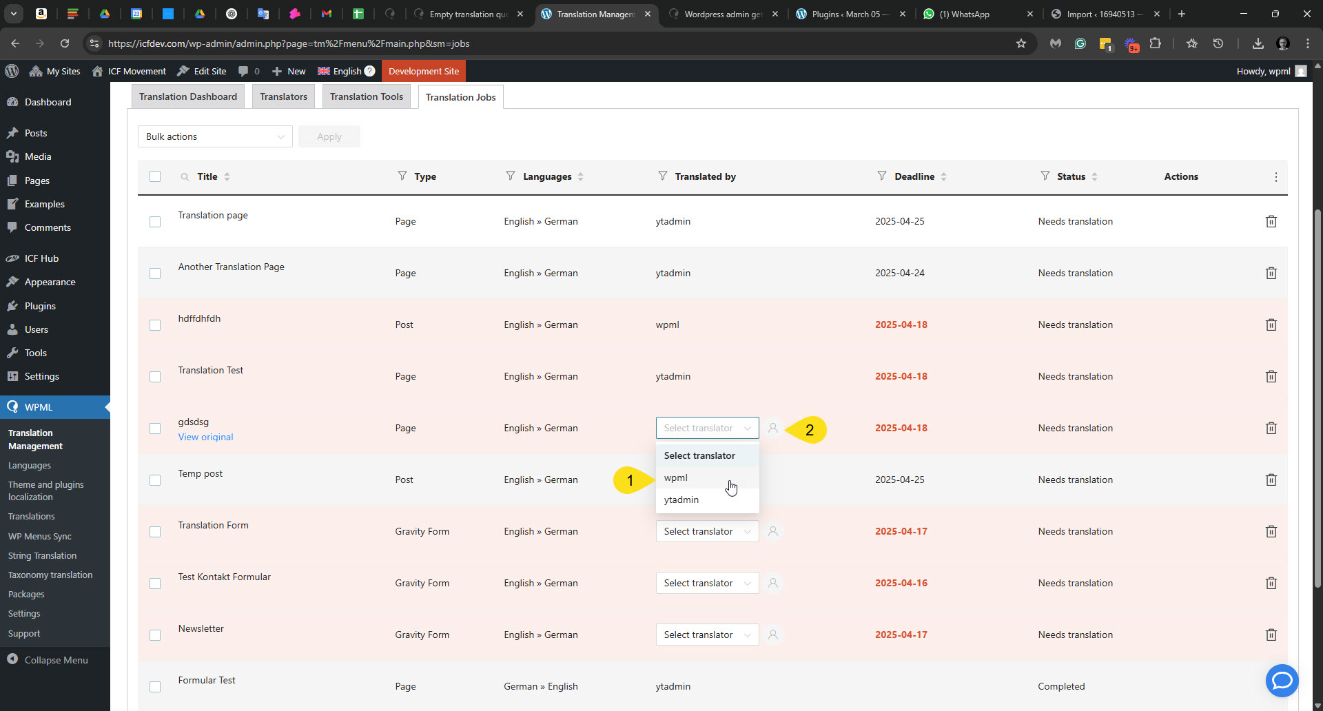

I can see the problem on your site. In WPML -> Translation Management -> Translation Jobs, I assigned one job to my user, 'wpml'. Please see the attached screenshot. And then in WPML -> Translations, I can't see it.
I checked the Advanced Translation Editor Error Logs and found this error:
Api error missing resource: No sitekey found for this website
I have checked our system, and it appears that you are using an outdated site key.
The current relevant site key is: AcIwbmVifh
Can you please register the site with the above key?

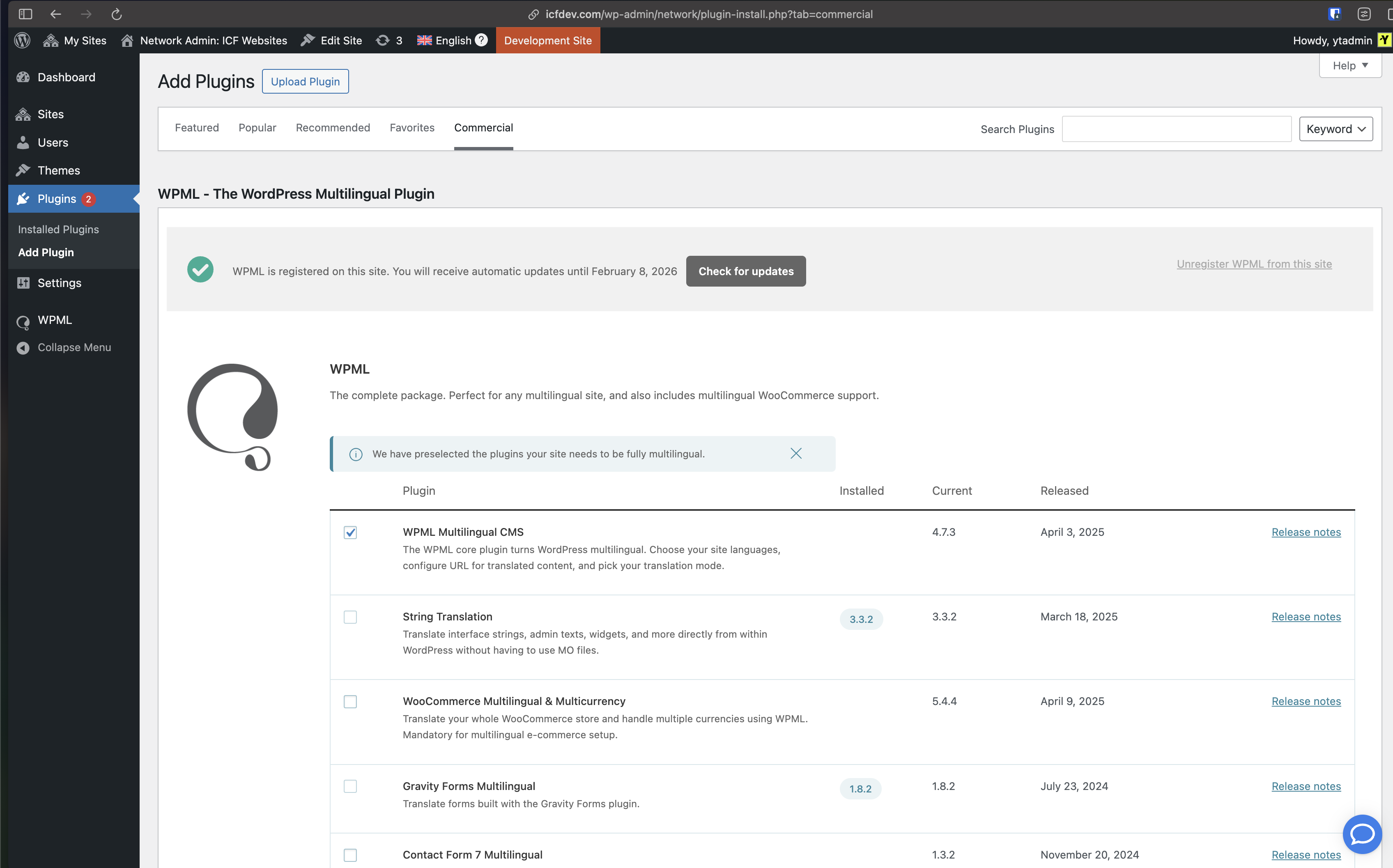

April 24, 2025 at 7:41 am #16962863
benjaminA-35
i have now recreated the sitekeys and reregistered them in the multisite settings under Plugins > Add Plugin > Commerial. The new sitekey for icfdev.com is 7dZVcZ86hs. Did i miss something?
Regards

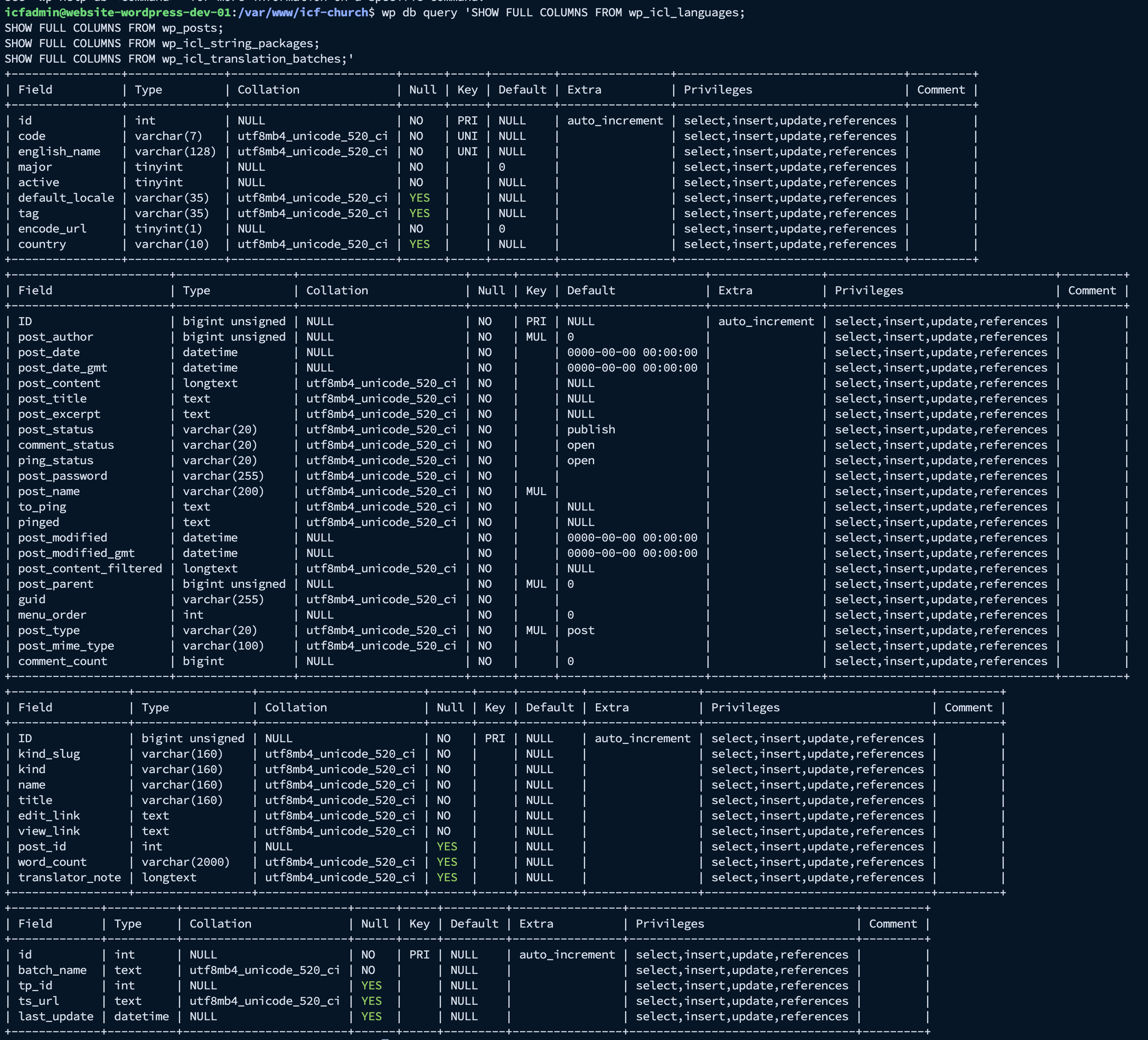

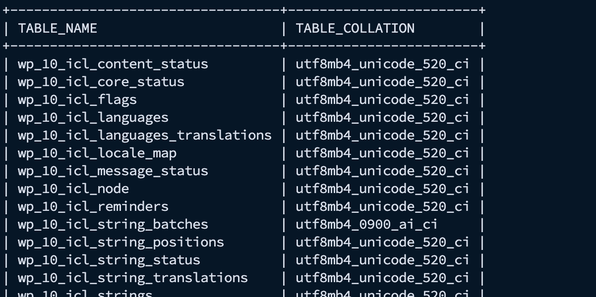

May 6, 2025 at 7:12 am #16999447
benjaminA-35
I have executed the first command from the other ticket to check whether the collation mismatch is present here as well.
The tables "wp_icl_languages", "wp_posts", "wp_icl_string_packages" and "wp_icl_translation_batches" seem to have the same correct collation.
When outputting the collation of all tables containing _icl_ in the name, I have found that the wp_icl_string_batches table has another collation. I am not sure if that is intended though.
(see screenshots for both)
Regards
May 6, 2025 at 7:44 am #16999569
benjaminA-35
Edit: I have now changed the collation of the wp_icl_string_batches tables to the desired utf8mb4_unicode_520_ci via the command of the other ticket. Unfortunately this seems to have no effect when checking the queue in wordpress again.
