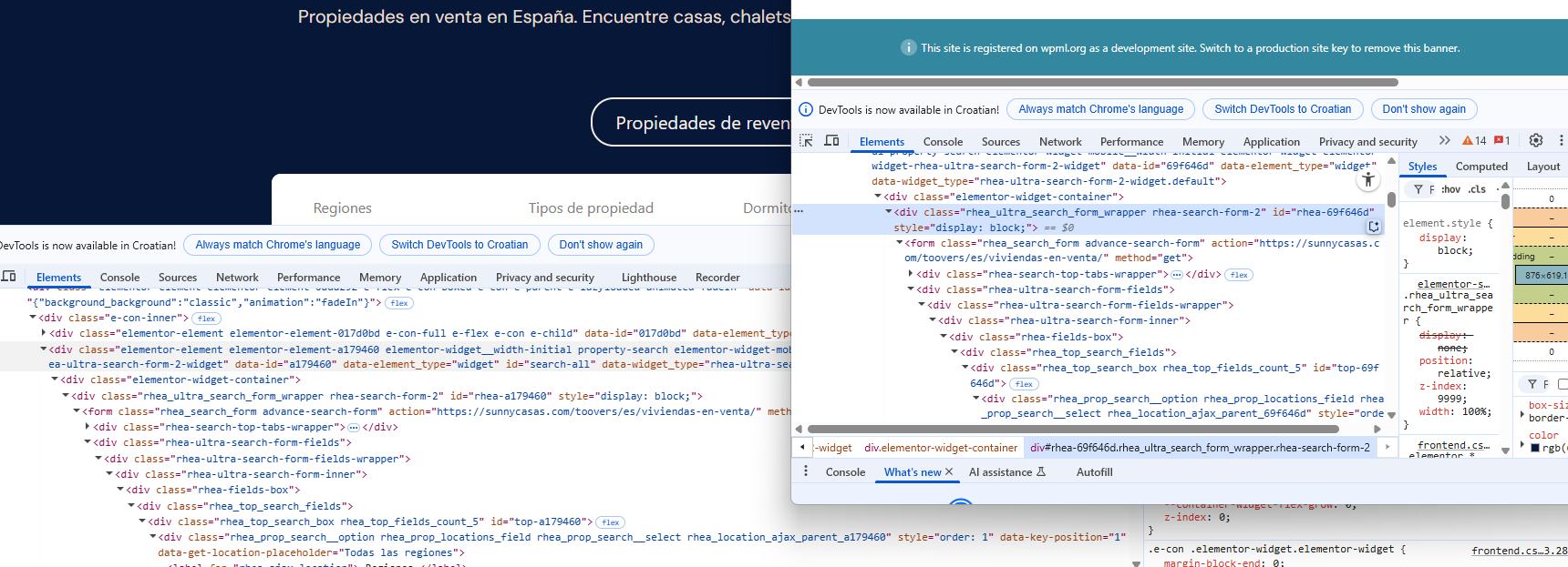

Is a different form being used on this page? Could you also let me know if there is a template assigned to this page, category, or property search—and if so, whether both the template and the form are translated?
https://wpml.org/documentation/plugins-compatibility/elementor/#how-to-translate-elementor-with-wpml
