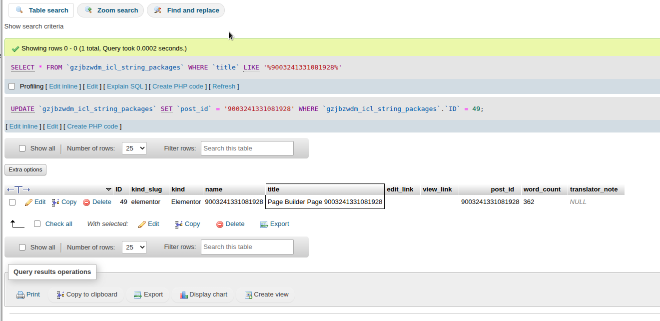

The problem was the string package. Since DB had some tables corrupted from before, it also caused some entries to be corrupted.
We had to run actions to make the post_id the same as the actual ID, image attached. So for ID 49 we set post_id the same as the name value.
Then we saved the page and reopened it ATE - the translation is now available and translated.
Drazen
