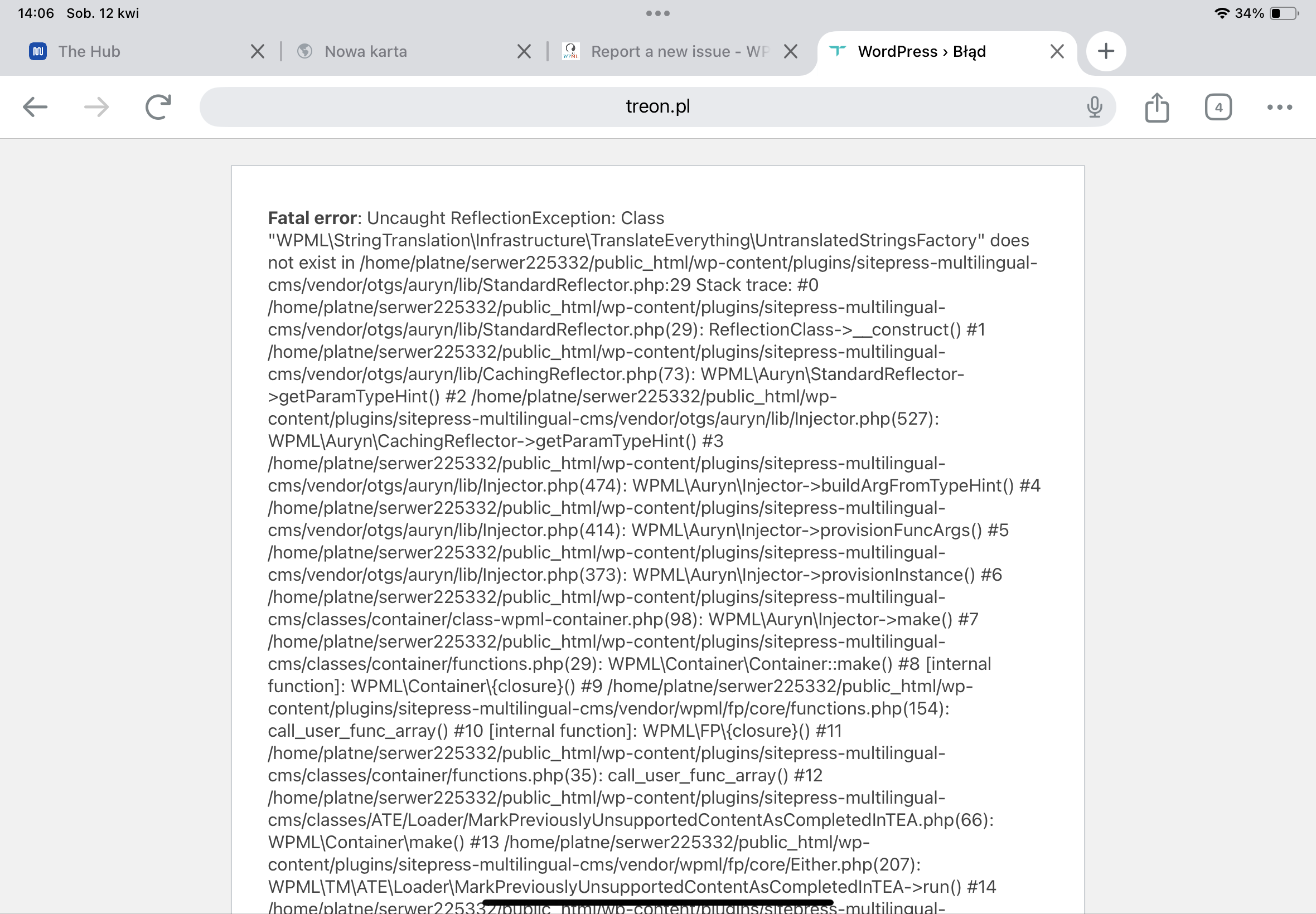

I am trying to turn on the Sitepress Multilingual plugin on my WordPress site. The issue occurred after activating the plugin. The problem can be seen at the following link: hidden link.
Error on the panel after turning on the Sitepress Multilingual plugin.
What is causing the error on the panel after activating the Sitepress Multilingual plugin?
How can I resolve the error that appears after turning on the plugin? How to fix this

It looks like that some files are missing. Please try the following steps:
1. Download the latest version of WPML from https://wpml.org/account/downloads/.
2. Disable the WPML plugins.
3. Delete the plugins (don't worry, your settings and translations are saved in the database, so they won't be lost).
4. Upload the freshly downloaded WPML plugin by going to Plugins -> Add New -> Upload Plugin.
5. Activate WPML.
Remember to back up your database before making any changes.
